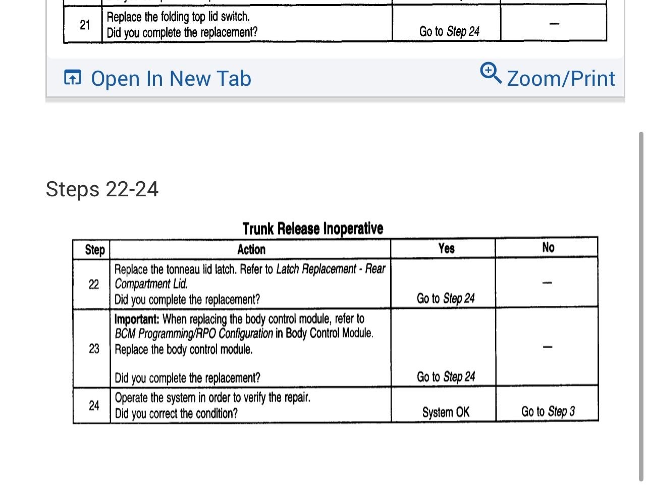

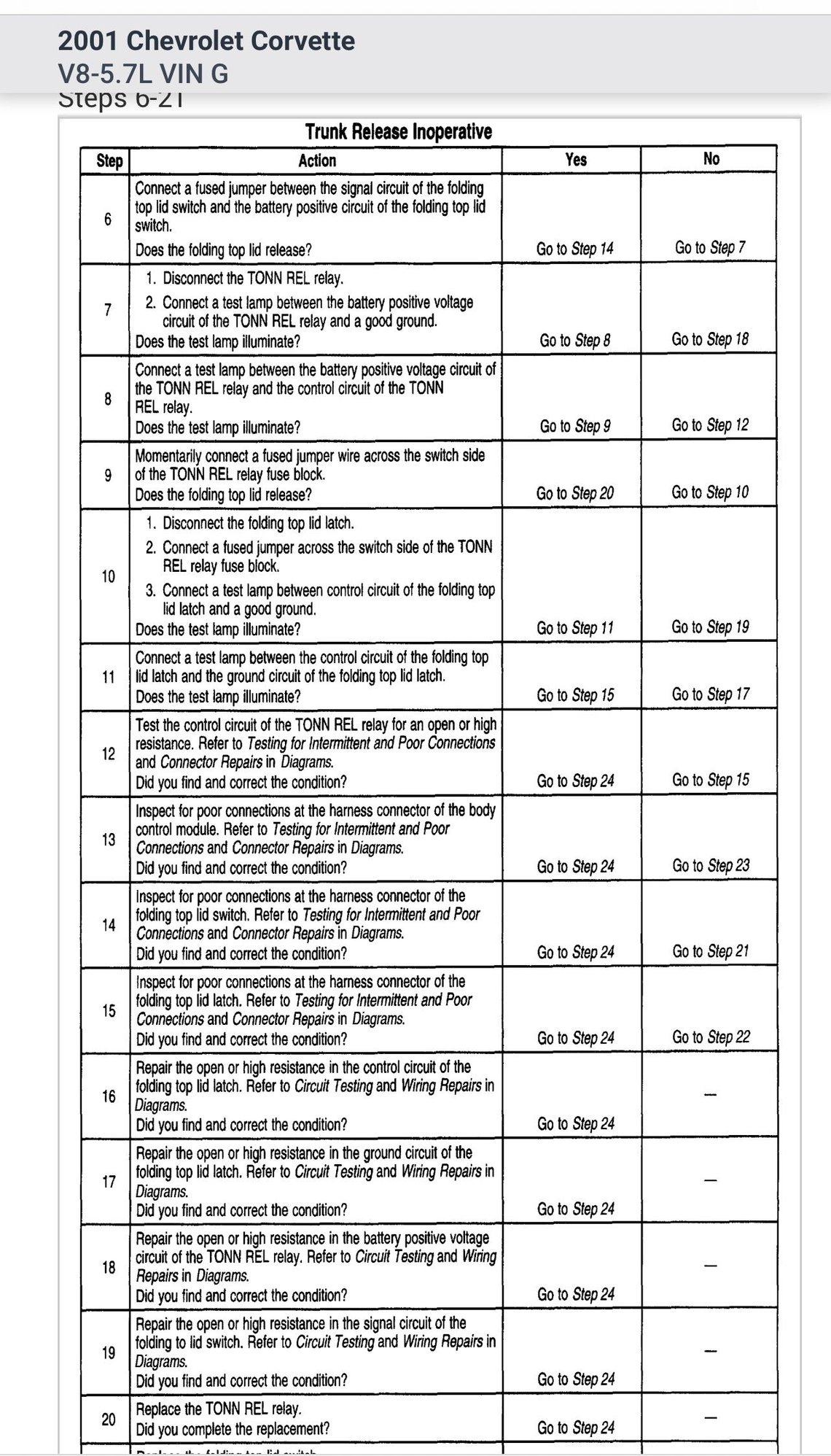

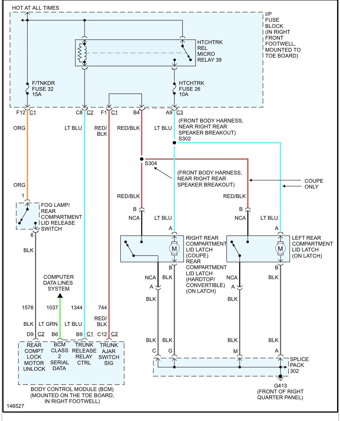

Let me know if you need help with the wiring schematic or troubleshooting procedure…helped someone maybe 6 months ago with this issue but I can’t remember what the fix was !!
