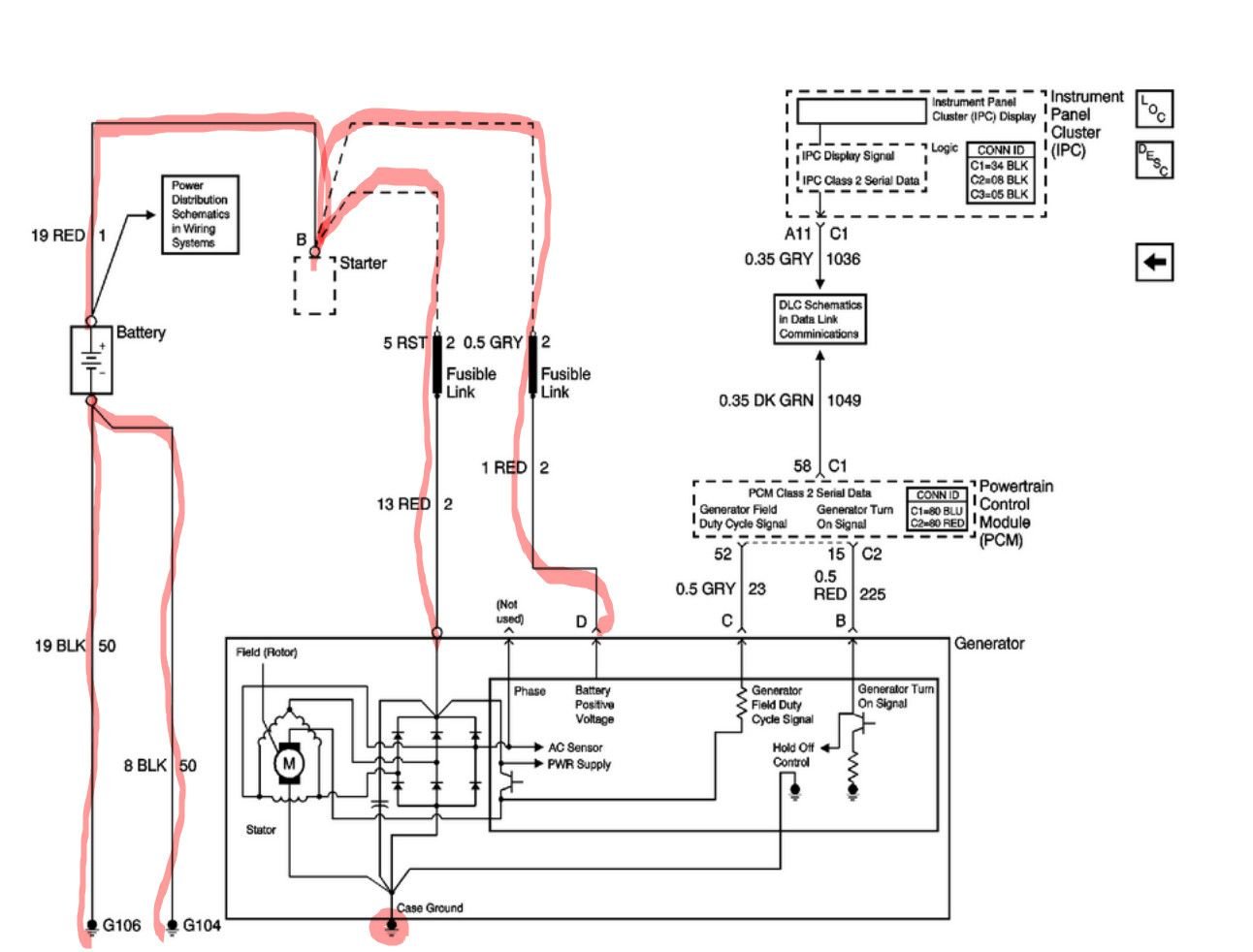

Old Oct 10, 2023 | 08:57 PM
TZNBrayden's Avatar
TZNBrayden
Joined: Aug 2023
Posts: 56
From: Salt lake city
Originally Posted by TZNBrayden
I made a post a while back, but i’m still having problems. I had a charging system fault and put in a new starter. That fixed it for a second before the charging system went out again. I went in and got my battery tested and it came back as bad so I bought a new one. I also had the alternator tested at the same time and it came back as bad so I sent my alternator in to be warrantied as i had just replaced it 4 months earlier and it was bad. I put my new alternator in and it still is having problems starting so i take it to get tested and the battery is fried. I get a new battery and they test my alternator again and the brand new installed one comes back as bad. So in the past 6 months I have been through 1 starter, 2 alternators and 2 batteries. Is this just a series of bad luck that I have or is there something more serious that is the issue? This is what my alternator test is coming back as.
I Just wanted to come back to this. I am still having issues. My battery and alternator are testing fine now, And I have done a test that has helped me figure something out. My car always showed the charge system fault, but in this test I ran a jumper cable from the positive side of my battery to the positive on the alternator, I grounded the other one on the negative on the battery and on the alternator studs on that side. When I did that the charge system fault error went away, but It heated up the jumper cables like no other. Can anyone tell me what this means or what I should do next?
Old Oct 12, 2023 | 07:07 AM
  #33
oelarse's Avatar
oelarse
Joined: Jul 2011
Posts: 996
Likes: 306
From: Southern Norway , Europe
Inspect wires and connections on these point on battery,generator and groundpoint including Case ground on generator
Old Oct 12, 2023 | 07:25 AM
  #34
lionelhutz's Avatar
lionelhutz
Joined: Apr 2007
Posts: 11,152
Likes: 890
From: South Western Ontario
Put your meter on DC volts and measure these with the car running,
Between the alternator case and the negative post of the battery. If this voltage reads more than about 0.5V then check the negative cable running from the battery to the engine block.
Between the big alternator output post to the positive post of the battery. If this voltage reads more than about 0.5V then check the big cable that goes from the positive post of the alternator to the starter solenoid and the positive battery cable going from the battery to the starter solenoid.
