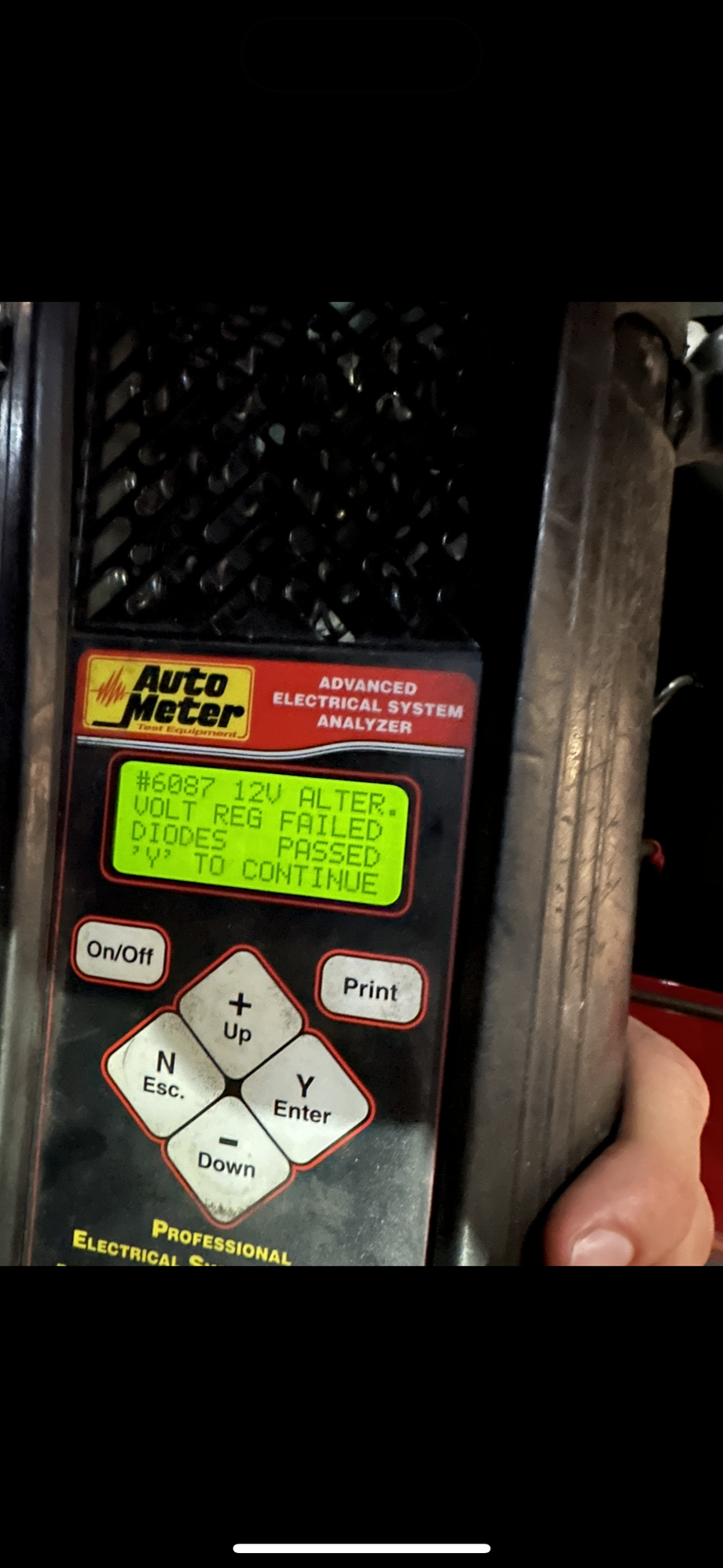

I made a post a while back, but i’m still having problems. I had a charging system fault and put in a new starter. That fixed it for a second before the charging system went out again. I went in and got my battery tested and it came back as bad so I bought a new one. I also had the alternator tested at the same time and it came back as bad so I sent my alternator in to be warrantied as i had just replaced it 4 months earlier and it was bad. I put my new alternator in and it still is having problems starting so i take it to get tested and the battery is fried. I get a new battery and they test my alternator again and the brand new installed one comes back as bad. So in the past 6 months I have been through 1 starter, 2 alternators and 2 batteries. Is this just a series of bad luck that I have or is there something more serious that is the issue? This is what my alternator test is coming back as.

the voltage jumps around. It goes from 9 to like 12 and back down. It just jumps around the first half of the voltage meter.

hey, I just took my alternators to get a rebuild and apparently they are testing just fine. Now I am completely lost on what to do, do you have any idea as to what I should do from here?

You have to use a DVM to measure across battery terminals to verify charging voltage is present should be around 13.5-14.7v approximately. You might have a fuseable link that has opened up, they are located on the cable that connects the alternator output to the battery, that connection point is on the starter, so make sure the cable connections on the starter solenoid are clean and tight.

The one thing that dirty ignition switch contacts can cause is a lower voltage reading on the dash. You should place multimeter leads on the alternator output and ground with the car running, and then read across the battery terminals. The two voltages should be almost identical and should be in the 13 to 15 volts range. This test will verify that your cars charging system is working properly.
