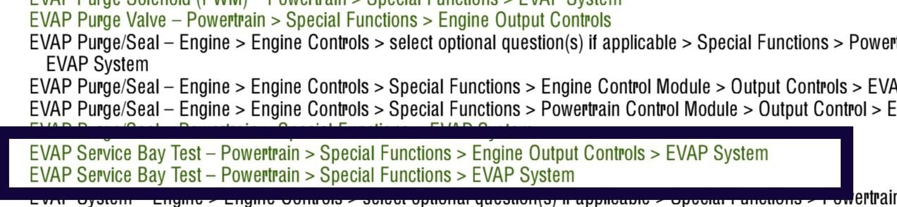

Follow this path !!
https://tech2wiki.com/content/tech2/...ech2_paths.pdf

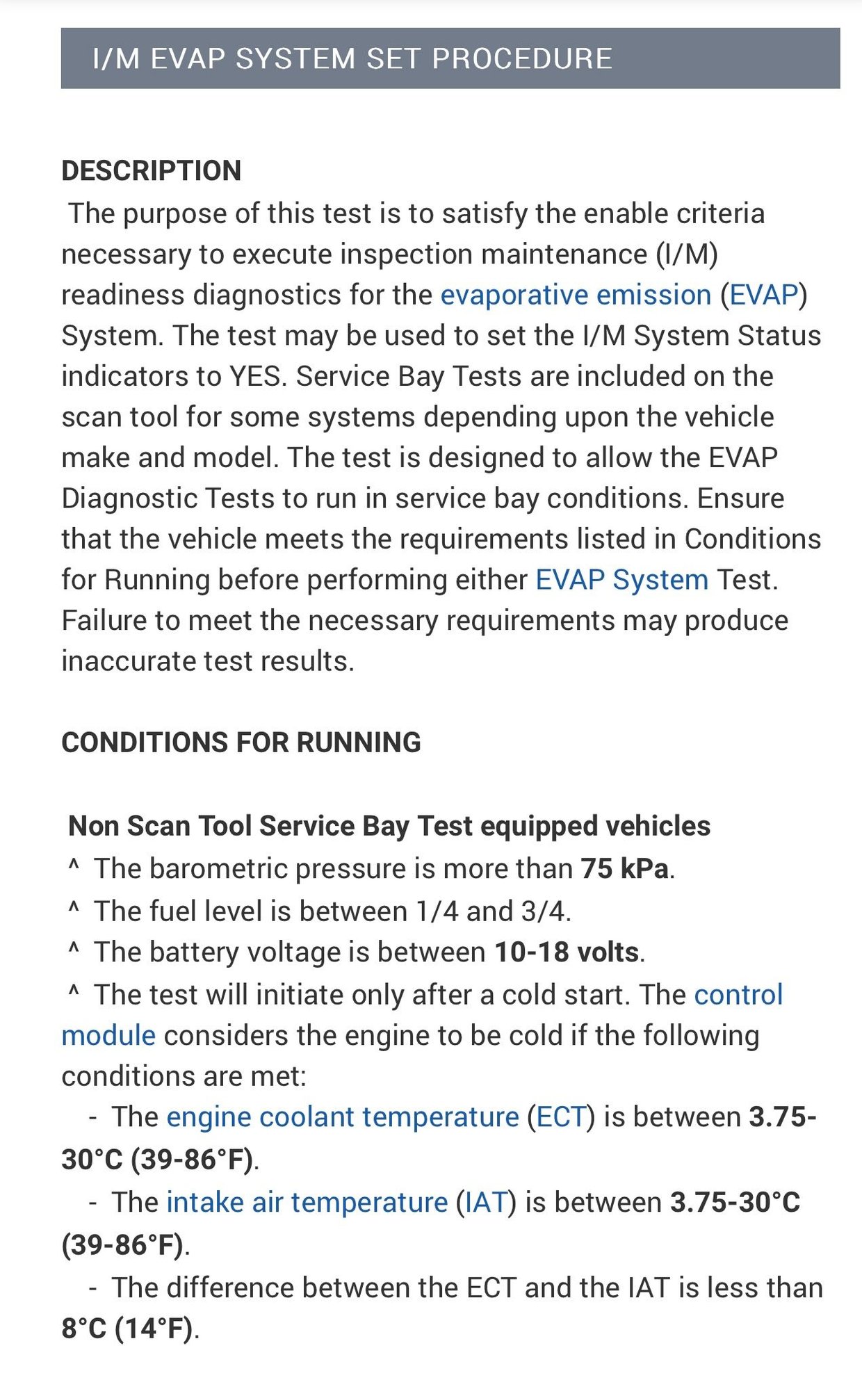

If you paid $200-300 it’s a clone…if you paid $2000-3000 it’s a real Tech 2…if you are trying to get through inspection if you follow the criteria to pass EVAP if will pass.

Very specific criteria !!…fuel level important.

And make sure you don’t have any current or pending trouble
codes that may keep the EVAP IM Monitor from running.
