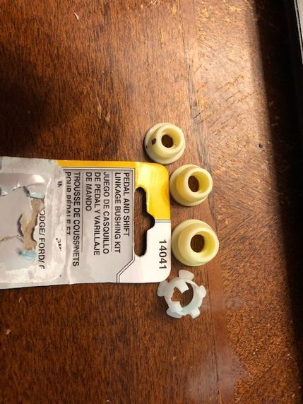

Originally Posted by yellow2007
this;;;;;Either on the transmission end or the shifter
For clarification it's the bushing with the black mark that you need

Usually the cable is fine and is just a broken bushing at one of its ends.
Even though most probably only 1 gave up, this is a call to replace bushings at both ends.
All that's needed is the
Dorman 14057 Dorman 14057
kit. Use the white bushings (the orange ones are for Ford):
And
shows how to do it.
A little dielectric grease combined with long channel-lock pliers will make things a lot easier when installing the bushings. Just get 2 pieces of cardboard or something similar and tape them over the grooves in the pliers jaws to protect things when pressing the bushings in.
This is very doable and it's just a few bucks and a couple of hours to change the bushing at both ends of the cable, taking your time

Just a tip - I cut a small hacksaw cut in my Dorman replacement thru half of OD to make it easier to press in if on the road and need to fix the tranny side only with single hand. I’ve seen some other aftermarket bushings with this cut also.
