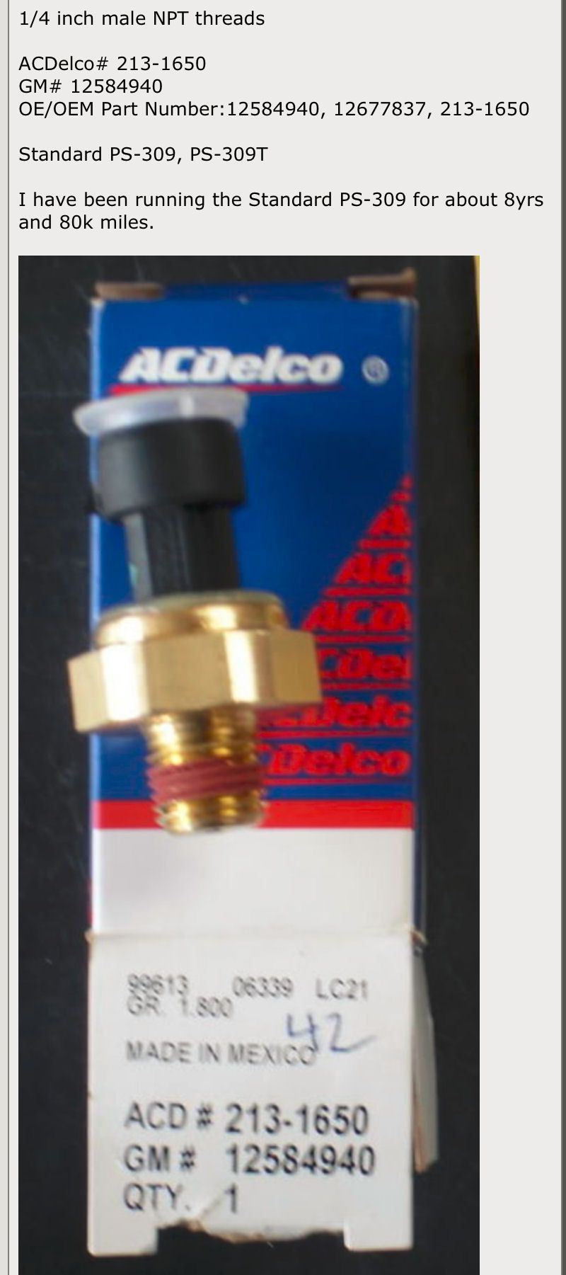

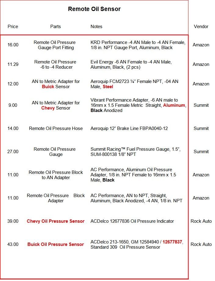

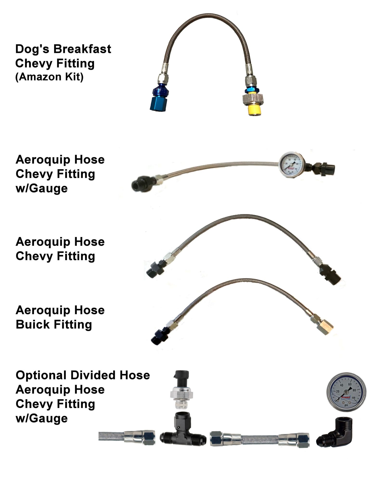

Here's the Buick model, some ideas for a remote sensor setup, and some parts sources. Note that the Buick sensor has a different thread pattern than the Chevy sensor.
The thread in the engine block is 16mm x 1.5. The fitting for the block in the chart below, converts to -8 AN to connect from there on.
This top picture is from another CF member...

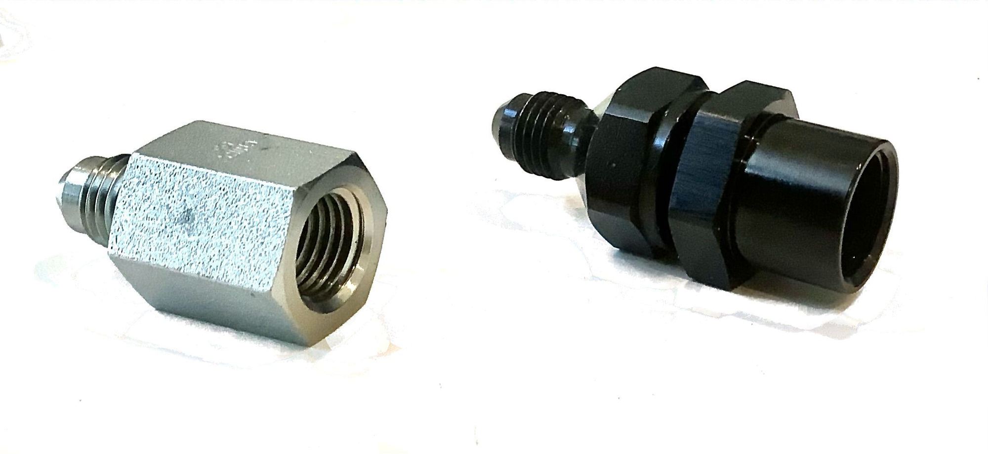

I pieced together my own oil pressure relocator using
this adaptor this adaptor
at the sensor end, https://www.summitracing.com/parts/atm-2268 at the block end, https://www.summitracing.com/parts/ear-64151518erl between, and am using the Buick sensor. I've had to replace the sensor twice because I somehow got water into it both times while cleaning the engine - my own fault of course. Now that I have it tucked in underneath the coil covers, it is protected from water from a light cleaning. if I go OCD on the cleaning, I unplug it and put it in a rubber glove to protect the sensor.

Over a decade on this without a failure on mulitple cars. One has had it nearly 20 years and is tracked at over 100k miles.
NAPA buick sensor. We run a 45 degree connector to the AN line off the block. Ours looks like Doug's but we get the parts from NAPA and Summit.

Just ask them to cross reference ACDelco 213-1650, or GM 12584940
