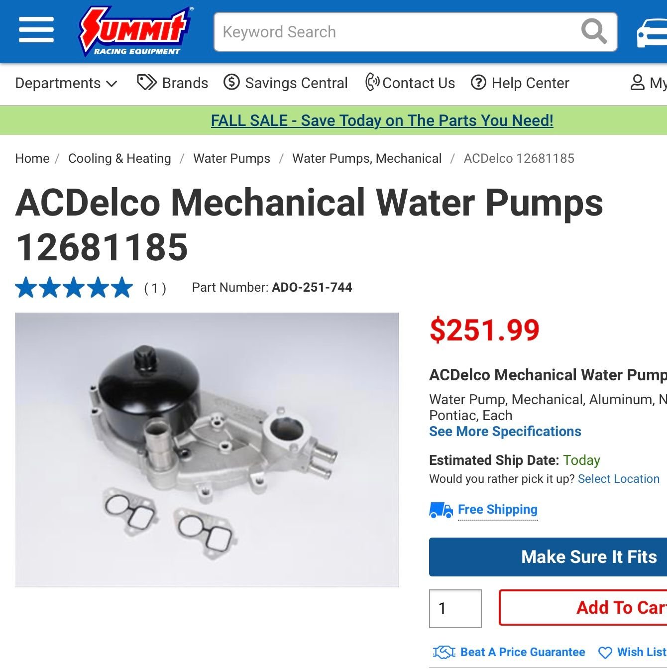

Are you filling the reservoir all the way to the top?
Is your harmonic balancer wobbling? Is your belt tensioner operating correctly? If the water pump’s drive pulley is vibrating, the pulley bearings will wear and eventually fail. This reduces pump efficiency before eventually causing failure.
These are questions you can respond to. Also take some pictures and a movie of the balancer with the engine running.
If indeed it’s just a bad pump read on…
This water pump is easy to change. If you have basic hand tools you can do it yourself in an hour or two. Make sure to use new hose clamps.
Heres a couple videos, and there’s plenty more on YouTube
Lots of folks buy knock off pumps and are happy. A water pump is not where I cut corners. This is the genuine article, GM’s OEM replacement. Not from China…. Mine came direct from Detroit.
https://www.summitracing.com/parts/ADO-251-744

Its why I suggested an external source. Have checked the pulley for good bearing and that tension is working properly? Just trying to cover bases that might be working on the seal. Have you watched the balancer for any wiggle, and is the ring still lined up. Something would need to be out of alignment or creating drag, like a bad pulley.

I agree with @vette4fl regarding using a premium WP like ACDelco. I have a '99 and just replaced mine last week due to some leaking issues and like you I had no leaks prior to parking her and letting her sit for 2 months due to other repairs I am working on which are unrelated to the WP. The pump that I pulled off was an aftermarket and I have no idea what brand it was because the PO replaced it. I am the second owner and unfortunately the PO kept no records (as he said) of any repairs. The one thing I did notice on the 2 pumps was the back plate. The one which came off the vehicle had a screwed on back plate (area of the leaks) and the ACDelco 252-846 was pressed on. So far no leaks and she is a DD. The PN mentioned above ADO 251-744 with the OEM 12681185 I am familiar with because it is one of the types that is cross referenced with my 252-846. GM also had a practice of installing whatever pump was on the shelf so that could be the answer why the OEM number is different from yours to mine. My OEM is 89018034 and it has a cross reference of with the following

As you can see your '98 is included with my '99 so therefore it should work. Again the problem with mine was the screwed on back plate. Hope you get yours figured out and good luck. Subscribed to keep posted. Cheers!!!

Here is another detail for you to consider regarding your pump. The 252-846 is a counter -clockwise rotation whereas the 251-744 has a clockwise rotation. Therefore, if that is true according to the specs for each of them then I would think if the pumps are rotating incorrectly their seals may be getting damaged and causing the leaks. BTW your does turn counter clockwise. Cheers!!!

Yeah, that’s weird. And both part numbers correspond with the ‘98. Only other thing is the 252-846 is the “Gold” aftermarket version, whereas the 251-744 is the “OEM”.
Due to a casting number that was different from the current part number on the 744, I spoke directly with the tech team at ACDelco in Detroit. They confirmed the 251-744 is the correct pump for my ‘04. I had no reason to ask about 252-846 reverse impeller China junk.
