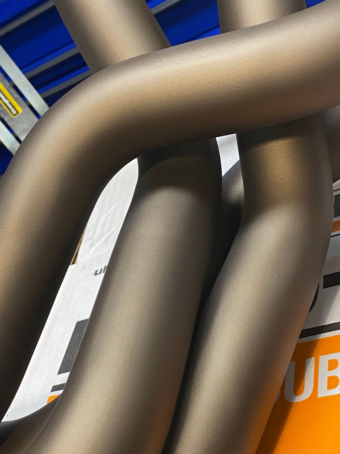

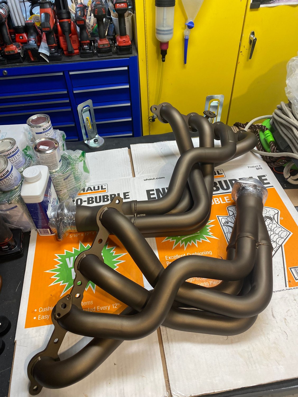

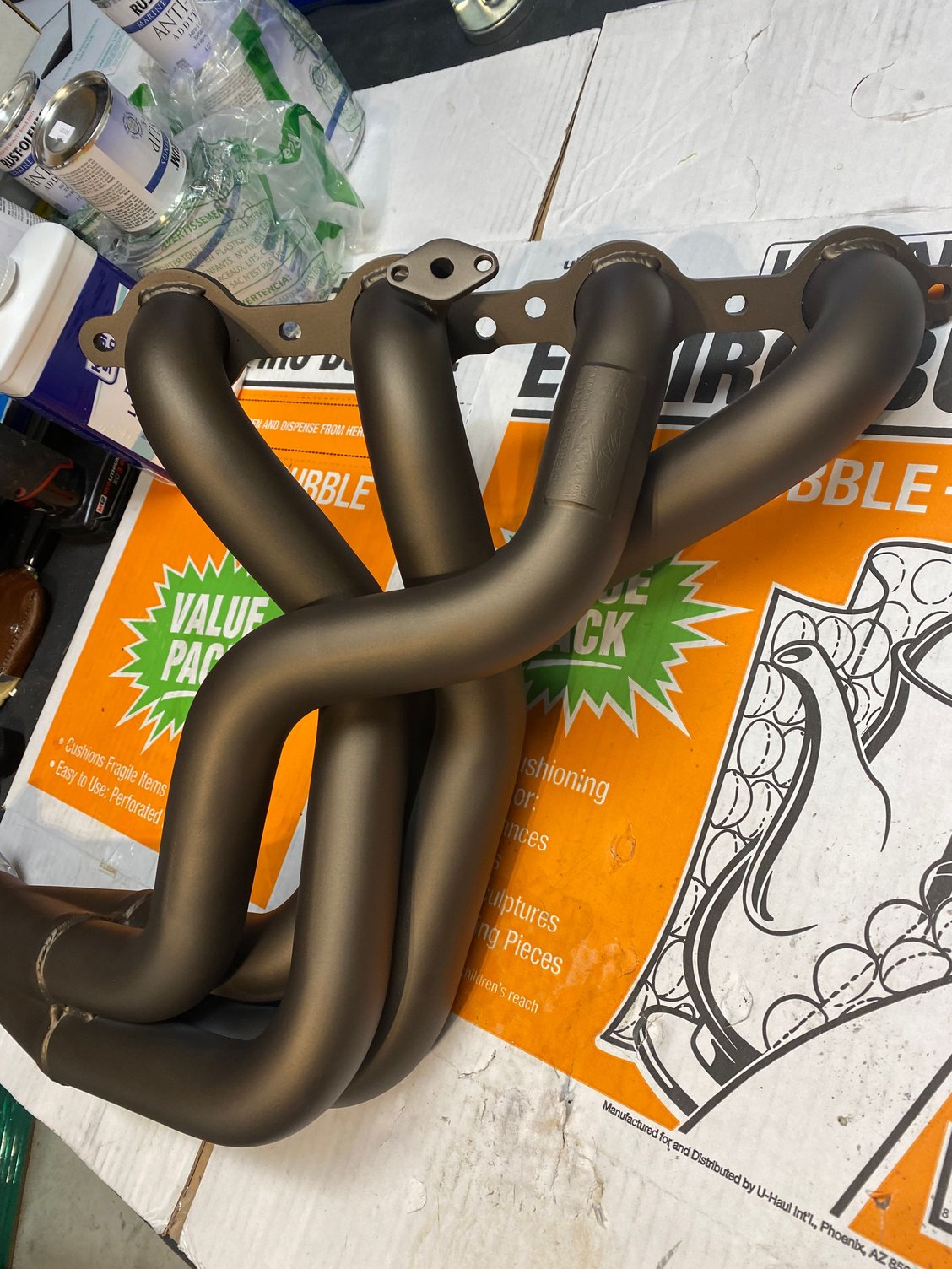

Now I know it’s not the muffler’s but I had JetHot ceramic coat my stainless ARH Headers and love the quality. They will give you a quote with supplied dimensions and pics. Plus you pack up your stuff to ship and they will give you a shipping label which gets you a much cheaper rate on shipping than doing it yourself.
I did my headers only and may end up getting the rest of my system done as I haven’t installed it yet.
Jet-Hot calls this color Aged Bronze

Seriously though, thanks for sharing. Your results may be the best looking set of headers I’ve seen. I’ve had Jet-Hot coat headers on a full faired motorcycle, and the temperature reduction was astonishing.
