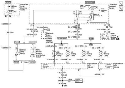

All I have are Manual C5/C6 Vettes. I know for a fact that that switch is located ON the passengers side of the transmission on NM6/NM12 transmissions. The schematic provided states its located in the PNS Switch on pins C1 and C (I cany make out the number) . There are two connectors on the PNS Switch. One could be for that function.

Examine the two connectors on the PNS Switch. The reverse lamp wires are Grey and Brown. If you jumper those together, the reverse lights should come on (key in ON)
They will be on connector C1 on pins C and (i believe ) pin F. The schematic that Im looking at is a little bit blury.

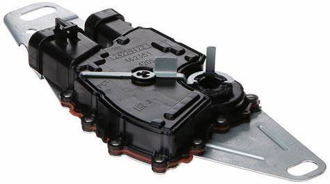

The Manual Reverse switch looks like a temperature sensor and it has a small ball bearing in the end that screws into the manual transmission housing. If you depress the ball bearing, it completes the circuit inside the switch part of the sensor.
The A4 PNS Switch is located on the drivers side of the trans and the shift cable connects to it. Its a bolt on black plastic module about the size of a pack of cigarettes with two connectors. .

PNS SWITCH PIC:

SO, According to the pictures that I provided, what part do you have in hand???

Bill did a great job detailing which one you need in the pics. You need the PNS switch in the pic Bill posted in post #8. The black plastic one. $18 for a PNS switch tells me you either bought the threaded one that screws into the trans, or you got a mighty cheap Chinesium PNS switch. Best of luck to you.....

I have the manual trans switch. If anyone wants it I’d be happy to send it. Looks like I will need the PNS switch. More diligent work on my part before selecting a part.. lessons learned. Your reply told me what I need to do. Thanks
