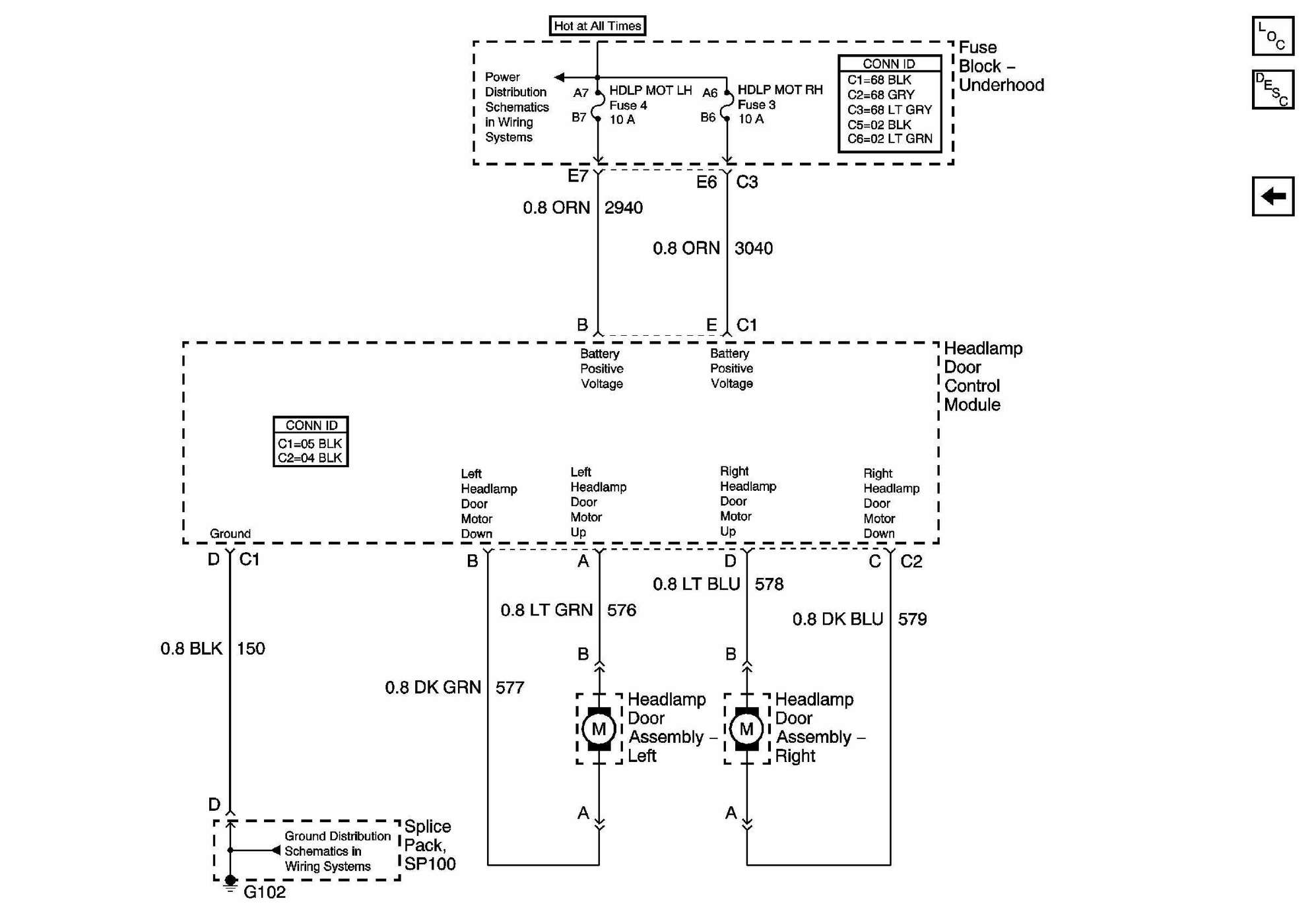

According to the schematic, it should be fuse #3 & #4
Just look at the Fuse lay out legend on the fuse box lid and look for HDLP MOT LH & HDLP MOT RH. Those will be the fuses you need

All good, you got me in the ballpark. When I saw Bill's post, I was under the hood checking out what you told me. I saw the fuses were 3 and 4 and his message confirmed what my schematic said. So it's all good....you all have been so helpful here. Thank you so much!!
