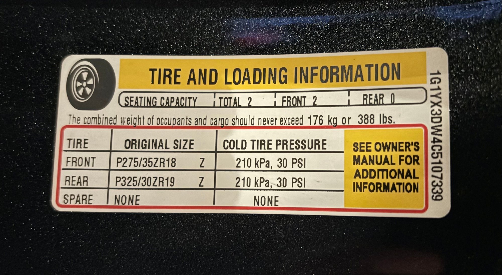

I recently noticed the 388 lb weight limit capacity…
Old Dec 12, 2023 | 07:47 PM
grinder11's Avatar
grinder11
Posts: 12,860
Likes: 4,661
That 388lb figure may be the most frequently violated spec in Corvette history!!
Not to pick your post apart, but that label is NOT from a C5. No C5 came with 275/18s front or 325/19s on the rear. Info may, or may not, be the same.......

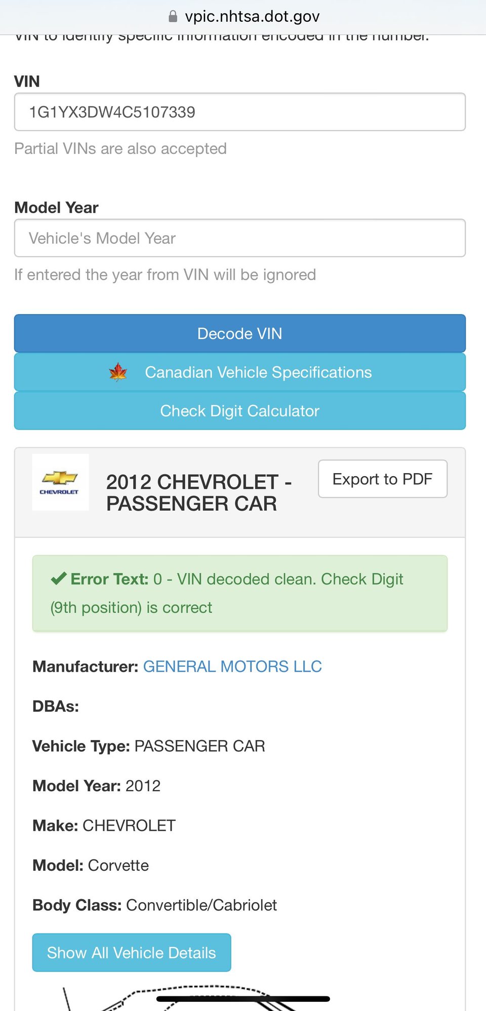

I was curious so I looked up the VIN on the sticker. That sticker is from a 2012.
