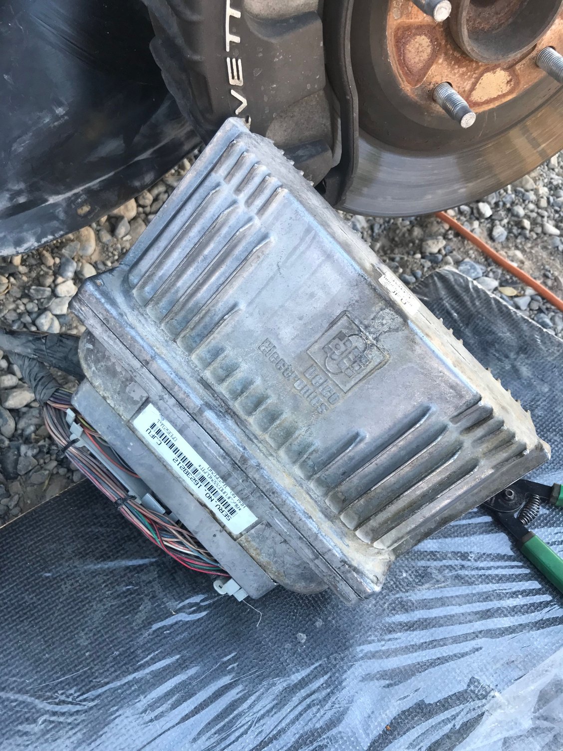

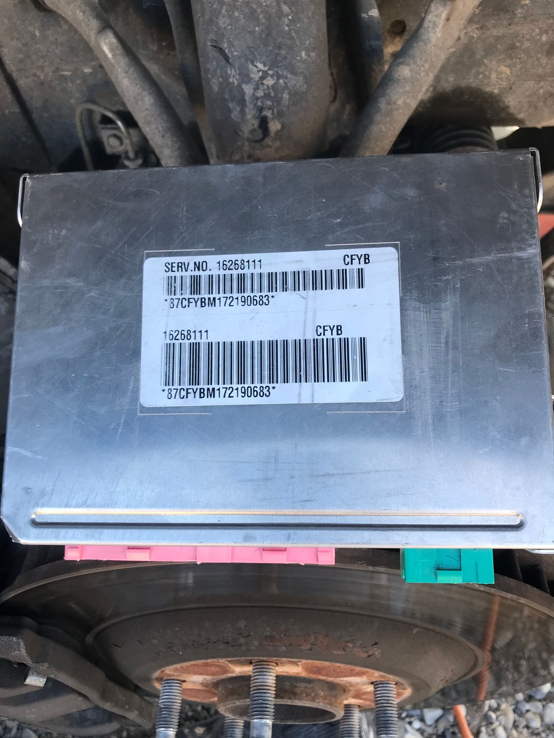

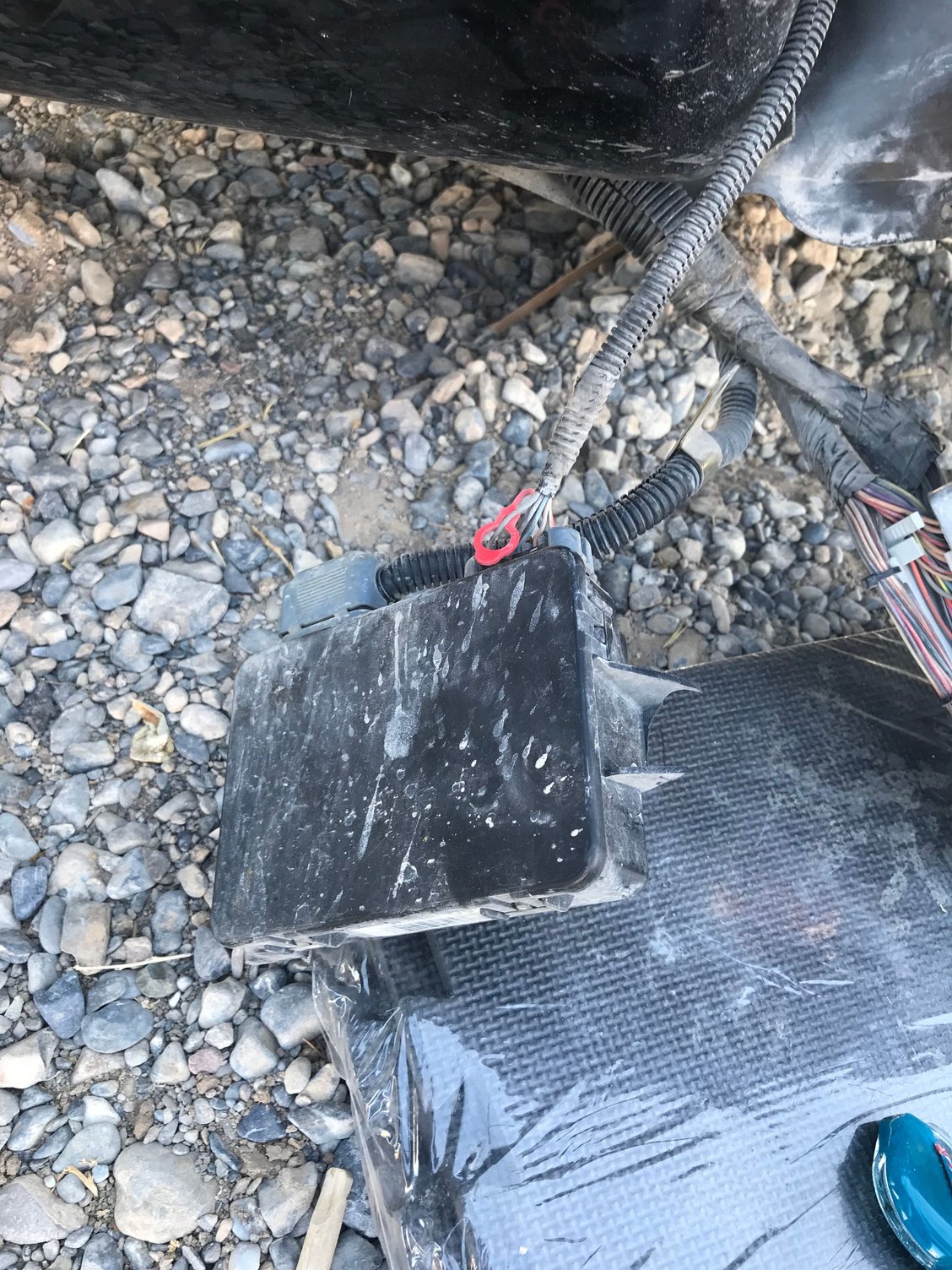

So I’ve removed these items pictured below. So is there anywhere I can take these to get tested
Passenger floorboard
Under battery tray
Under battery tray

You have to send those items to a business that specialize in testing and repairing automotive electronic modules, one of them is ABS fixer, or G7 Computers. Contact them and ship them your modules, they will test and repair if needed.

can you calamity what unit is what. I’ll attach pictures. The book I have on this vehicle calls the ECM the (engine control module) the unit underneath the battery tray And the PCM (power train control module(the unit underneath the passenger side floorboard. But In this forum People are calling it PCM/BCM.
Also I hear a click almost sounding like a broken hard drive when I turn the key inside the box on passenger floorboard.
Underneath battery tray

The ECM or PCM is located under the battery tray along with the TAC module. The BCM "body control module" is the module in the passenger footwell area, either module can fail and cause the no comms issue, have you removed the connectors on the PCM and inspected the pins and sockets for corrosion? The click you hear is probably the TDR which sits on top of the BCM, it sends power to energize the starter. I don't like how the PCM looks, it maybe the cause of your problems.
