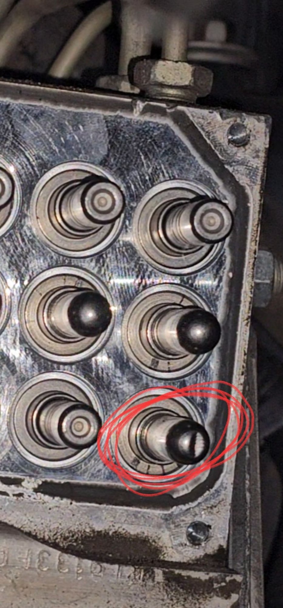

Guys, FML.
Few days ago my ABS and Active Handling service light came on so I checked and cleaned the 101 and 108 grounds and didn't fix the errors, then did the nightmarish EBCM removal, opened and resoldrered a few connections that seemed need to be resoldered, put the EBCM back on the car and reseted the errors, tried to move and the brakes are STUCK, OMFG, I disconnected the EBCM still same issue, even took it off fully still the same issue, took out ABS fuses and still stuck, can someone help? Can't think of anything else and can't find help online.

I had a ecbm problem and still yet to test the fix on track to see if it works. Dash lite is at least good. Anyway, I just got my ebcm back from absfixer. he has the gear to test and fix the ebcm. The solder trick might work but I think there is more to it? For about 250 fixer added a electric surge thing to my ebcm and found 13 hard codes and a bad relay. I don't think that would have been solved just by refreshing solder joints. Anyway that's my data point. I think ABSFixer is good service and good value.
People say with no ebcm you got stock brakes just not abs like the 1970's. They say you can drive the car around but the pointy things in the abs are sticking out exposed. I have no idea if that is bad to get road dirt in there so I did not even start my car once I got the ebcm out it went right to fixer.

The POINTY THING on the Brale Pressure Modulator Valve "BPMV" are spool valves. Some are OPEN and Shut when they are actuated ENERGIZED by the electro magnet in the Electronic Brake Pressure Module (EBPM) The other ones are SHUT and open when commanded open.
I have to agree with JIM993. Sounds like one of the spool valves is stuck in a position that it should not be in. Locking pressure in the calipers.
YEP, Try venting the calipers and see if it frees up the wheels. If its not a brake pressure issue, it could be a Transmission issue. If it were me, I would put the transmission in N and jack a wheel in the front and back and see if you can rotate a wheel/s.
I tried that, it did release the pressure and the wheel started turning, but as soona s I started the car same thing. And it's only two front wheels. If its the ebcm, if I disconnect EBCM this issue should go away right? I disconnected took the the fuses off and released pressure again but same thing 🤦‍♂️

I would remove the ECBM and relive pressure. I think the ECBM needs repair. If the front locks up with the ECBM removed then the BPMV may also be faulty.

Just disconnect the big connector on the EBTCM, vent the calipers and see it it stays free when you turn the ignition on.. For the calipers to clamp, you either had to:
1 Depress the brake
2. The BPMV motor had to run to build pressure in the system. With the module disconnected, the motor cant run and the spool valves can not actuate.
If you depress the brake and release it, the front wheels SHOULD lock up when brake depressed and roll free when the pedal is released. If they remain locked up after release, there is a problem in the hydraulic system.

Posts: 10
My dumb *** damaged the BPMV while I was taking out the ECBM, gonna change that soon

I did not touch those things when I took my EBCM off. Somehow you dented the dome or bent one of the posts? ABSFixer has those parts for sale. They aren't cheap but I bet they work. I did not realize how screwed up my car was until fixer fixed my EBCM. My brakes actually work like brakes.
i already bought new pump, got a deal just 400$ fml. But glad to hear your situation was resolved
ok so it's fixed, here is what I did. Yes I damaged the brake pump pulling out the ABS module, bought one for under 500, replaced it, bled the brake system carefully (rr rl rf lf) made sure all the air is out, everything is working after 150miles driving no errors 🥹 thanks everyone for trying to help
