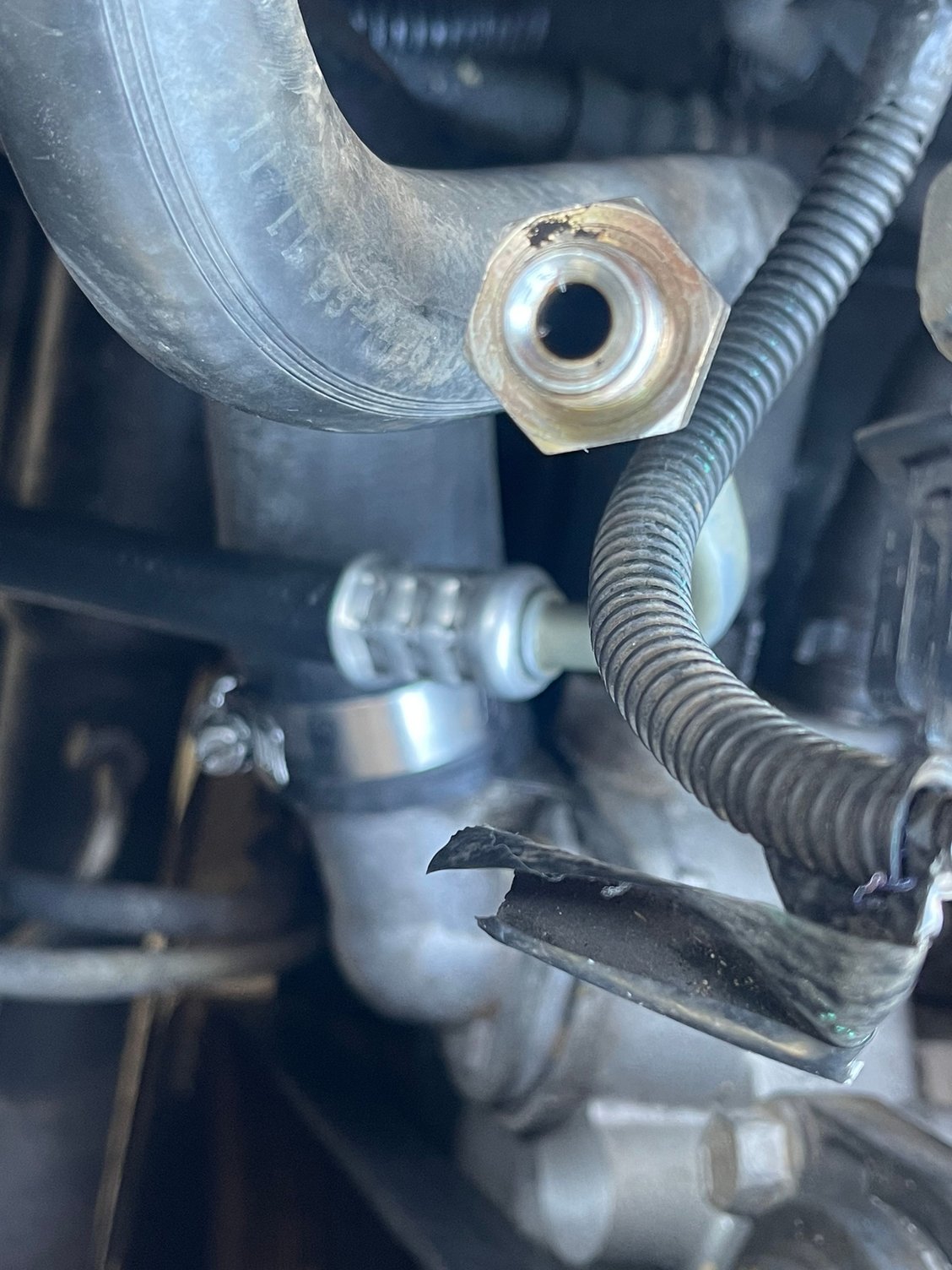

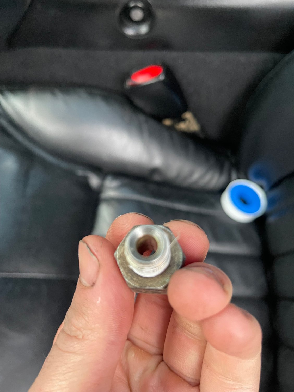

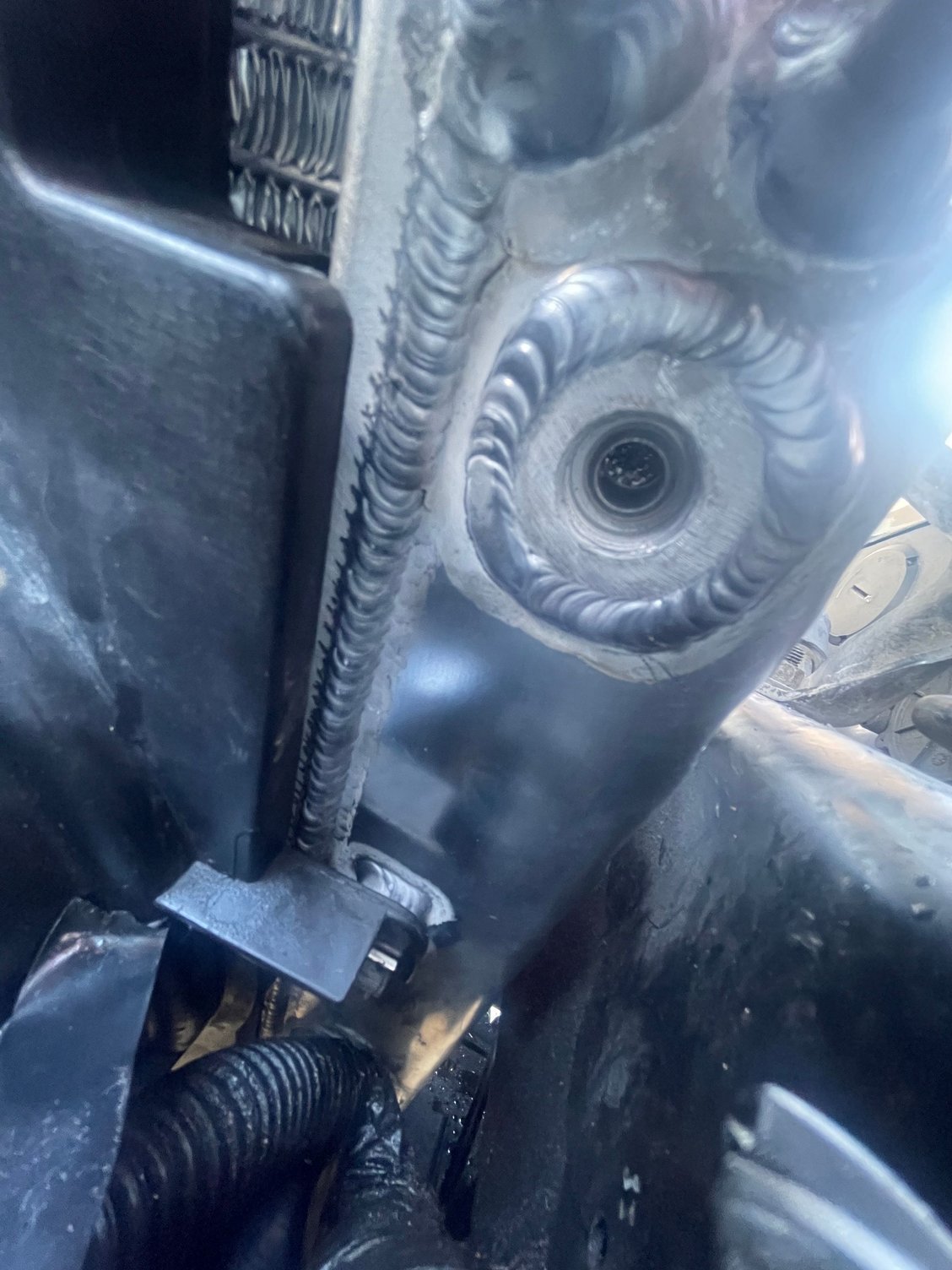

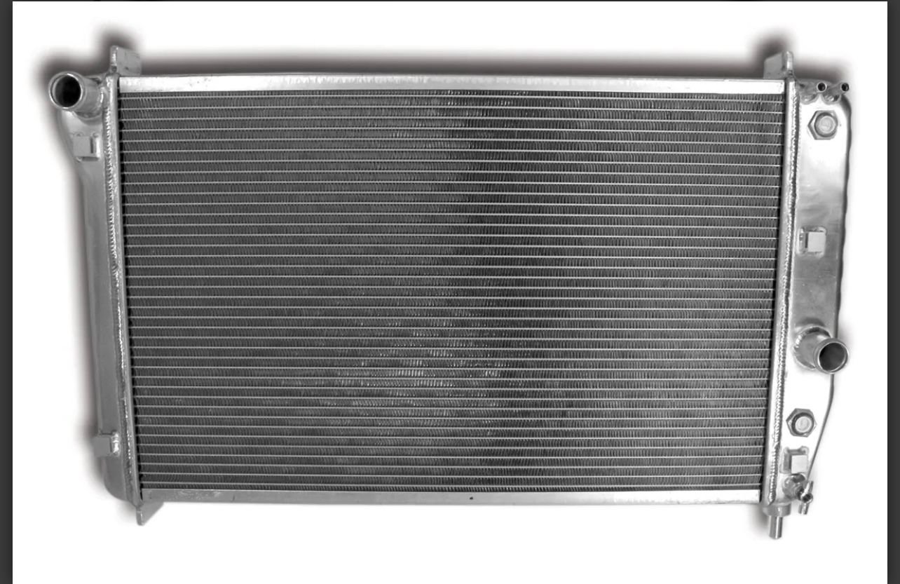

Decided to go with a dewitts radiator after doing my research alot of people recommend it.. i recently got my hands on it and installed it myself but my transmission lines wouldnt screw into the rad . Ive been looking thru the forum but cant find someone with the exact same problem as me, neither on youtube lol most videos on installing a dewitts rad have a manual vette. I got a 2000 automatic what exact fitting do i need
old radiator^
New radiator^

Your existing fittings are supposed to be 5/8-18 flare, or perhaps reverse flare - I get the nomenclature confused. I will bet money that if you give DeWitt a quick call they can tell you the exact fittings in the radiator quicker than others here can reply.
That said, it’s hard to imagine a “Direct Fit” radiator has fittings different from the OEM.

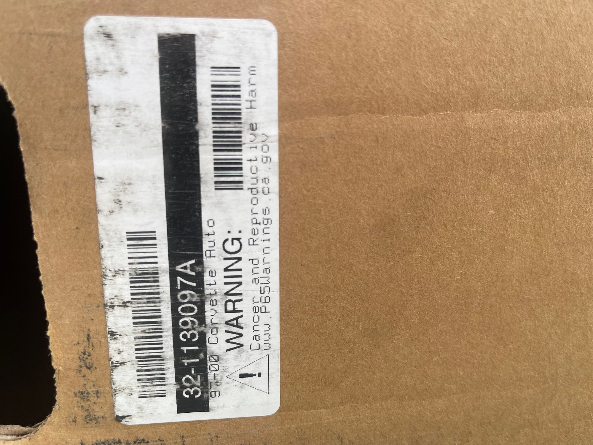

Im starting to think that maybe they sent me the wrong radiator ??
This is the one i received part number ordered #32-1139097A

They sent you the wrong one. Does the part number on the box or on the radiator match your order?
yes it does match, i wonder if anyone out here in the forum has installed this exact same rad on their 97-00 auto vette

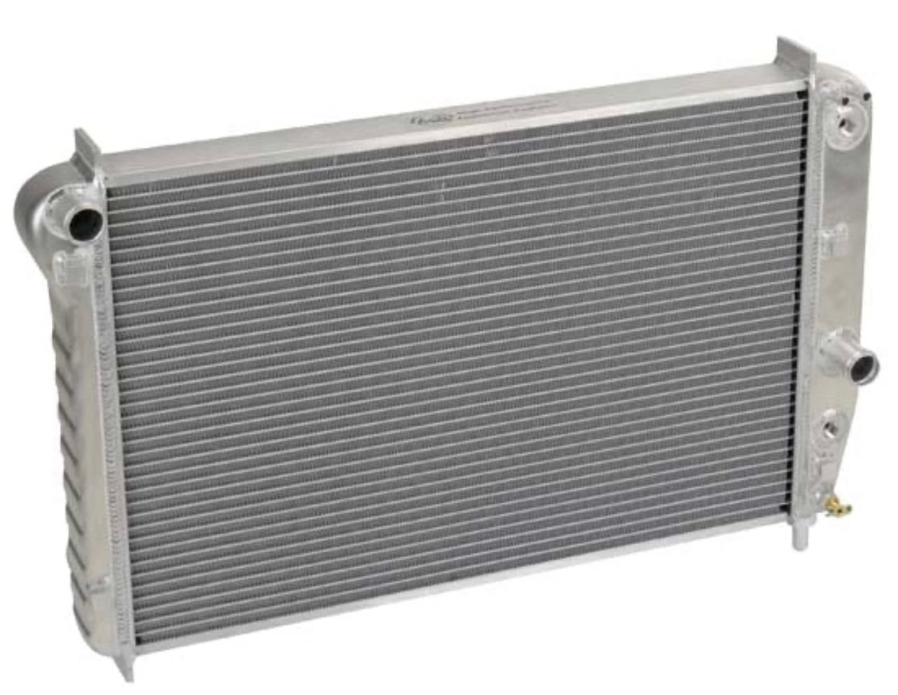

Did you send them these pictures? The bungs match the later model radiator you posted a pic of (32-1139101A)
i will be going to tomorrow, yea the top radiator seems to be the right one to me

I don't know the part number of mine, but I have the cut down one for the 01-04 Auto as my car is supercharged.
These screen grabs were taken from Dewitt's website. Seems like you need the other one possibly or change out the oil lines. Or buy an adapter -
