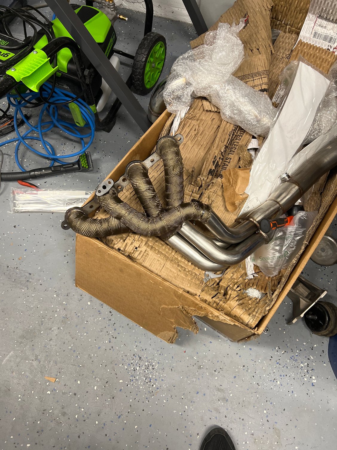

Guys I have done freaking everything the online videos and guides say to do for the drivers side header. I have the drivers side mount complete removed, the 4 subframe bolts loosened and the passenger side mount loosened, I have the drivers side of the engine jacked up till it starts lifting the damn car. I have the steering column out of the way, the fuel lines, oil filter and oil filter sensor and it STILL won’t go in! I’m pulling hair out here. If I could just pay someone to save me I already would but I doubt that even a thing. Here are some pics.
I have seen a bunch of guys do it easily from the bottom and if that’s what absolutely must be done than I guess I can buy taller jack stands or put the jack stands on 2x6 but that seems so sketchy.

Is there something welded to the end of the collector?
Most header installs are just the header up to the collector. If there is a cat welded to the collector you may need a lift to get the angle to get the header in...

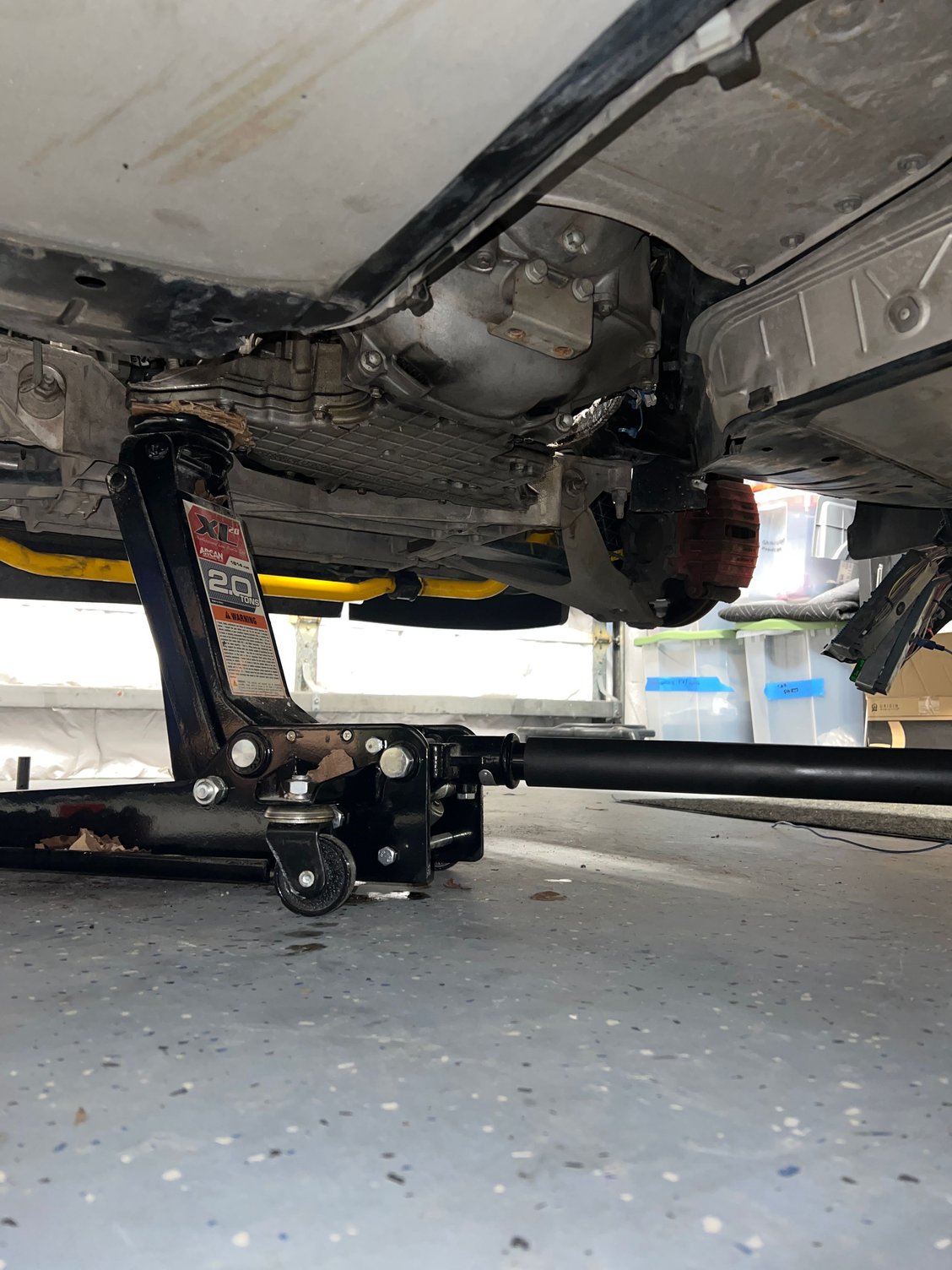

"OP", if picture #2, of the group of shots you posted, is how you're actually attacking this project, I think the jack's location is part of the problem. If it's still in that position, I suggest you re-position it so that it's coming in from the front of the car....

I'm not trying to be annoying, but let me ask again, do you still have the jack in the same location that your first pictures illustrated? You DO need an unobstructed path, in order to swing and wiggle the headers into place, and to me, that jack is right, square in the way.....
just sayin.

no I tried both with the mounts loose and the jack pushing up the motor and no jack. The jack is pretty much in the way regardless of where i put it hehe. LG does not say it’s required to loosen mounts and raise the motor. Worst case I will borrow a friend’s cherry picker and see if I can raise it up that way. Hopefully it was a matter of the car simply not being high enough.

2 questions in my mind. Are the headers brand new? Just possibly they are just a bit out of whack when made at factory. **** happens.
Have you tried tech support at LG for some assistance? Good luck and be careful under there.
