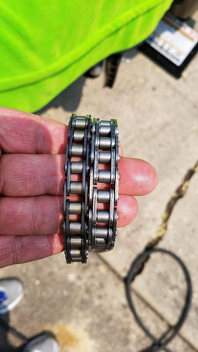

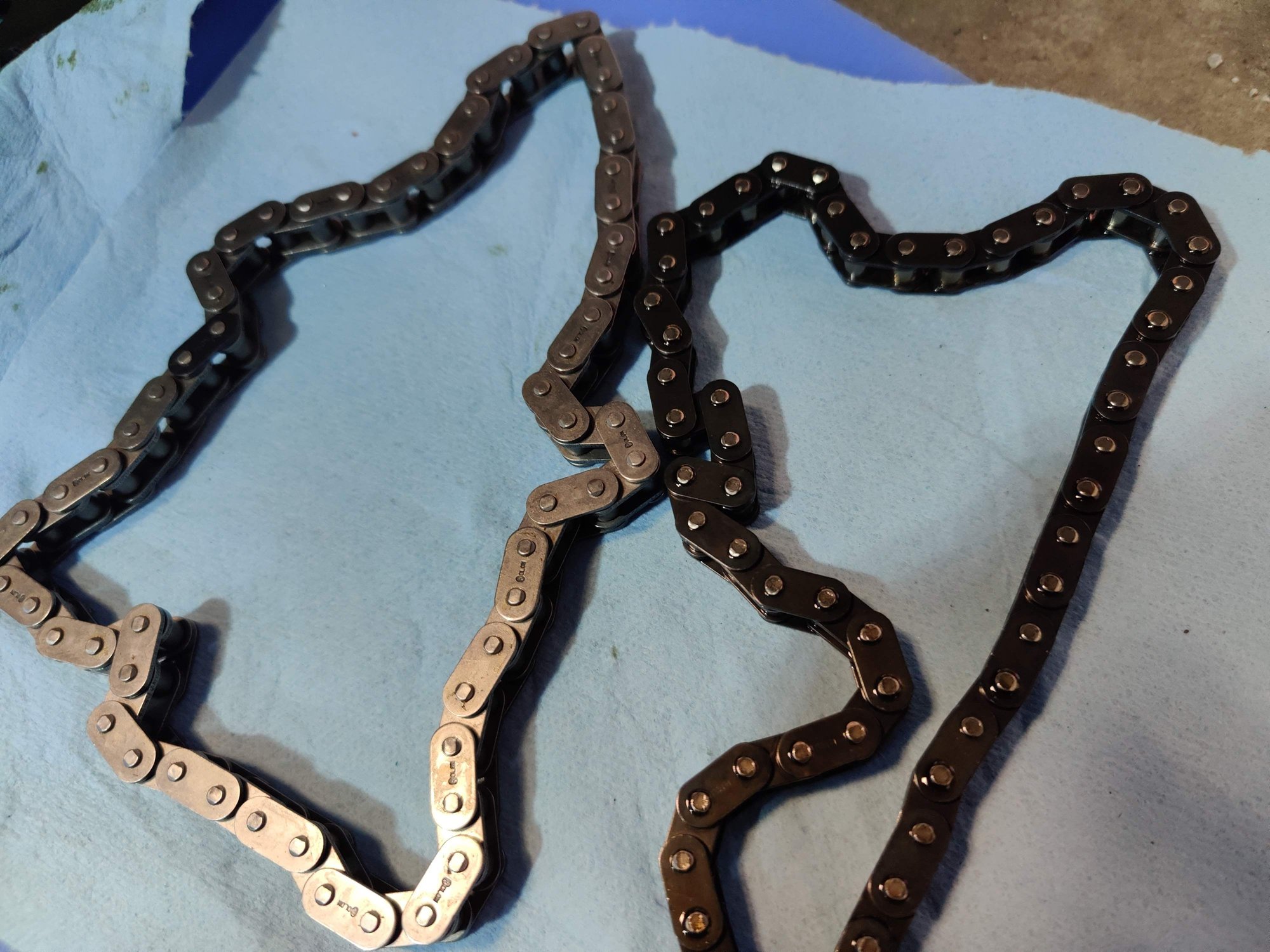

Old Mar 10, 2024 | 10:35 PM
Prop Joe's Avatar
Prop Joe
Joined: Feb 2022
Posts: 895
Likes: 986
From: NW Burbs of Chi-Town
I used the $81 standard pressure and volume Summit pump on mine 8500 miles ago. If you look at the pictures on the Summit site it has the Melling 295 casting number on it. They gotta purchase it from someone...
So far so good. Oil temp 216°F, 1950 rpm and 42 psi cruising back from the airport this evening. I've never seen anything lower than 30 psi.
YMMV
Edit: Summit LS2 chains are $30 (were $18 last year).
LS2 on the right
LS2 on the right
Will that LS2 chain fit without rubbing on the block? Those plates look a lot thicker.

I have been following this thread. Watch the Melling video, around 8:20 they mention the use of countersunk fasteners on the cover to allow for the use of a double roller timing chain which I imagine is ever wider than an LS2 chain.
LS2 on the right
I use the Summit brand LS2 chain on mine too. My stock LS6 with a ported stock oil pump and $30 chain runs to 7400rpm without issue. I also have a DRM race oil cooler. I would just get a stock Melling replacement and use the high pressure spring if you want. No need for extra volume.
