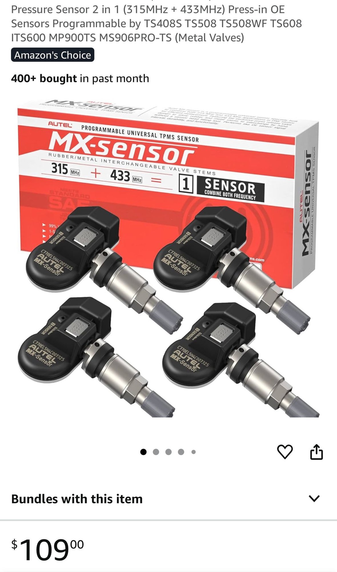

Are the Autel sensors any good?
I picked up a programmer and the rubber stem valve kit for a decent price during black Friday. I used the tool to check the battery life on my 4runner and programmed some sensors on my wife's lexus. Would these metal stem sensors be OK for the C5 since I have the tool?
from reading the thread not to many comments above yours this brand is about the worse one you can get. They only last a few years.
