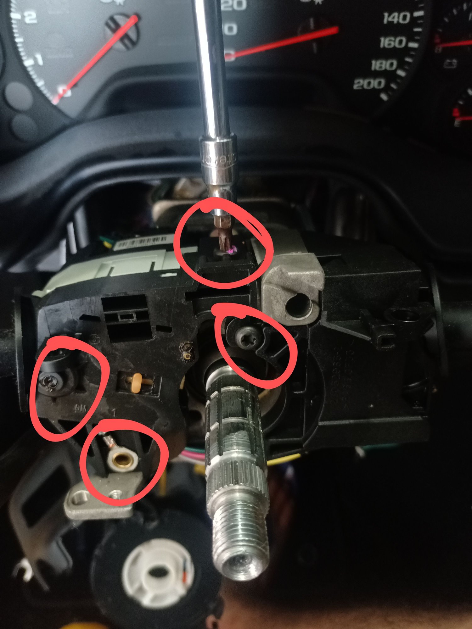

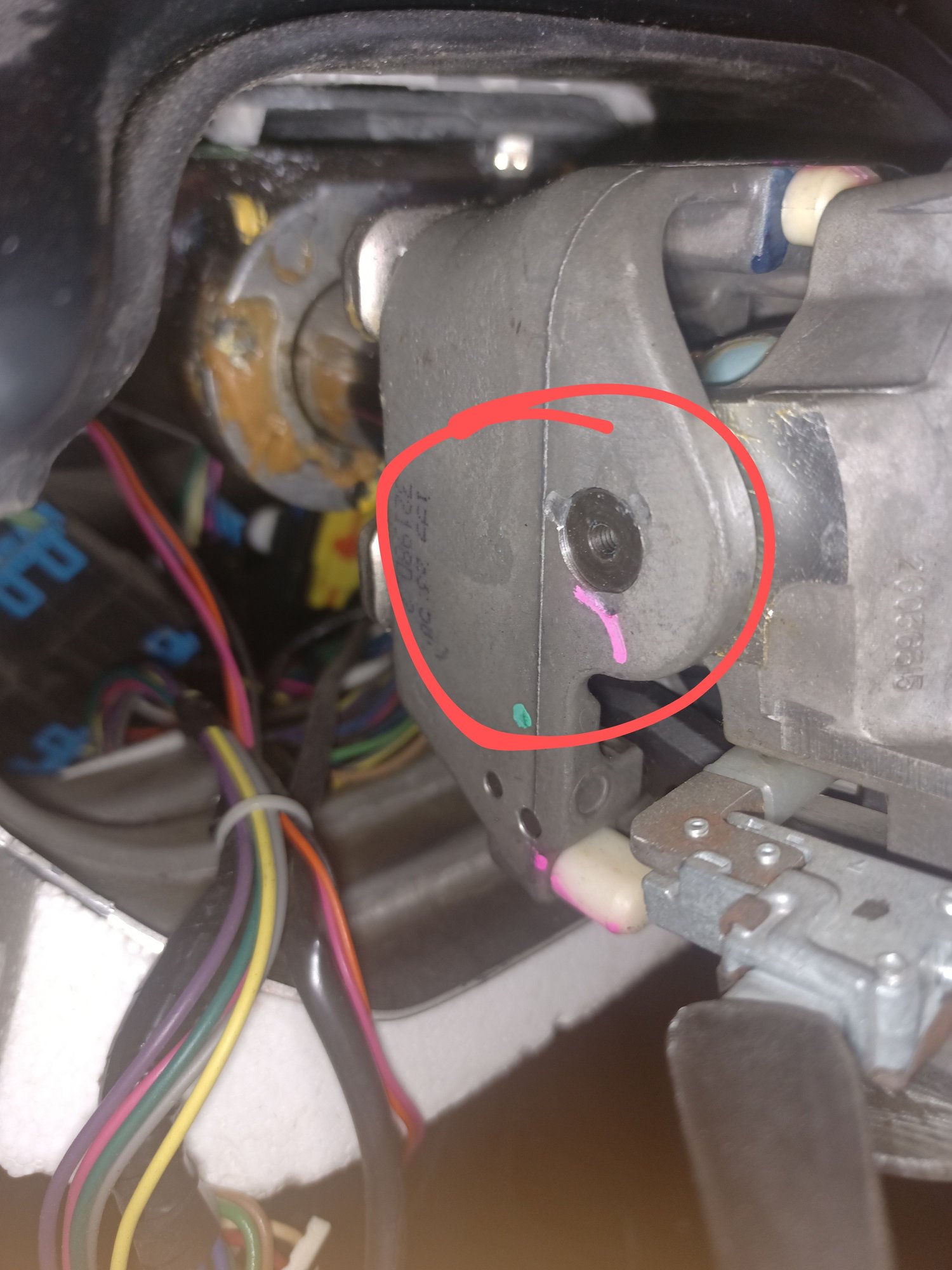

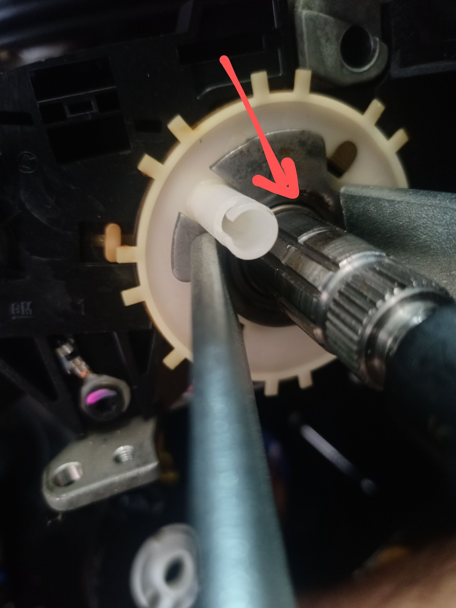

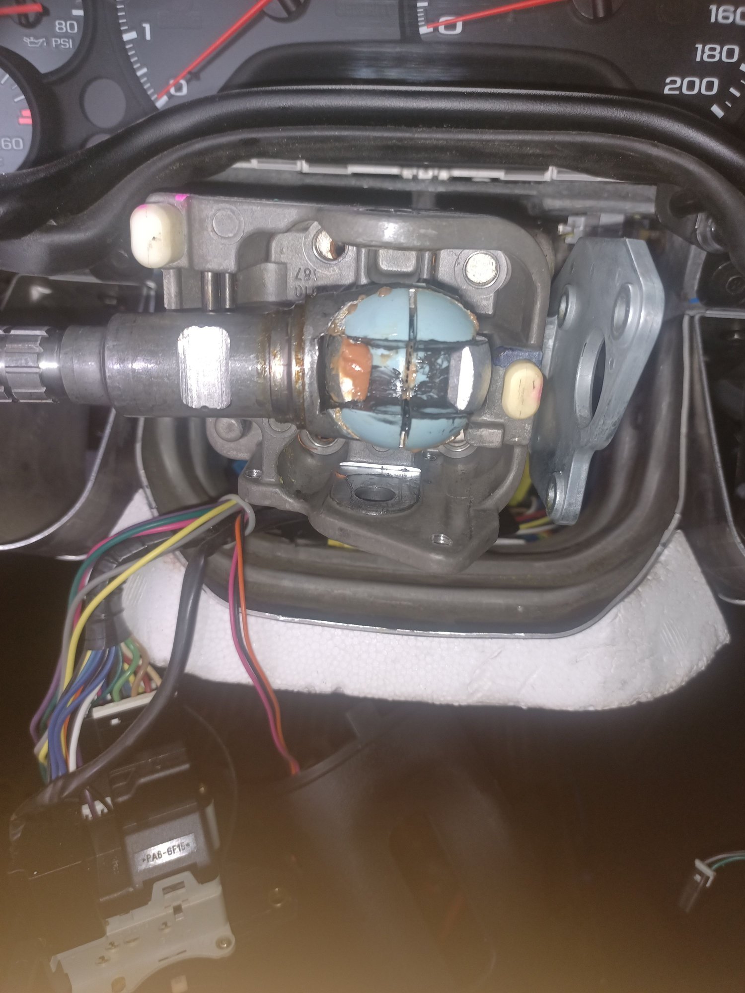

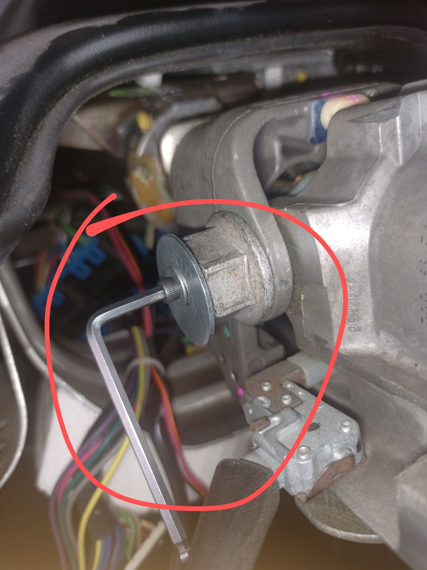

Old May 4, 2024 | 10:52 AM
link9a's Avatar
link9a
Joined: May 2021
Posts: 384
Likes: 52

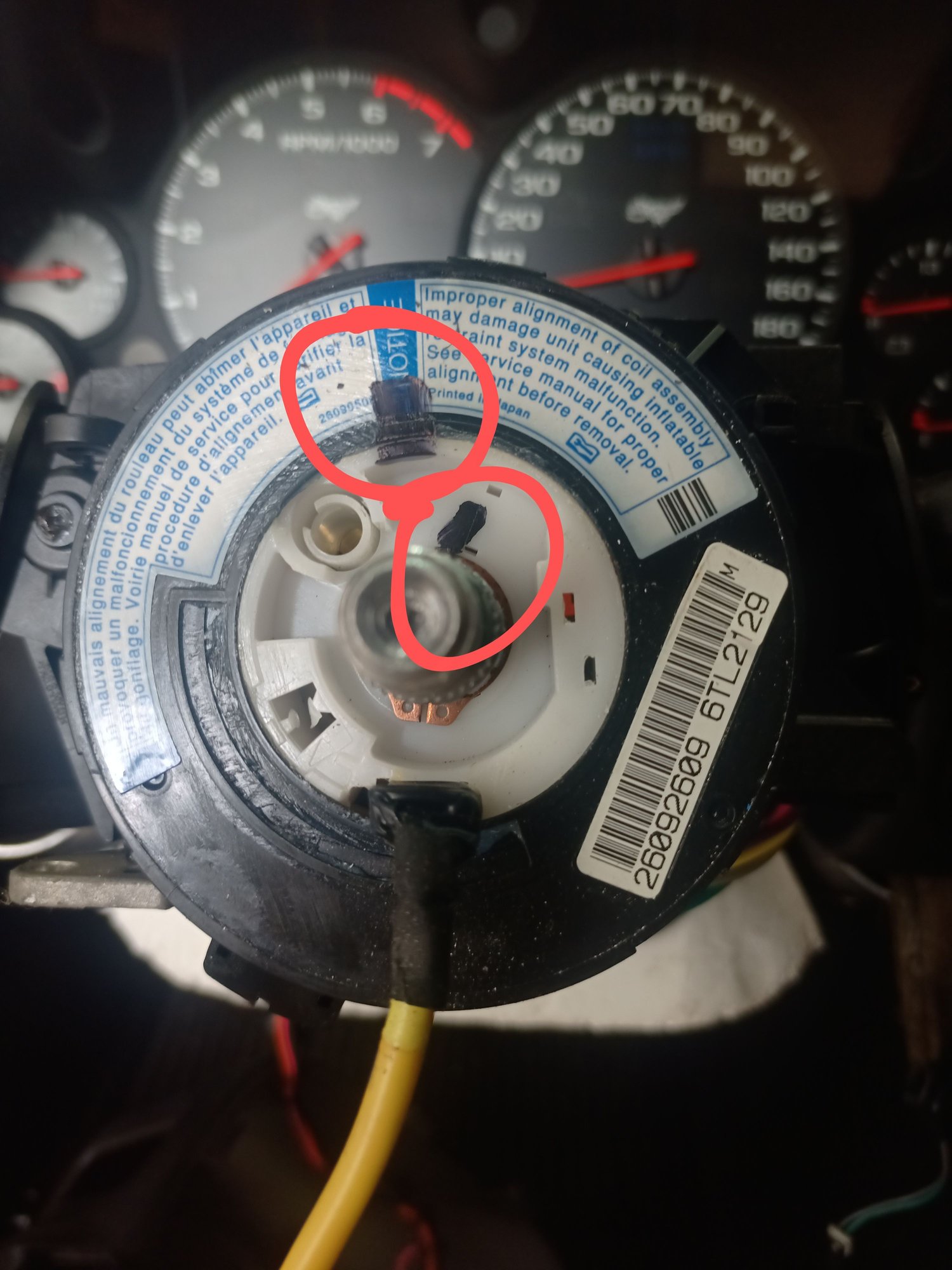

Mark the clock spring so you don't turn it over when you put it back
remove that washer

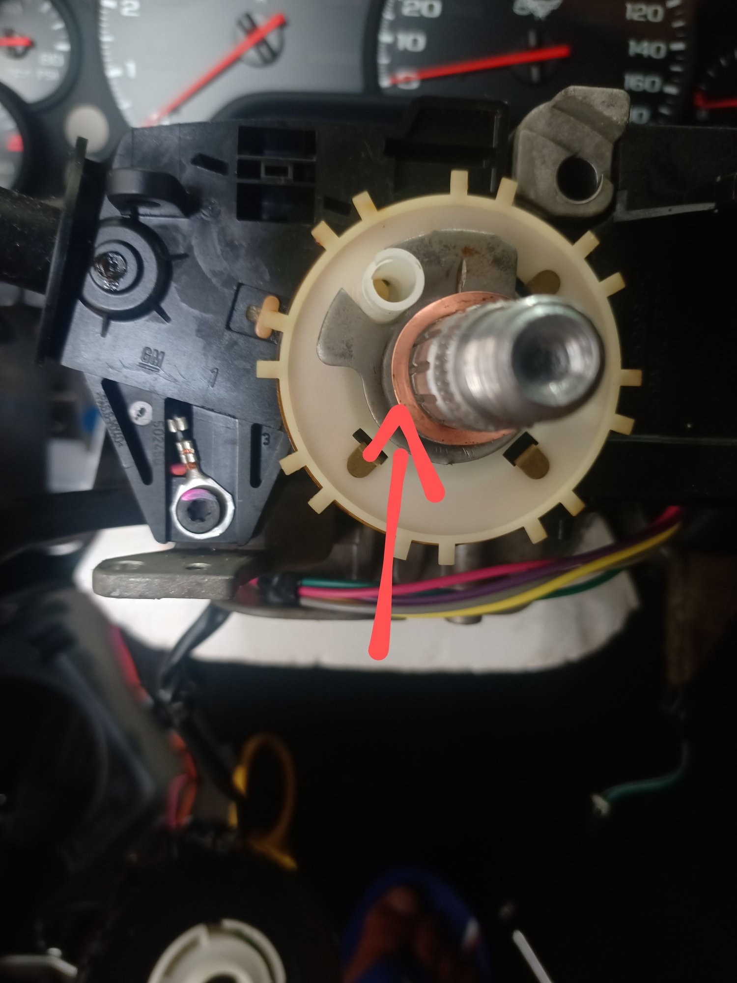

Using special tools to release the pressure to remove the ring
Remove the ring
Than remove the plate and the plastic piece
Remove HEADLIGHT / TURN SIGNAL / CRUISE CONTROL LEVER bolt's (2003 Auto US build don't have Steering Wheel Lock)
Release that spring by pushing down screwdriver

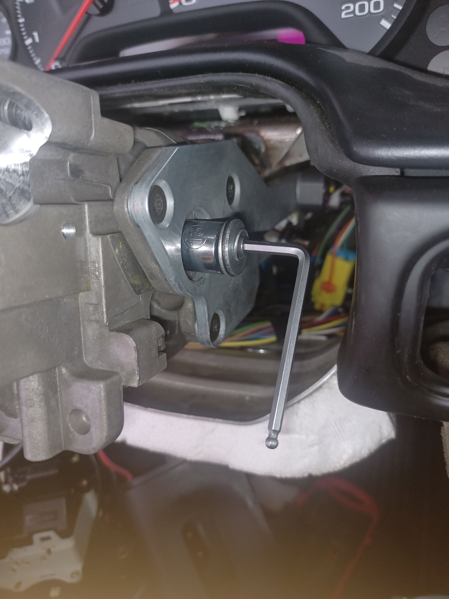

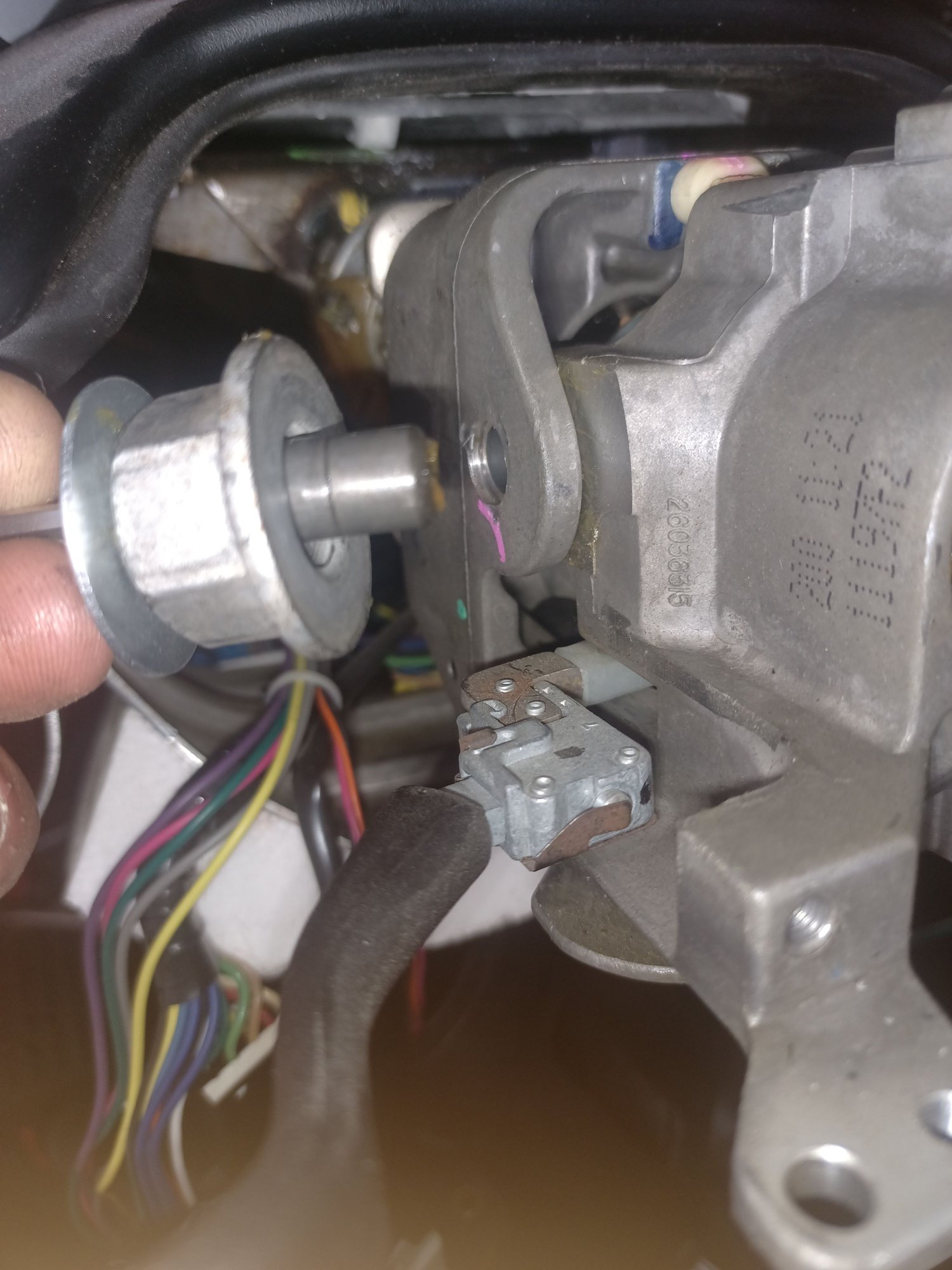

Remove that PIN from the both side by finding a screw Allen key . You need to take out that PIN by tightening the screw in
Remove the bracket after the that
All done

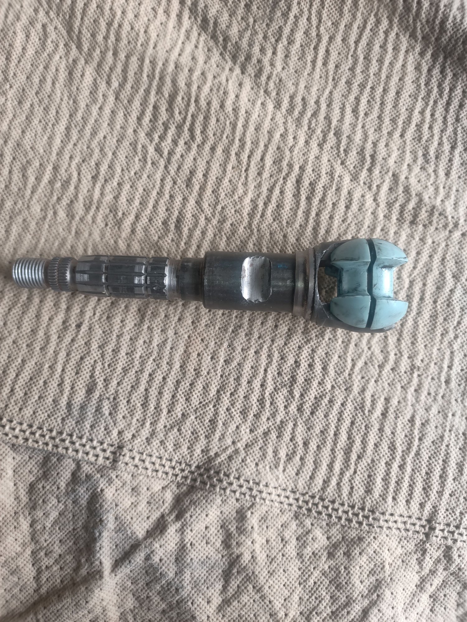

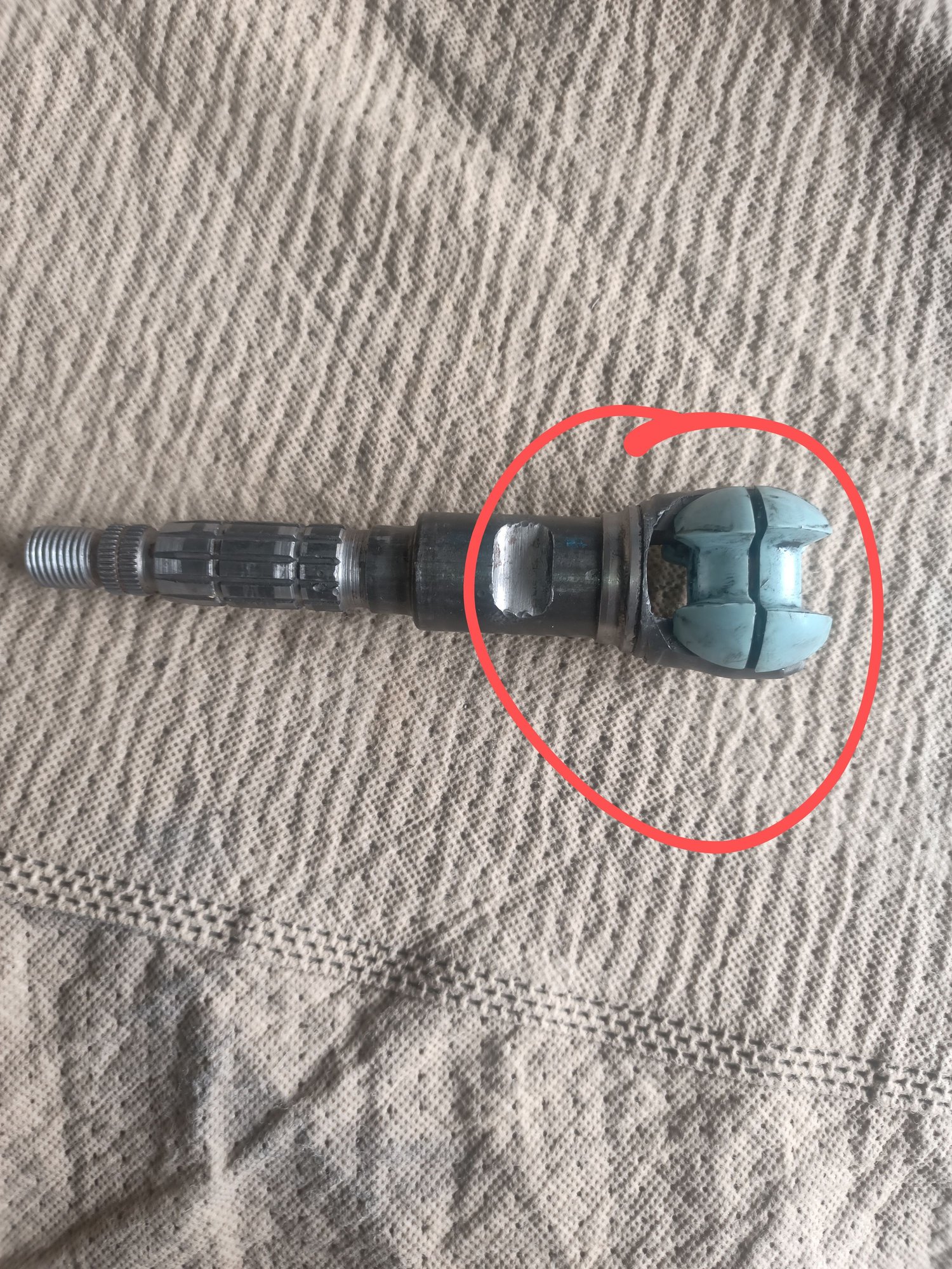

You welcome ...did you buy the column shaft complete piece like this one with the ball ?
Old May 4, 2024 | 02:34 PM
Daws's Avatar
Daws
Joined: May 2024
Posts: 17
yes! After you sent that first picture of it I made sure to find one with the ball.
Old May 4, 2024 | 02:39 PM
link9a's Avatar
link9a
Joined: May 2021
Posts: 384
Likes: 52
That good because the ball are removable from shaft to other shaft if needed. and it's very complicated if somebody missed the original direction when he put it because the shaft doesn't fit as before ...
Make sure to take some pictures or video when you remove the original shaft in case of you forget how you put back the shaft
