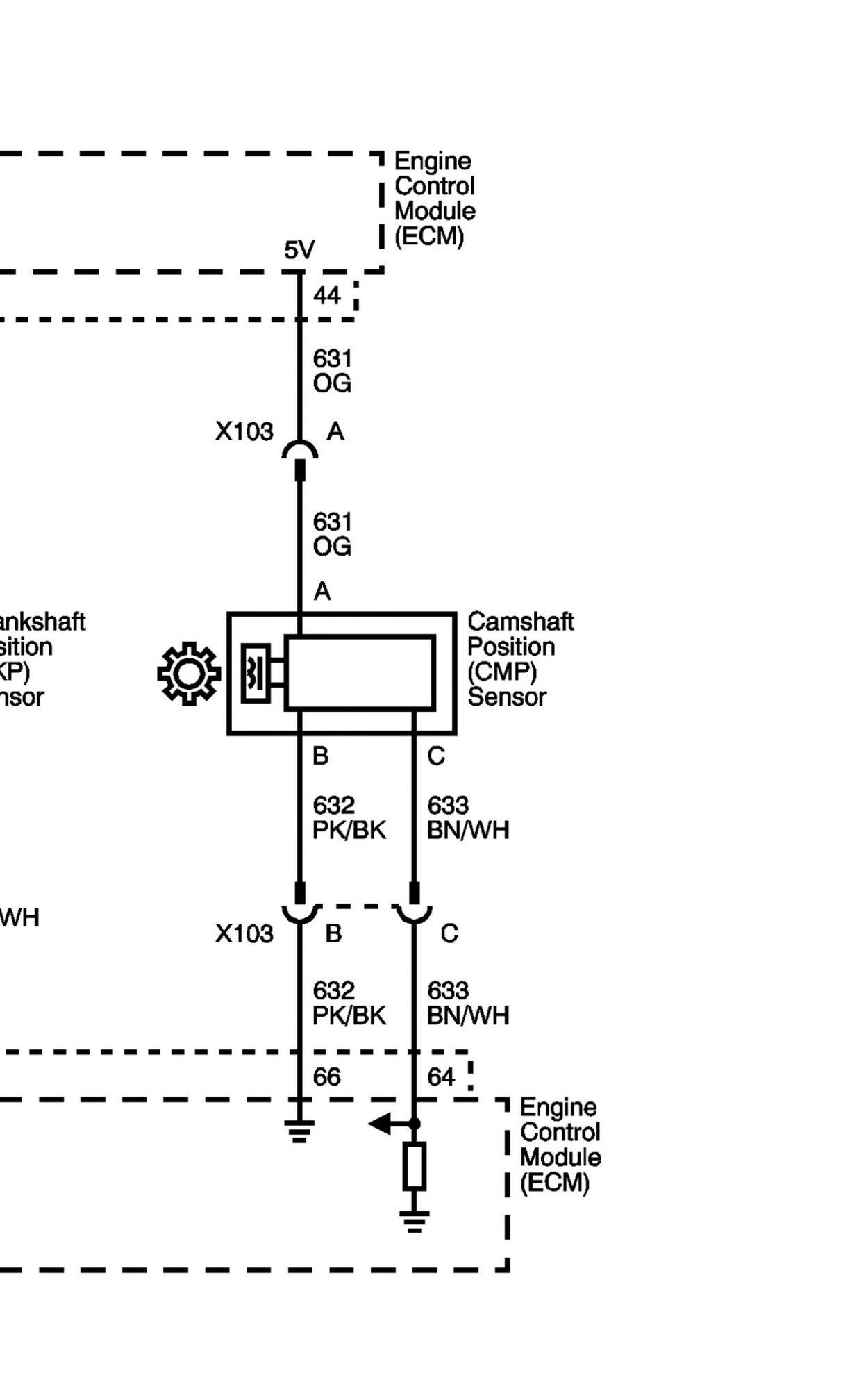

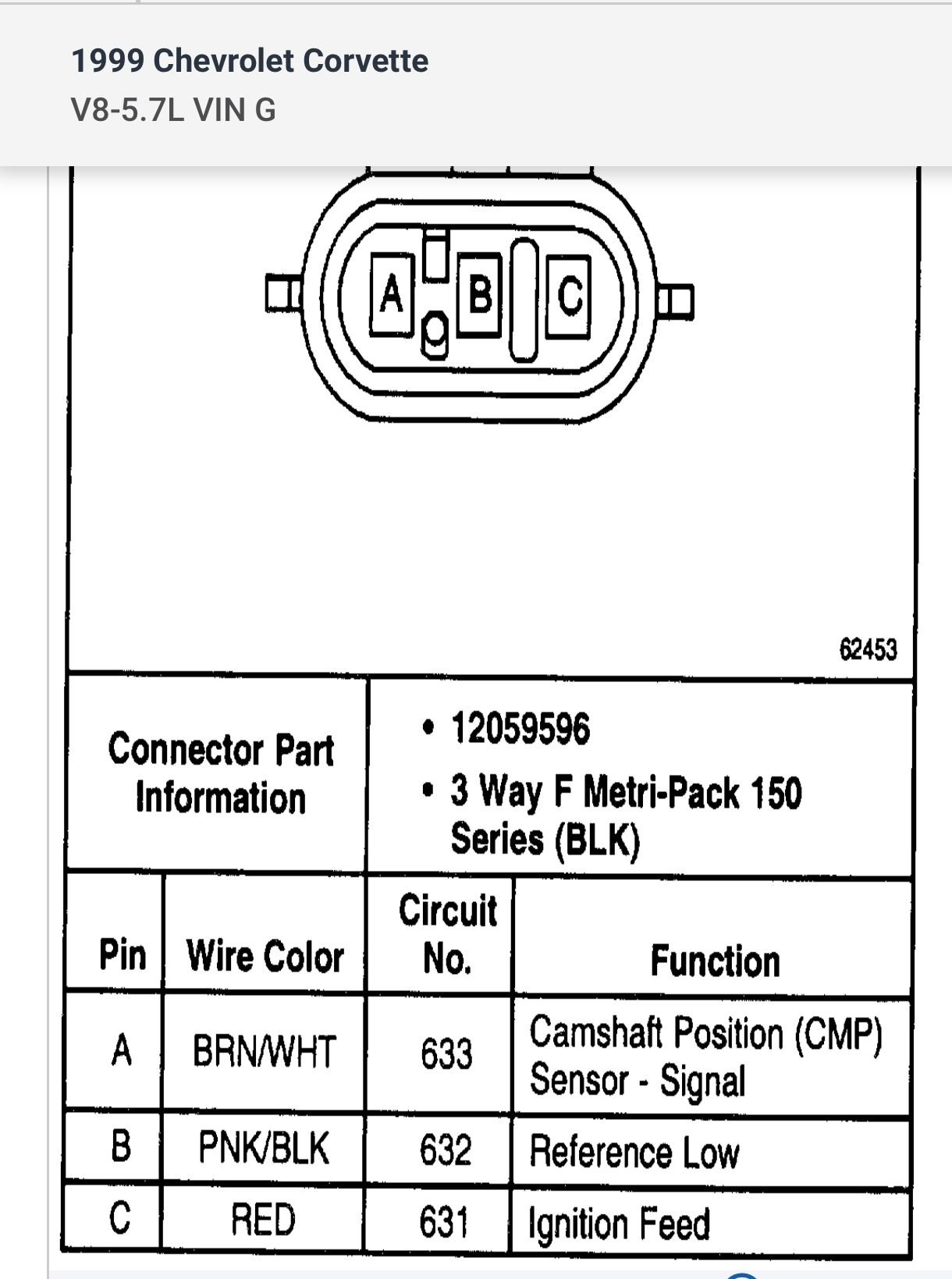

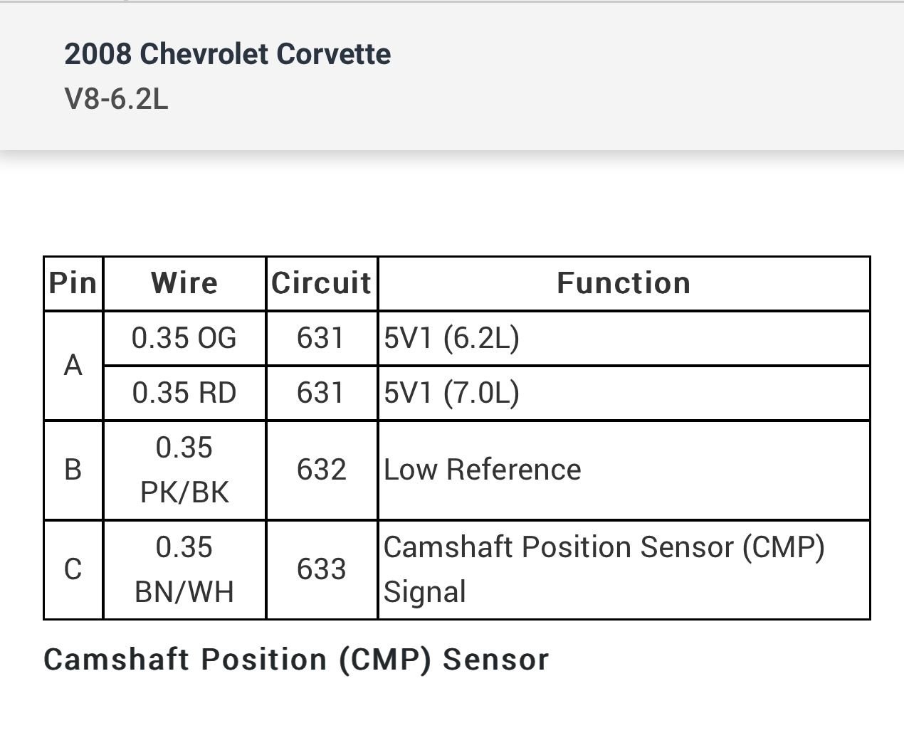

OK, a 99 CMP uses a 1X reluctor and an LS3 such as my LS3 2008 uses a 4X reluctor so right there you have some differences…the 99 PCM if that is what you’re using is looking for the 1X and your LS3 has the 4X so it’s not gonna work…the 99 CMP uses a 12 volt feed for that Hall Effect sensor and my LS3 uses a 5 volt feed so you have differences there also…connector pin out are different too !!…now as far as CRANKSHAFT position sensor the LS3 uses a 58 tooth reluctor on 2006 and above and 24 tooth reluctor on a 2005 same as a 1999…you may need a conversion kit to make this all work.

Yes, you are correct…I have a 2008 LS3.
