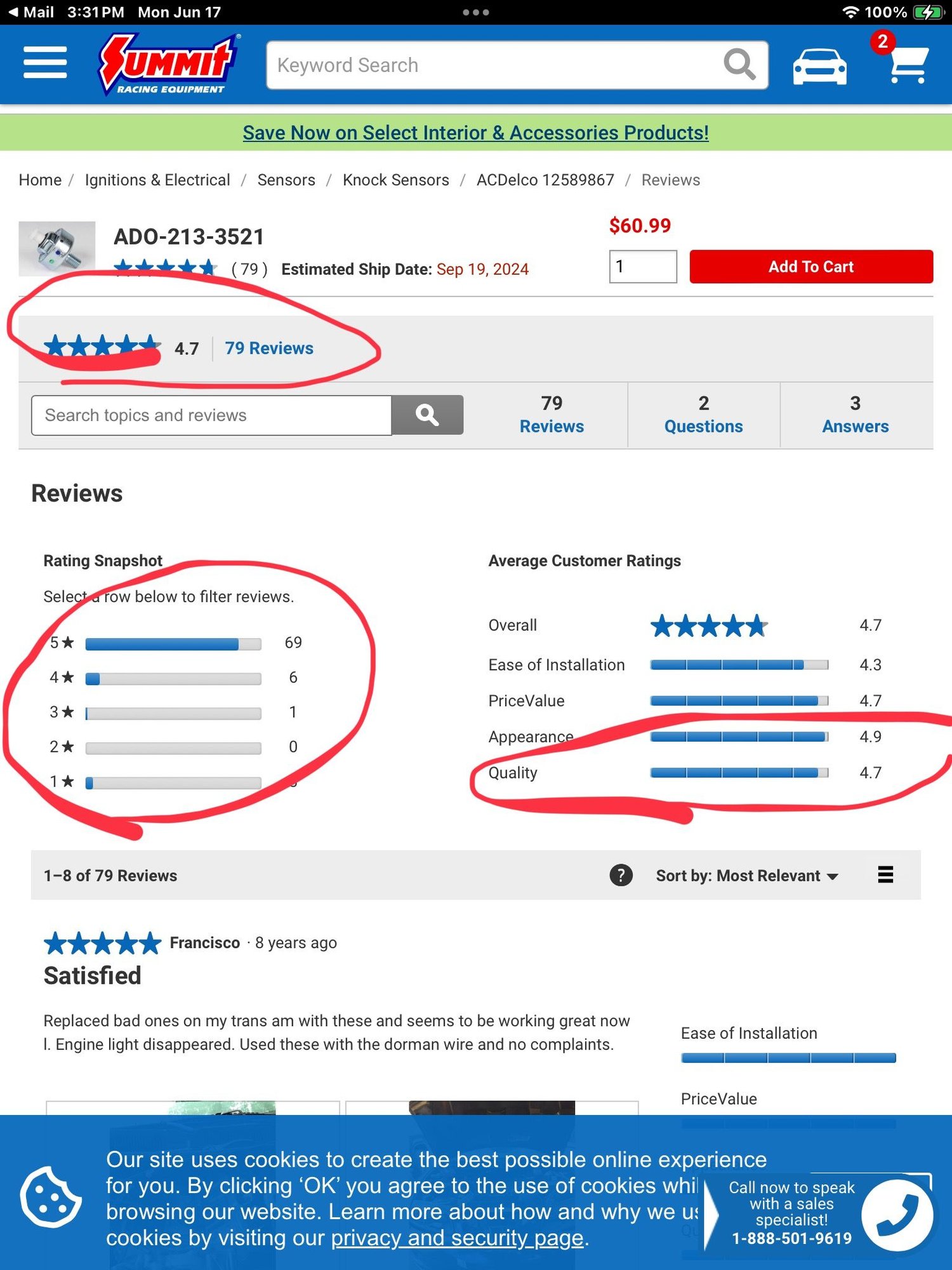

Eh, you just made my point. People will debate this, because they all have their own opinions, bias, whatever. This is a forum after all.
Evidently many consumers who commented on Summit have a different opinion than the many people of which you refer. Perhaps Summit is luckier than Rock Auto.

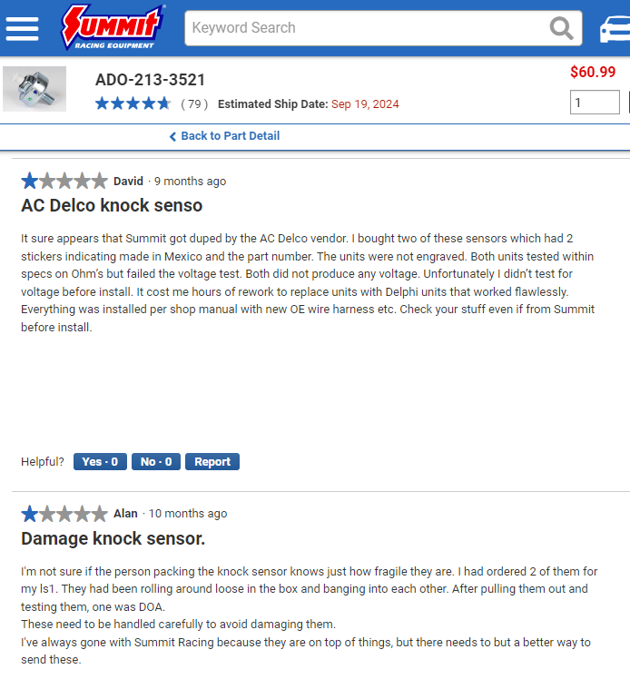

I can play this game too
You do realize that most of the reviews on this Summit Racing listing are older, right? And my post literally says over the last few years. In fact, of the 79 reviews there, only 15 are from the last few years.
Just like @lucky131969 pointed out, Any manufacturer at any time is capable of a quality escape(s).
Also, how many of the recent positive reviews on Summit are related to the C5 ? I counted zero over the last few years. Not saying it would be different from other LS-based vehicles, but it could be.
And for fun, 2 negative recent reviews. Did you know the reviews can be sorted chronologically?

AC Delco knock sensors have presented a large sample size of apparently defective parts (based on them causing knock sensor codes that didn't exist prior to installing those parts) over the last 2 years. Regardless of your own experience with AC Delco's "successful history" it doesn't change the fact that many of us had wasted money while experiencing otherwise.
Since you seem unaware... these are just some examples of what I'm referring to across Corvette Forum. Note that each listing could contain more than one person's experience.
