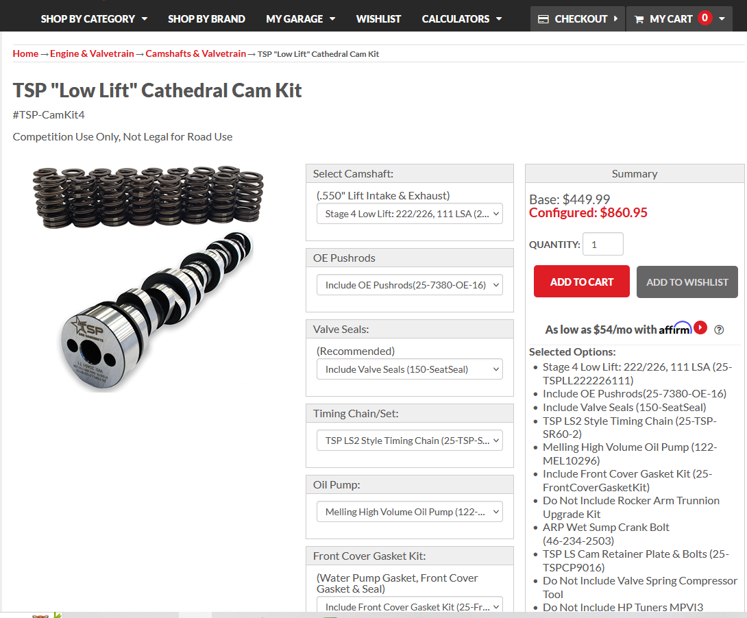

I used this one (2° overlap):
https://www.texas-speed.com/p-9501-t...-camshaft.aspx
I bought the kit that came with new springs. You can add gaskets, pushrods. CNC ported 243 heads... Well, While you are there. That's how I started
https://www.texas-speed.com/p-1158-t...l-cam-kit.aspx

All in, other parts being serviceable:
Nothing better than spend others money... JK!!!
