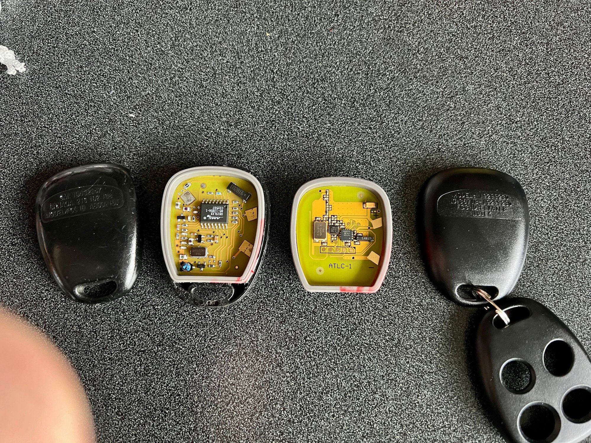

Ok, so I got the eBay keyless fob and it won't learn.
It came with a battery so next step is to put a fresh one in just in case that is the problem.
The numbers on the back of the key fob are different than stock but I bought the 2000 model that said it required. The insides look different too:
Stock unit on left, new unit on right.
