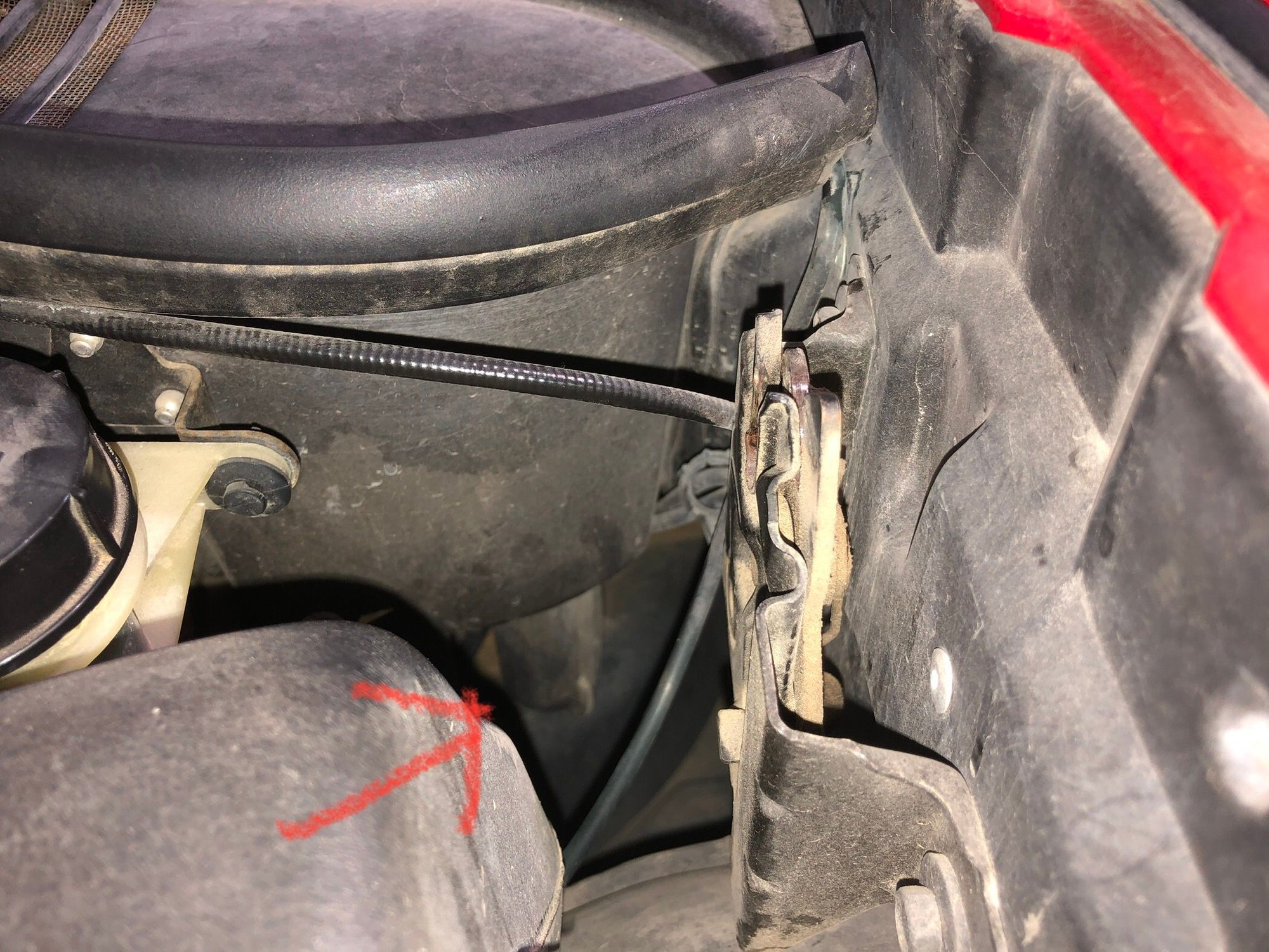

Ok, I need you guys help again. Can anyone tell me where and how to locate the drainage udders?? Im get leakage in the passenger footwell.

https://www.corvetteforum.com/forums...ur-udders.html
Under the driver's side I can reach two of them on a 2000 convertible. Here is a photo from the top pointing to one that is visible.

There is one on the passenger side that is described in the link Dads2kconvertible posted. That is the one that is giving you trouble most likely. It is curved not straight like the ones on the drivers side. Behind the battery you can access it, pull it out to clean it throughly. Armorall or something similar will help you get it back in after snaking it’s twists and curves back in place.
