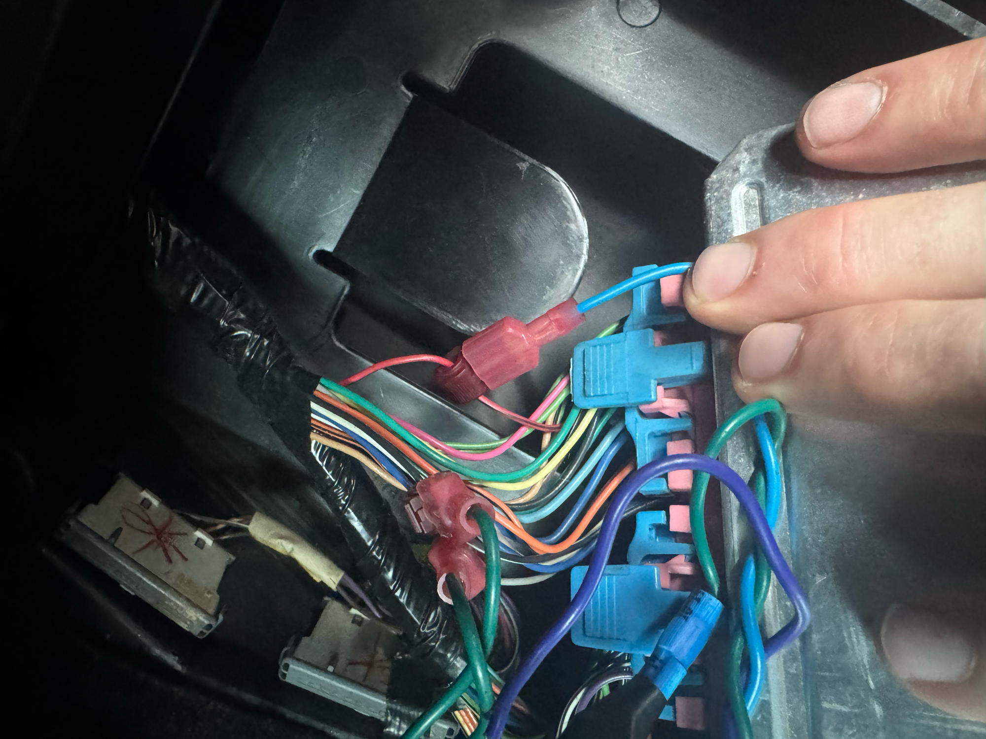

I am getting PCM-No Comm with several common serial bus errors. I checked Pin 2 in the OBD port and I'm getting <1v DC there. My reader can't pick up. From the dash, I will put the pulled codes below. I pulled both star connectors one at a time, and both together with no change in the status of the OBD port or starting. I have cleaned the grounds by the left and right headlights as well as the one under the battery that the PCM connects to. The PCM ground is nicked with copper showing, probably from me putting the battery in and out while working on the car. I'm looking at the schematic for the serial data port, but I'm not really seeing a common failure I should explore next. I could go for PCM or any of the door modules, but I hoped for some guidance. I also removed what looks to be aftermarket insulation pierce connectors around the BCM.
Aftermarket connectors disconnected

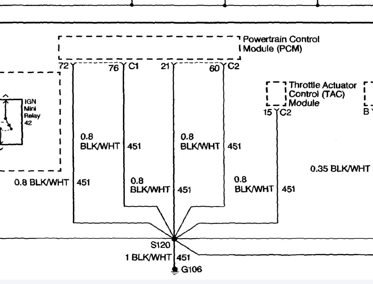

On a GOOD data bus with the key ON checking voltage at pin 2 the voltage should be fluxuating between 0.2 to 0.7 volts...if voltage steady and low near ground the data bus may be shorted to ground...take an ohm meter with battery disconnected and measure pin 2 to ground...resistance should be over 8000 ohms...if below 350 ohms that’s bad...if you remove both splice pack "combs' jumper the PCM to the BCM which are the dark green and light green wires...the car should start if BCM and PCM are good...if you think the PCM is bad jumper a wire from the dark green PCM wire to the purple wire which is the data bus wire (A) and if you can't communicate with your code reader which only talks to the PCM then the PCM is bad...you should check ALL PCM powers and grounds before condemning it…if you can communicate with the PCM then the BCM is bad…there are 4 wires which comprise the PCM ground…that ground is located on the engine block where the negative battery cable connects to.

G106.
