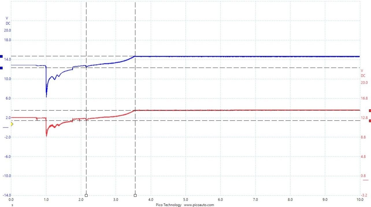

You will need to get the proper voltage regulator listed below…the OEM Valeo alternators have a “soft start” feature where the alternator voltage increases slowly when first started…look in between the dashed lines and you can see the voltage increases slowly from 12 to 14.2 volts or so in about 1.5 seconds…this is what is giving you the “charge fault”…try EBay or other sources for your regulator…if you still have your old alternator core you can try using that one…most members just have theirs rebuilt at an alternator shop.
