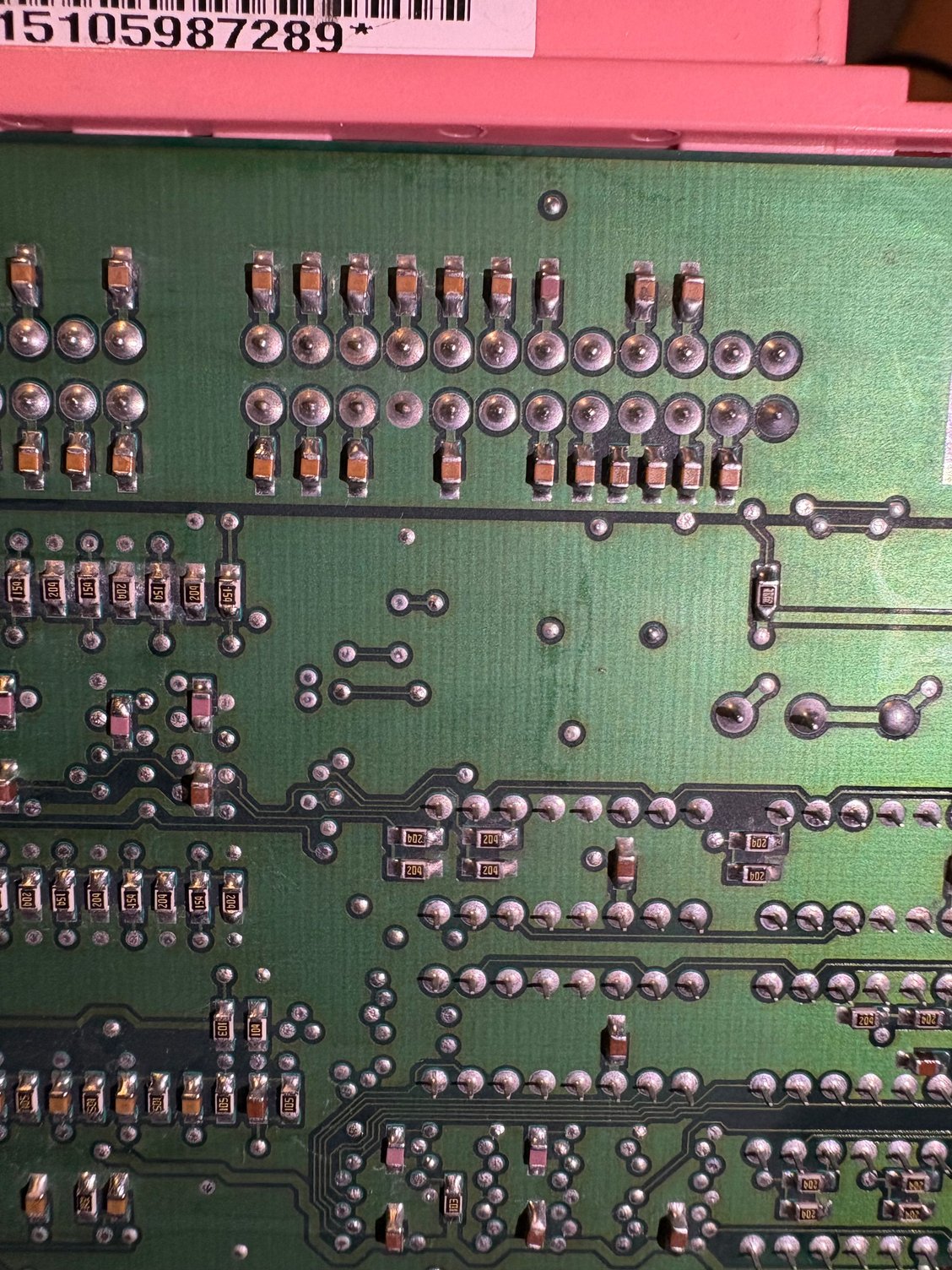

I disconnected the battery, removed the BCM, tried drying it for like 15-20 min with a Blow dryer. Connected it back up, started the car back up and the DIC screen started flooding me with messages like "Reduced Engine Power", ABS light, and "check tire pressure". I Immediately disconnected the battery once again, and took it out so I can take a look inside the BCM and this is what I found:
Let me know if that looks bad. but that top part looks like corrosion to me. what do u think ????
I have also have videos of when I got flooded up with messages if that interests you. THANK YOU Lucky.

Yes, looks like electromigration (shorts) between many areas. You can try to clean the surface with isopropanol and a nylon brush. Blow dry with a clean compressed air source. 50/50 chance of recovery.
I'm surprised there is no DTC set with the "shocks inoperative" message. Are you reading the codes from the DIC ?

Yes, I am reading out the codes that the DIC was giving me. And I am going to the store today so i can get the Isopropanol Alcohol and nylon brush. When brushing with the Alcohol what do I hope to get off?? How long should I Scrub for? would a regular blow drier on high heat work? When the cleaning is done Do I just put everything as it was? If it works out is the messages going to automatically go away when the car is turned on?
Thanks.
The residue on the printed circuit board bridging the circuits that is not supposed to be there.
8545901]How long should I Scrub for?
Are you f-ing with me ? Until the residue is removed....IF it works.
No. Some stores carry cans of compressed air for cleaning keyboards, that will work too.
Is this a trick question? How else will you find out if you were successful?
Thanks.
No, because it looks like you have a problem with RTD. The DTC preciptates the messages, that's why I'm surprised you do not have any. To my knowledge, RTD does not have any input from the BCM. Cleaning up the BCM was to address (and hopefully mitigate) the water leak that you had.
The codes you posted "U1016 and U1096"..... U1016 is loss of communication with the PCM, and U1096 is loss of communication with the IPC.
Get it cleaned up, put everything back together, make sure you have a fully charged battery...and see if she fires up. Then try to clear the codes.

Greetings, I just wanted to update you with the situation. I cleaned it yesterday with The Products you listed and put it back as it was.
This is the after results. Later today I’m going to plug it back in as well as my battery to turn on the car on. Is there anything I’m hoping to see when the car is on with the cleaned BCM. Thank you.

Looks much better. As already explained, drying out the BCM and cleaning the shorts was a preventative measure given the leak. Make sure the BCM connectors on the unit and car side are free of moisture as well(if you have not already) before plugging in. Ideally, everything should work related to the BCM, and you will just have to troubleshoot the RTD issue. Don't forget to unclog the udder on that side or it will happen again.
