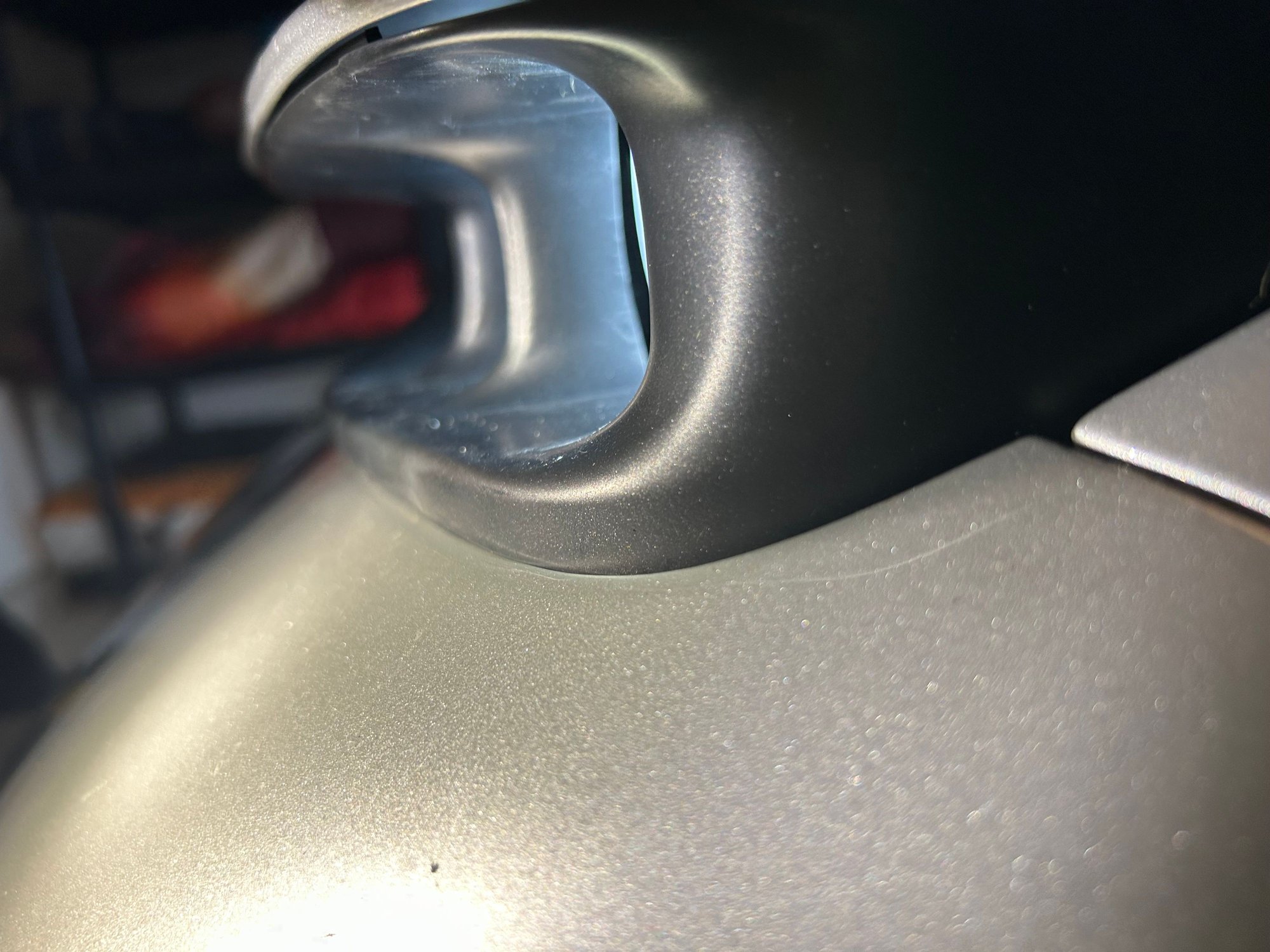

I feel like a dumb dumb having to ask because it seems so strait forward. When installing the bezels they poke past the front bumper. They don’t line up with the two back screws where the headlight cover connects to the assembly. When they do line up, the bezel sticks out past the bumper. (picture below) Does anyone who installed them have any insight or run into any issues installing them?

You have to raise your stop bolt/jam nuts so the lights don't come up as high. This will lower the bezel so that the lower bezel lip does not come up beyond the front bumper. Then, being lower now, you'll need to raise your headlights with the goldenrods because after lowering the lights overall, they'll be pointing in the dirt.
I had to do this procedure to my passenger side and it came out better.

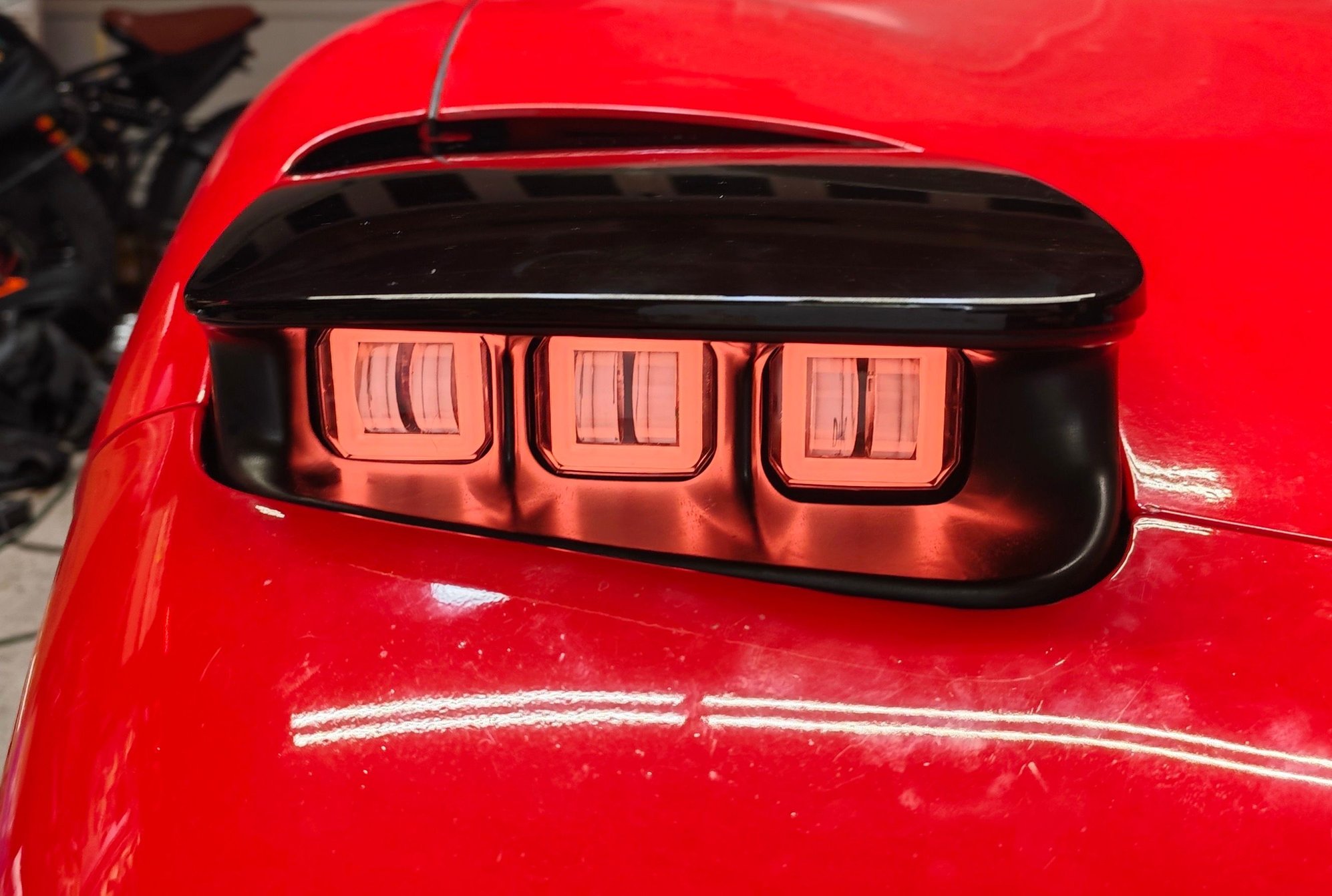

Thanks for trying, I genuinely appreciate it. I used to be a member on the Knight drive FB, but I cancelled FB a couple years ago. I have some adjustment questions and I'm not positive how to find the answers. I just installed the new brackets today. I have one of the original versions and the bezels required a bracket upgrade. They sit great up and down, but my inner most light pod (towards the center of the car) is set back too far towards the rear of the car and bezel has a big gap around that particular pod. The gap gets much better as it goes down the row to the outer most pod. Any advice would be appreciated. All I can think to try is the headlight aiming screw, but it seems like it has to travel quite a bit to sit correctly and then won't my lights be pointed out to the side too far?

I'll try to.grab a picture after work and post it. Thanks for.the advice. Mine are also set to 5.25". Height is great, more of an in and out issue I'm having

In the photo, the left light pod, which is closest to the center of the car, doesn't seat against the new bezel. Is this a matter of turning the shorter of the gold rods/aiming rods? Thanks everyone for the advice. I don't have FB anymore to see the videos that I hear Damien posted about the adjustments
