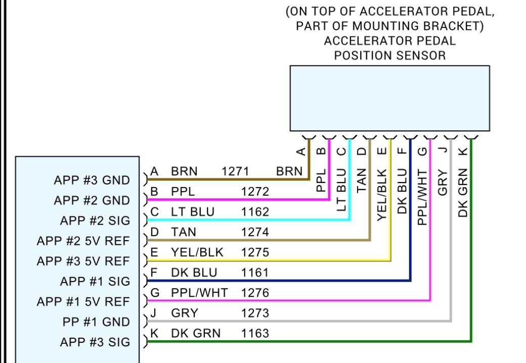

Can anyone point me to the process to test the APP while it's in the car? I believe it can be tested with a voltmeter. I searched everywhere but could not find any process that would work or where to test the plug at

Do you have any APP DTC’s stored ??…a lab scope is preferred for testing but if you want to check it with a DVOM the signal wires are what you’ll be checking at the sensor…light blue, dark blue, and dark green…there are 3 potentiometers contained within the sensor…you have a 5 volt reference, signal, and sensor ground.

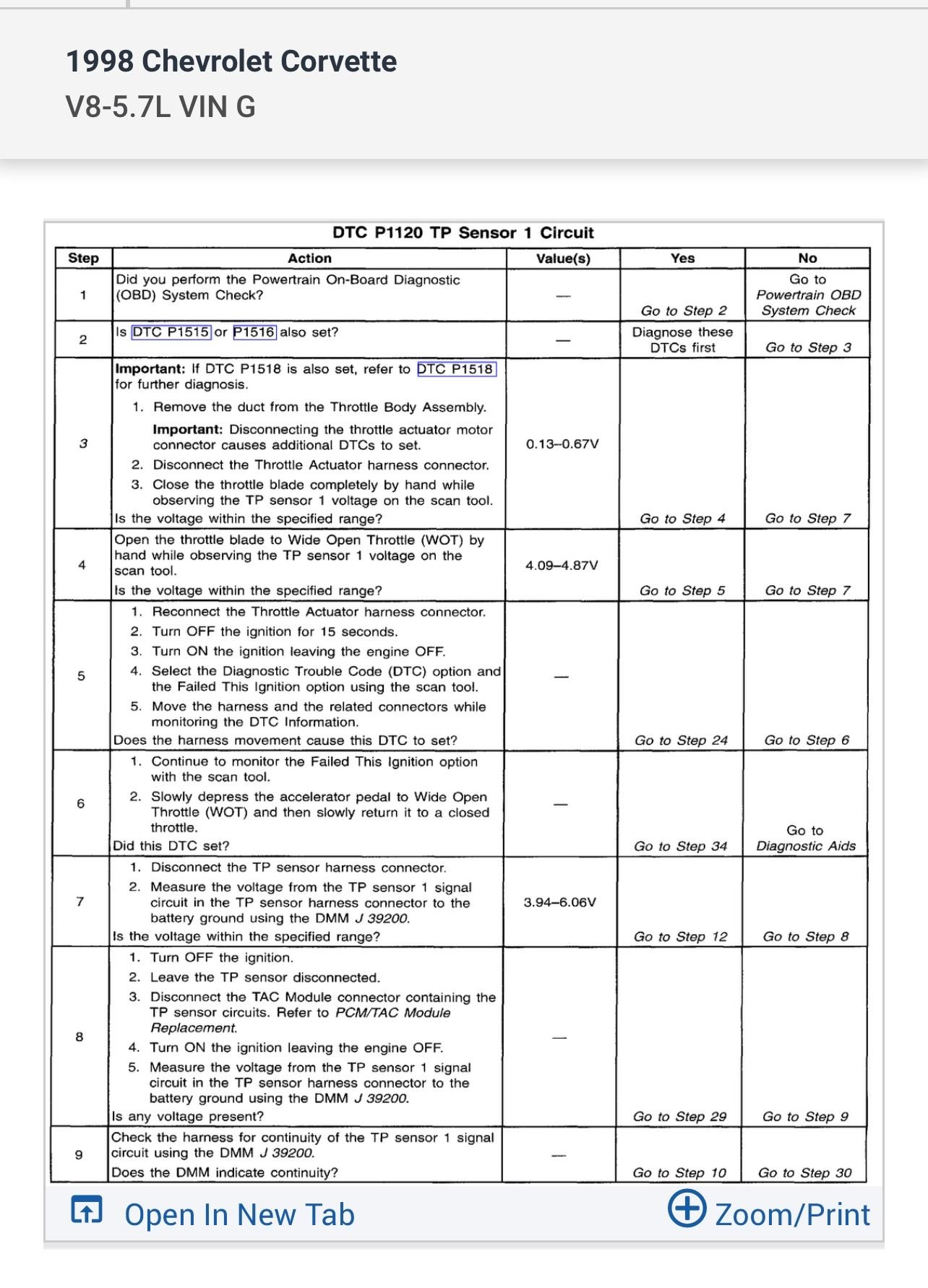

I was getting p1120 for TPS. This p1125 just showed up. Nothing is consistent unfortunately.
