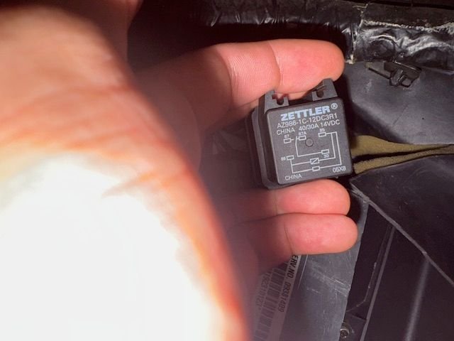

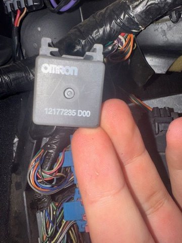

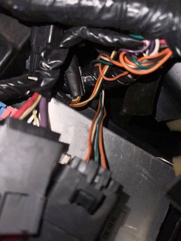

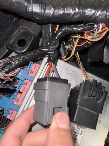

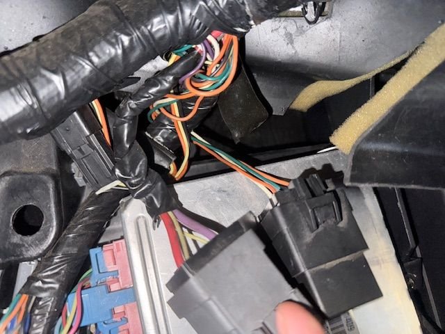

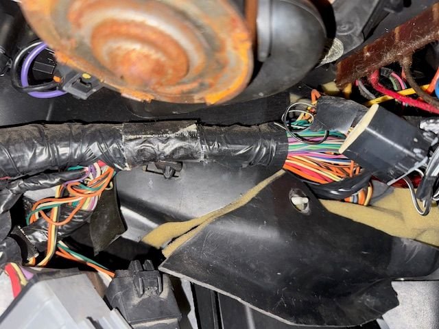

If someone could help me figure out why someone would need to do this and what exactly they tapped into it would be greatly appreciated.
These were put on a harness near the BCM. Thank you for your help.

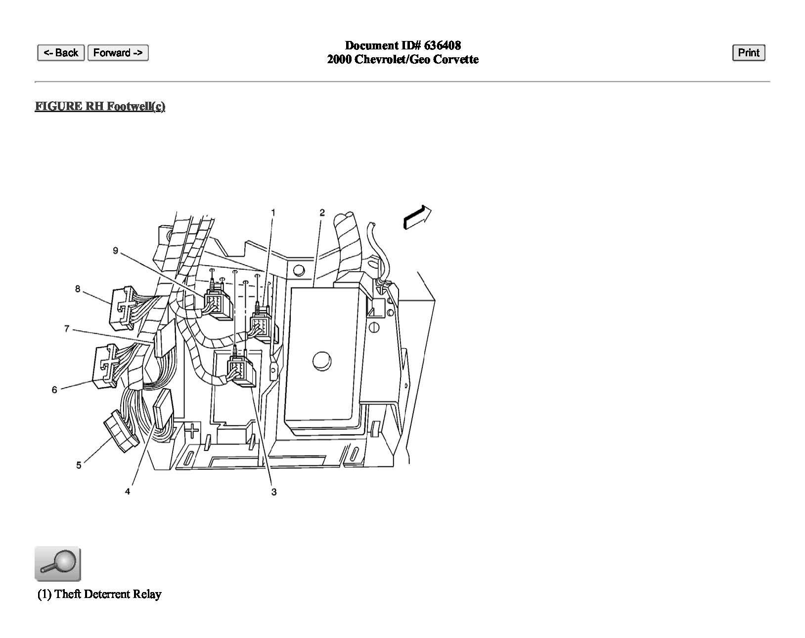

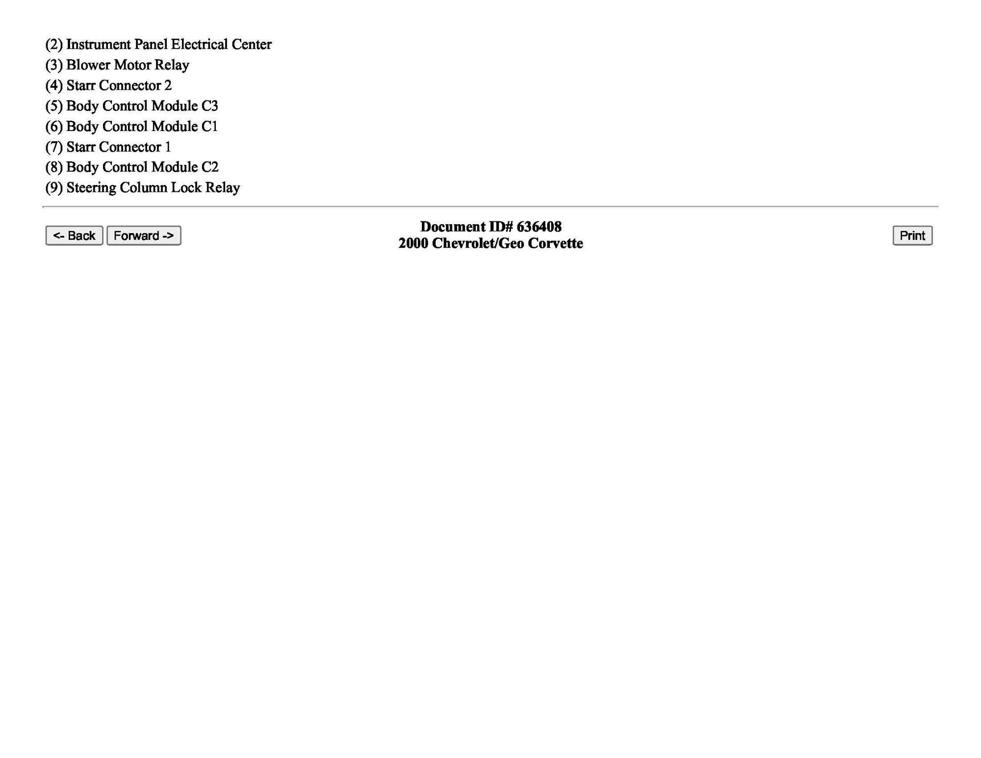

I see the theft deterrent relay and the colum lock relay. Is there something else you are asking about? I do not see any splices or hacked up wiring.

That's all thank you ! Just to clarify though those relays were added right they aren't original ? I'm newer to the car scene so I'm sorry if I need it to be dumbed down.

Fill out your profile for model year info....all C5s are not the same. NO....they were not added, they are original to the car. You will be well served to get a service manual set for your car.

Thank you I will look into that service manual set.
