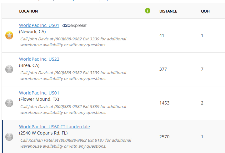

There are a few real OEM ones out there.
part number 10465547
here is a list of where they are.
See if your local dealer or parts house deals with WORLD-PAC
