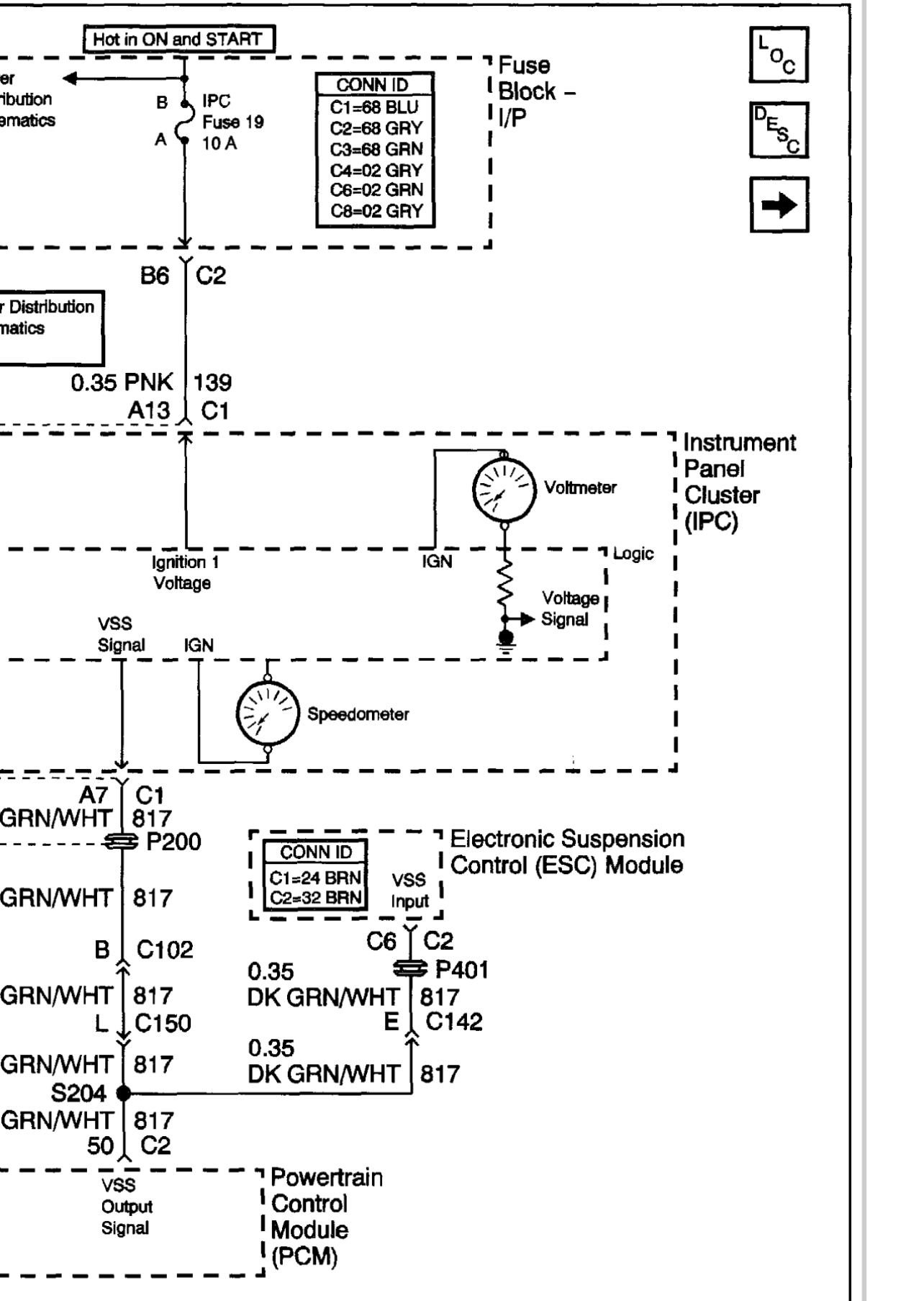

The voltmeter reading does not come directly from the battery but through the IGNITION 1 circuit…if you have a DVOM and basic electrical skills this can be easily diagnosed…Fuse 19 and a bunch of other circuits are tapped off the ignition switch pink wire which provides power to circuits like the fuel pump and injectors…BTW, the IP voltages are usually 0.3 to 0.4 volts lower than the actual battery voltage...a voltage drop test on the charging system should also be done...very easy....if this testing is over your head seek out an auto electric shop in your area...they do this stuff every day.
