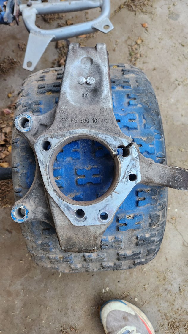

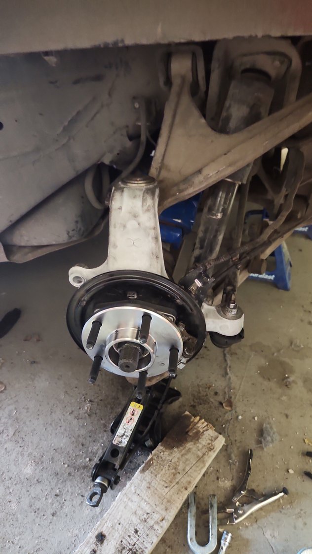

Hello guys, I have very little experience like a mechanic but I got to replace the rear hub and spindle of my C5, I installed everything back and it looks like the wheel it will get a little rotated to the outside, I didn't adjust anything from the suspension.
The old spindle was broken, thats why I was replacing it, could it be that my car was aligned like this to compensate for the broken spindle or I really did something wrong? Could it align like it should when I install everything back and get it on the ground again?

The cracked spindle is likely the cause of the misalignment. And installing the new spindle will require you to adjust the toe setting by turning/adjusting the tie rod. Most likely the alignment was previously adjusted to compensate for the cracked spindle. The toe adjustment is easy. I can guide you thru it if need be. Just let me know.

Thank you Hotrodz! I guess I'll take the car to a shop to get a complete alignment, I just had the doubt if I did something wrong when I installed everything back.

Your car will most like require more than just a simple toe adjustment after the impact it received to damage the upright (spindle) in that fashion. Take it to an alignment shop and have a professional four-wheel alignment done.
