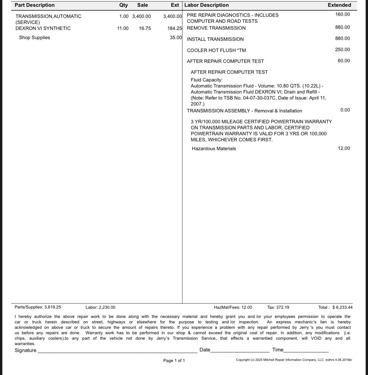

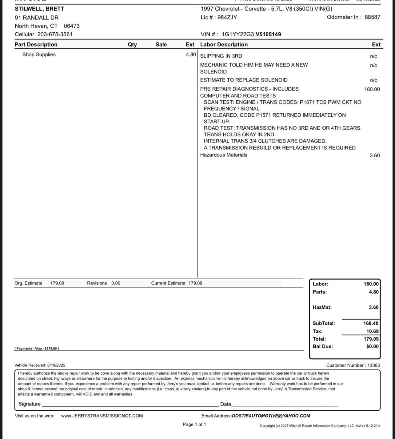

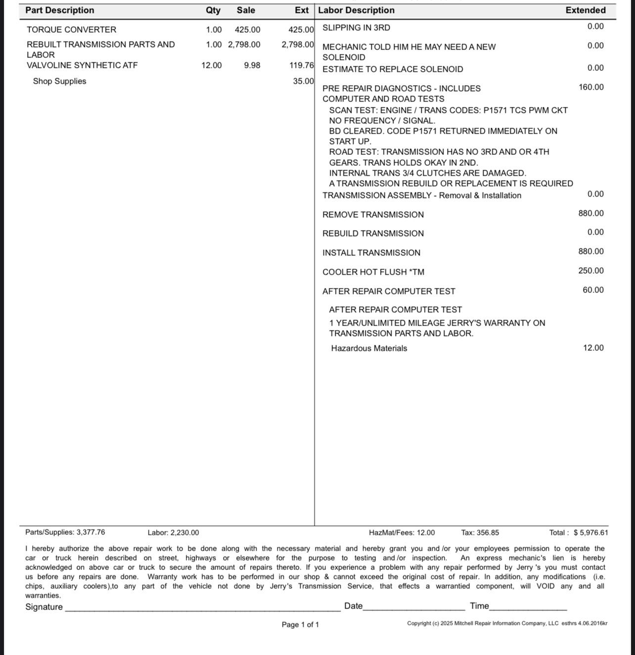

here is the estimate and diagnost
ic
Old Jun 19, 2025 | 04:53 PM
Fiberbundle's Avatar
Fiberbundle
Joined: Feb 2017
Posts: 1,274
Likes: 399
From: Tacoma WA
I think the labor costs are in the ballpark. It is cost of rebuilding the transmission that seems high without details on actual components that will be used in the rebuild. Also changing the torque converter may be needed if debris from the clutch pack got into it but if that is needed I would want to know the brand and rated stall. I would want to know approximately what increased horsepower he is anticipating the transmission to be able to hold since he mentioned beefing it up during rebuild. Also with 80K miles with everything out I would take care of rebuilding the torque tube since everything is out already.
However he is giving you a three year unlimited mileage warranty which is acceptable.
Two years ago I had a transmission build done on my 95 anticipating putting a supercharger on it and specifically mentioned needing it to be able to hold 500+ hp. Still a 4L60E and it was $2859 for the rebuild with the same warranty as you are getting.
