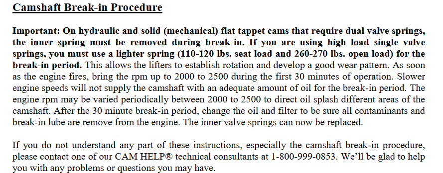

Originally Posted by Drhartwig
I am installing a new cam, cylinder hds, and valve train. Is there a suggested break in period and rules to follow?
For best results follow the manufacturer's recommendations. That's always a better starting point than some random goober on the internet with no vested interest in your project.
This installation guide is from Comp Cams, other manufacturers will have their own documentation.
I'm not sure why you would post instructions for flat tappet cam break in for an engine with a roller cam.
There is no break in procedure for a roller cam or its lifters.
I'm sure you are just citing an example here, but flat tappet design does not apply here......
Agreed, and their guide seems to indicate the inner spring removal is what they are referencing for the flat tappet design while the other part applies to all cams. But the document isn't perfectly clear on that which is why there is an included phone number one can call.
Would be interesting to know which specific cam the OP is using and if that manufacturer says 'no break-in needed'.
No.
The inner valve spring removal is to reduce the load on the face of the tappet during break in. Modern oils are not made for flat tappet cams and new cam failures are more common. That being said I really don't know why anybody would bother with a flat tappet cam in anything anymore.
None of that guide pertains to a roller cam.
