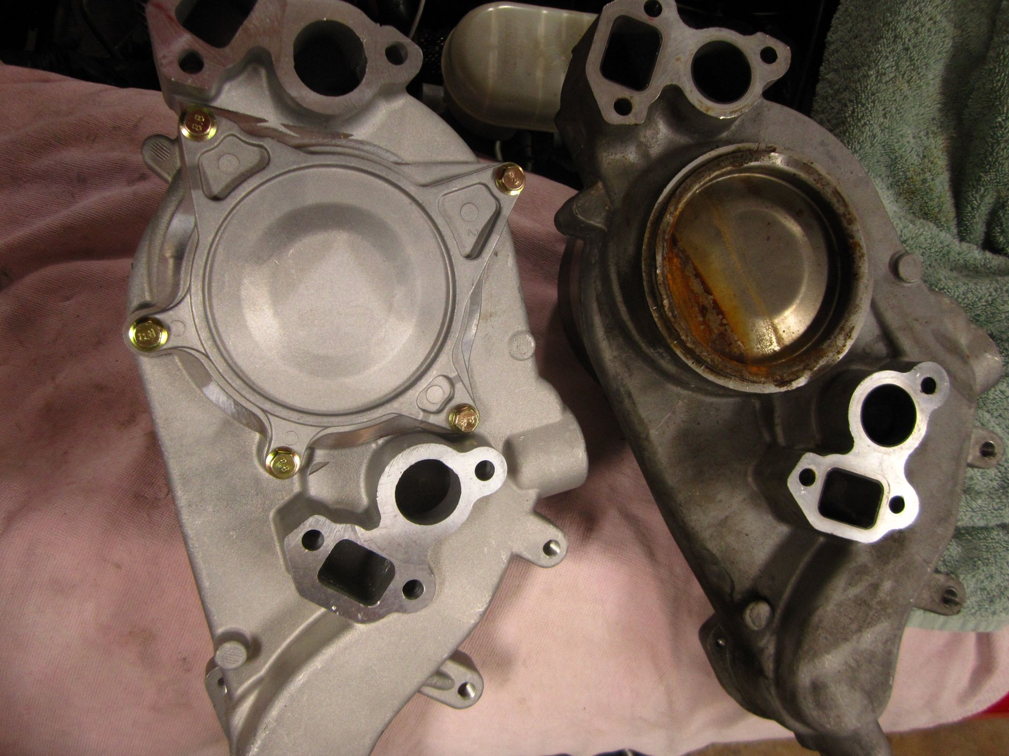

I just pulled the water pump off my 01 Z06, and compared it to the GM-12681185 which is supposed to be the replacement. The stock LS6 on the left looks way more beefy than the new GM. Do I have the correct replacement?

Could it be an aftermarket like PRW?

Think they replaced the spares ls1 pump with the ls2 pump but old pully. I got an LS3 crate pump. Uses a reg thermostat and needs the hose shortened.

The most important side is not shown. It should have the p/n 12681185 cast into the pump (aka ACDelco 251744). You will need the two piece thermostat housing and thermostat with this as well.

The one on the left in your picture looks like the NAPA pump I bought a few years ago.
Here, the NAPA is on the left and the rusted GM it replaced is on the right.
The new one has the 12681185 casting number. I already got the new housing and thermostat.
If this one is correct I'm good to go.
Yep...that's the good one.
Yeah, I bet it was already replaced before.
