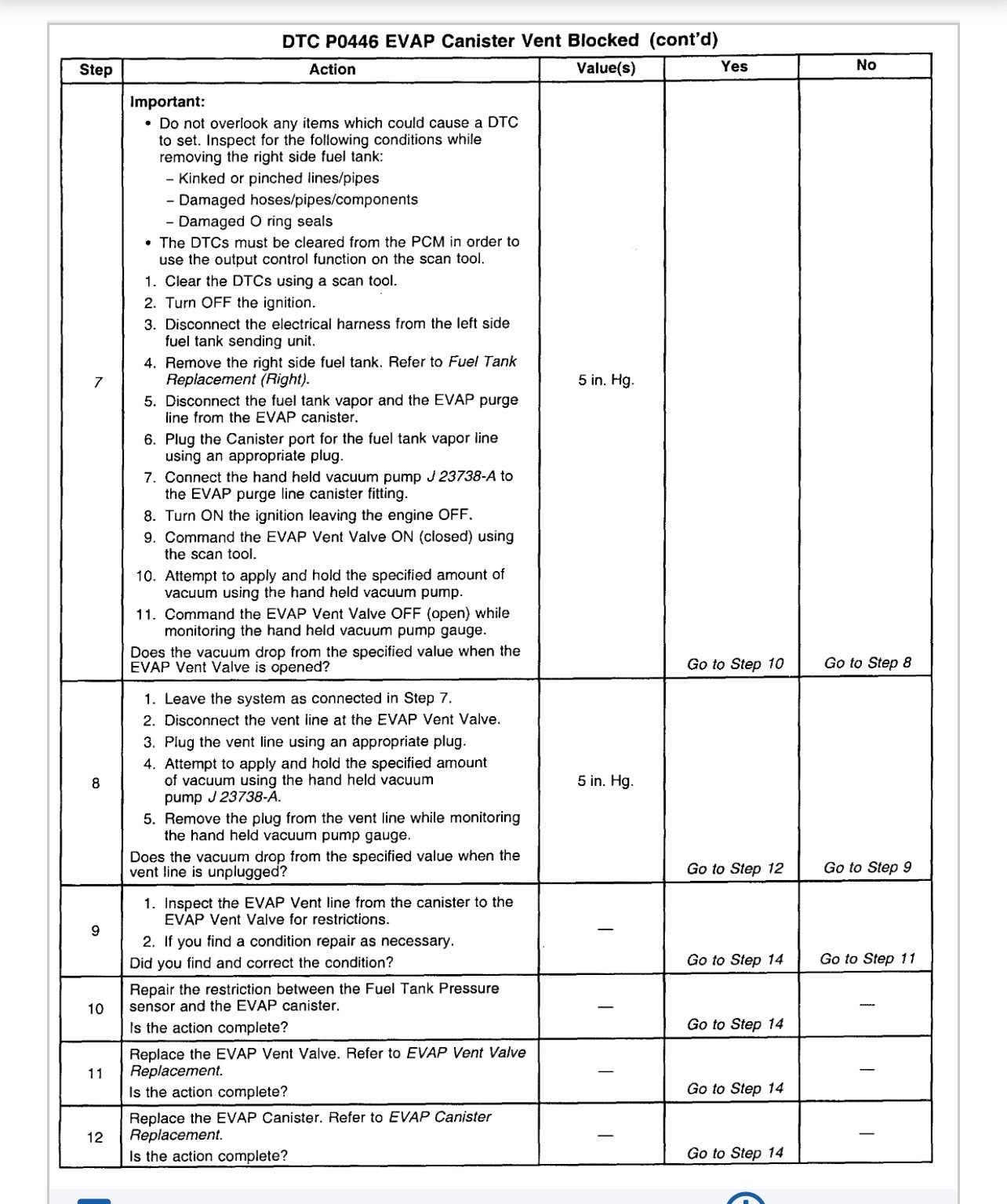

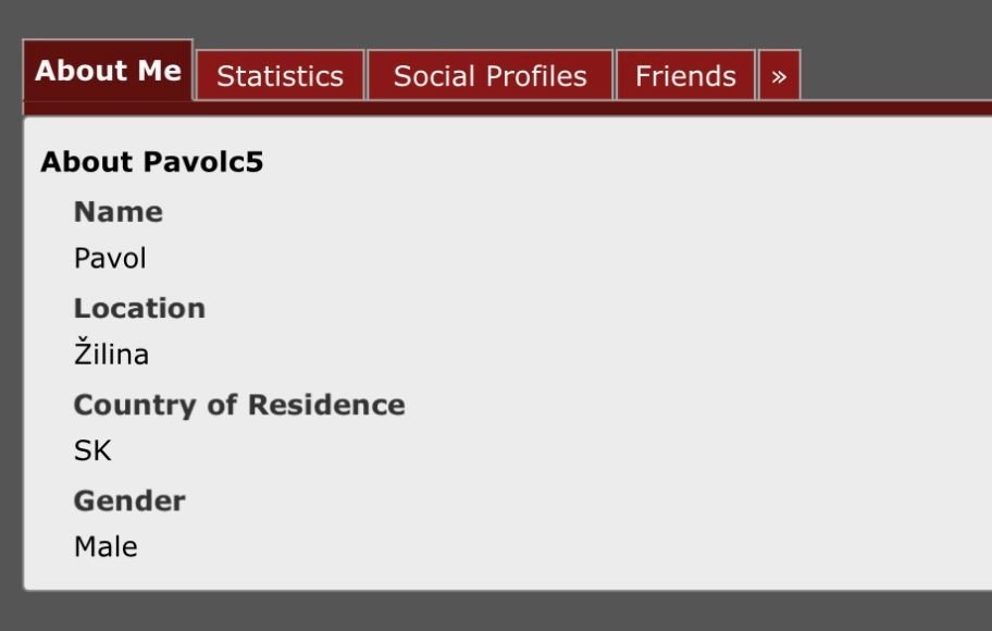

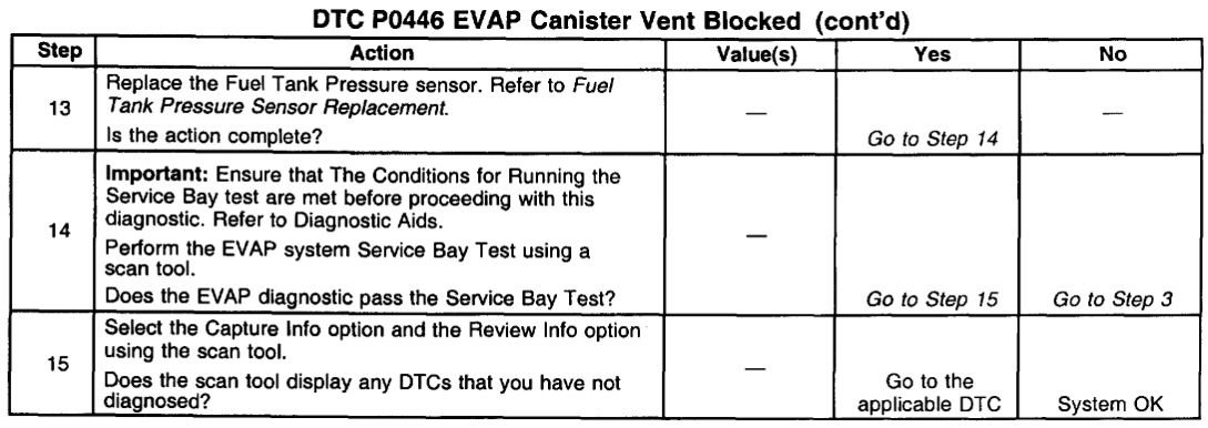

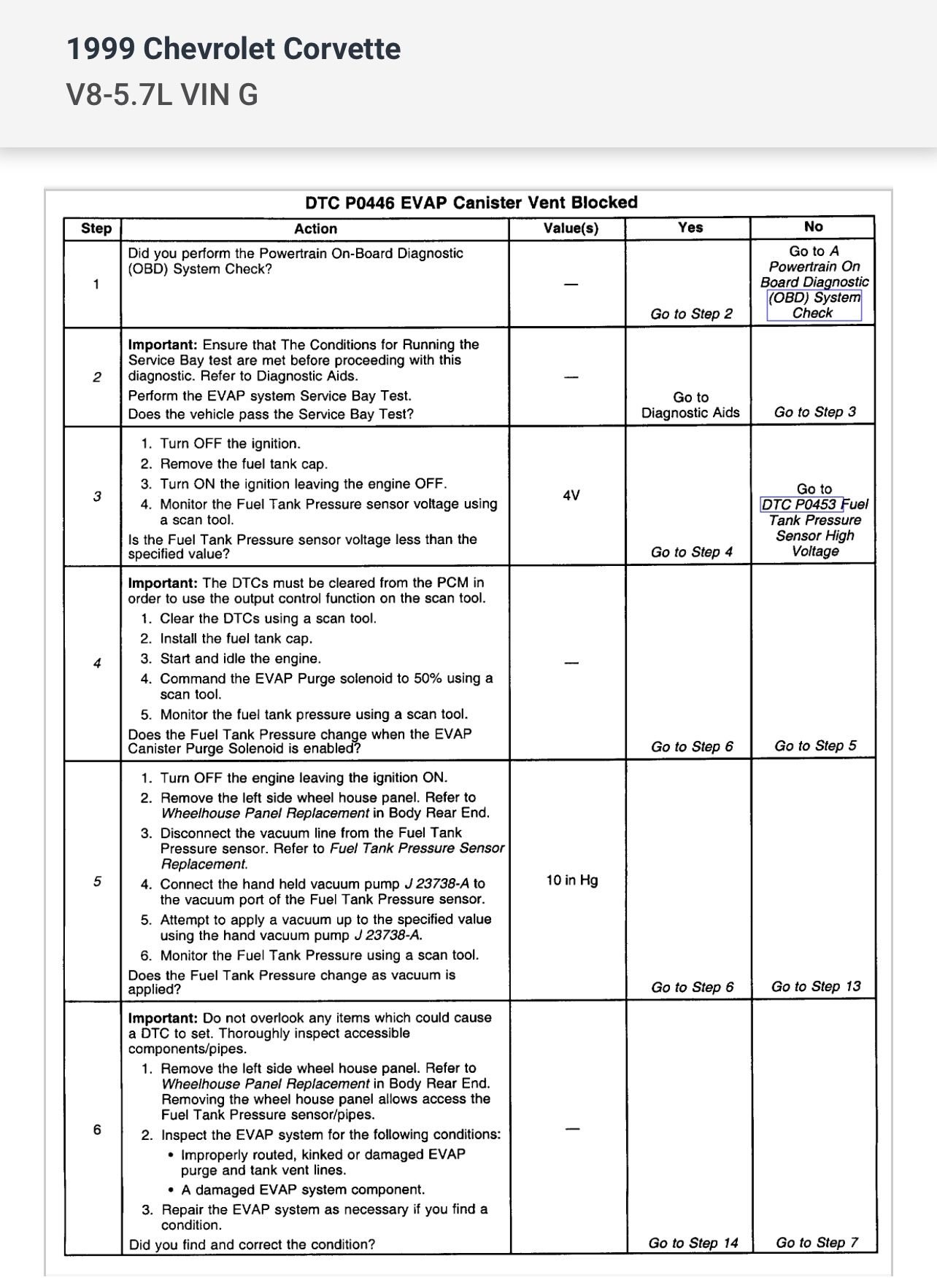

First step what is the model year of your car ??…not all C5’s are the same…I saw in a previous post you have a 1997…as a new member can you put this info as a minimum in your profile as shown below ??…I don’t even see a P0446 listed in Service Info until 1999…below is the troubleshooting chart for a 1999…don’t just shotgun parts until you diagnosed this per the chart.
