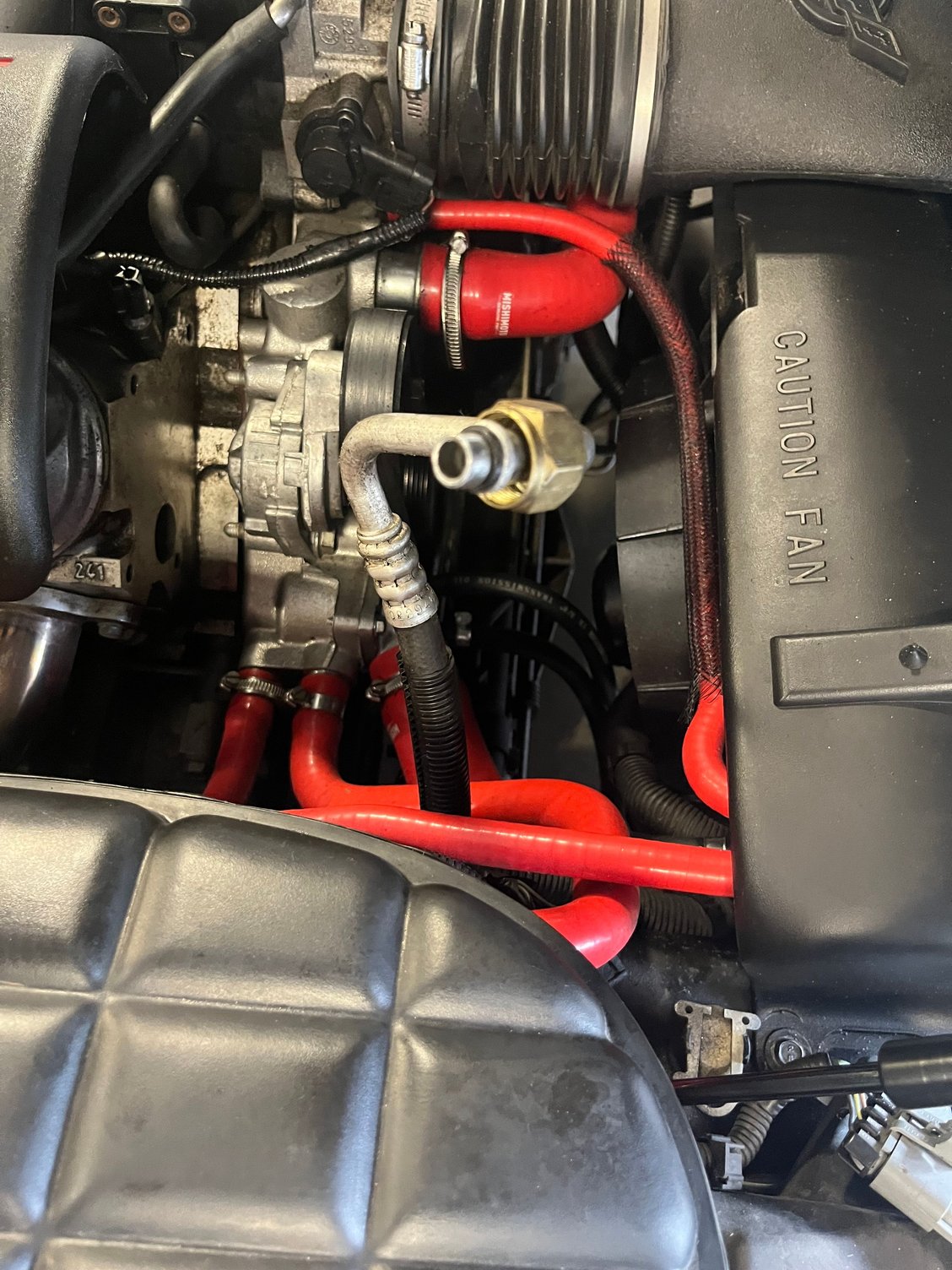

Good morning! Just bought my first Corvette and absolutely love it!
The previous owner removed some a/c lines and the condenser. Can someone please steer me in the right direction and tell me what lines to order and or part numbers?
Thanks- Brandon

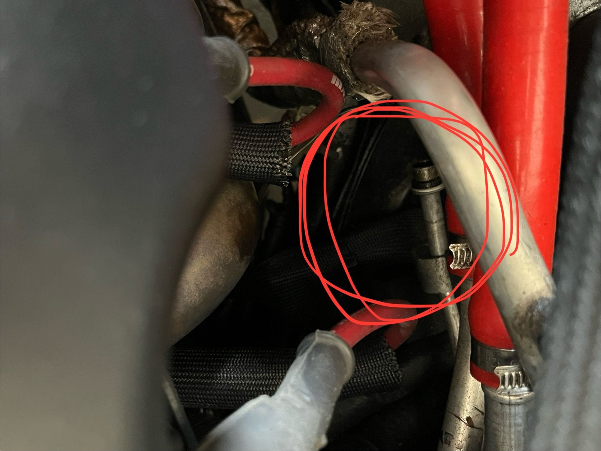

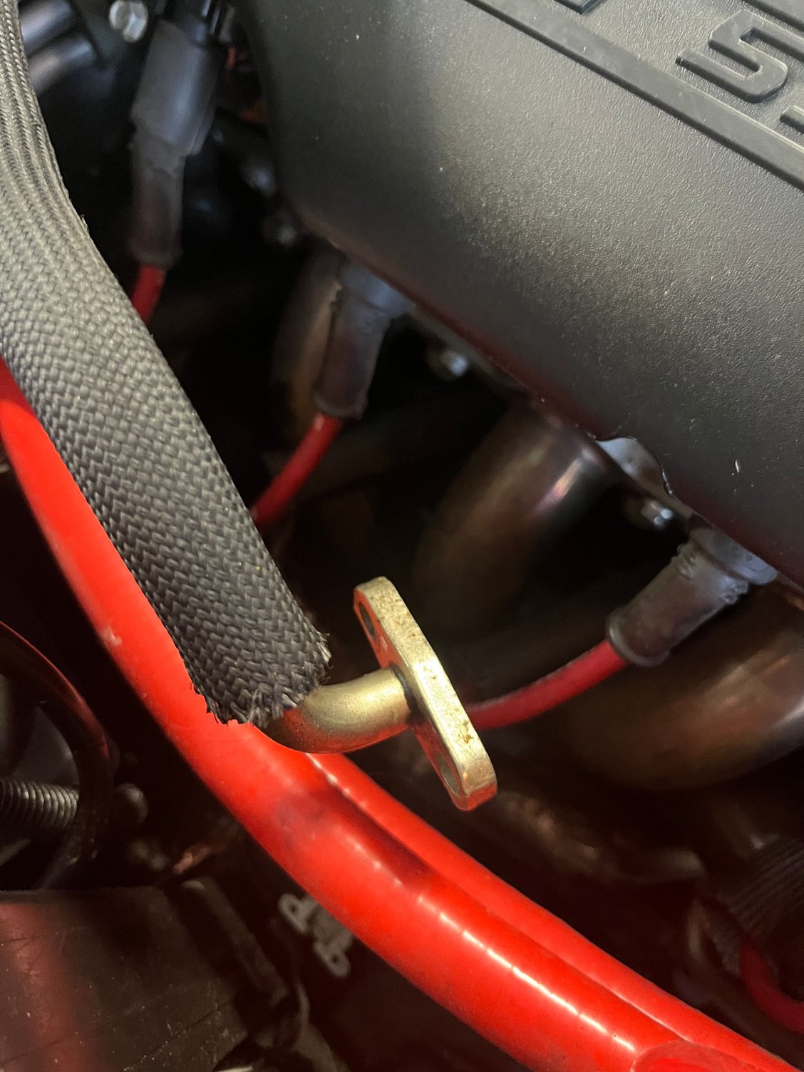

Okay, I think I figured it out. The only line I don’t know what it goes to is the middle picture. It runs behind the motor and have no idea what it is?!

Someone removed the AIR system when they installed the headers
....actually, it looks like they left at least some portion of the AIR system in place based on the second picture.

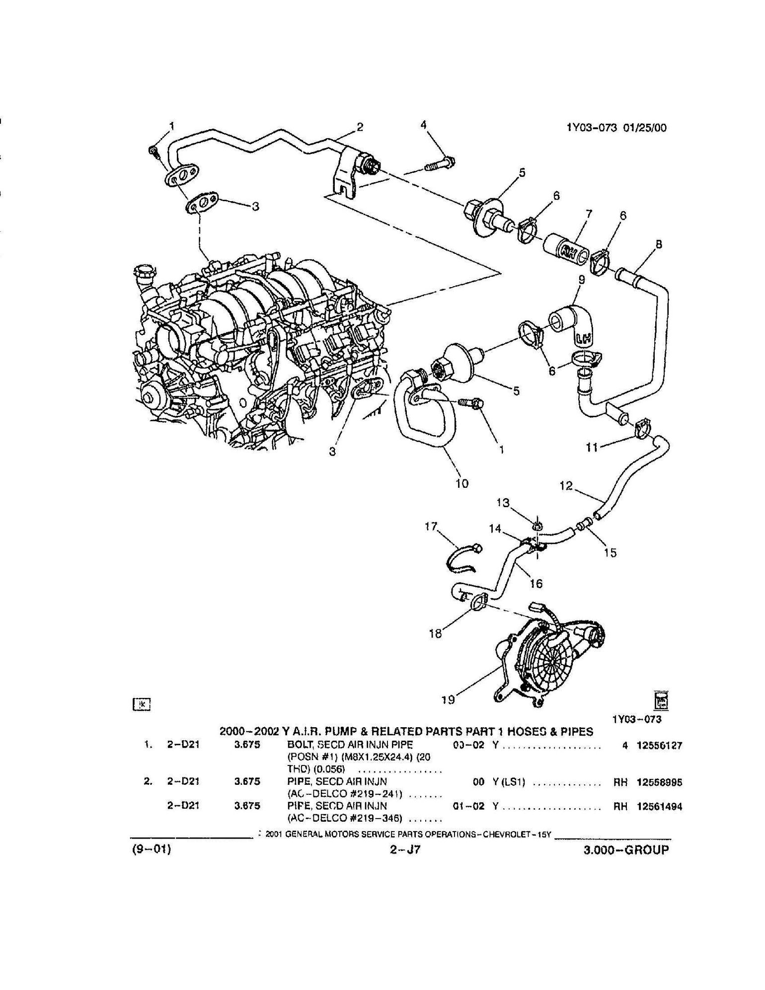

Update your profile with model/year info. All C5's are not the same.
I wish you luck, I think your in for a bit of a wild ride.
Here is basic components in the A.I.R. system.
Your kidding
Well....you said they removed it.....it's actually the opposite. They only removed the exhaust manifolds as far as we know from that pic...
It looks like they left #2 in that diagram
Yeah, I'm the stupid one......
