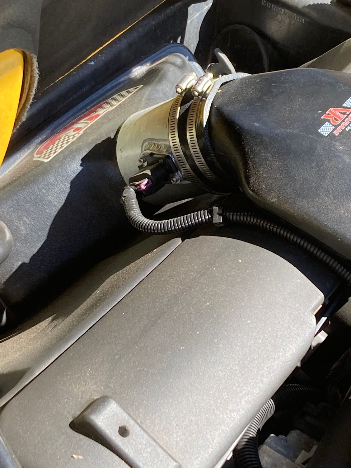

Both my C5 and my Sons S10 now have LS3 car style MAF’s.

Is the LS3 MAF 100mm? I have the Vararam setup, and I can't help but think the 85mm LS6 MAF is somewhat choking the bigger motor....

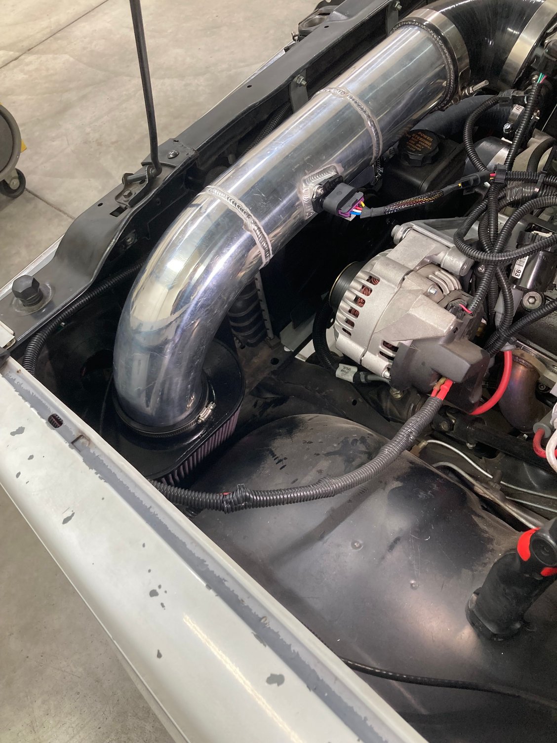

You could call it 100mm as in both my cases the MAF is mounted in a 4” tube.
This is the S10

Ron, I remember talking to you before about you having a 100mm MAF sensor, but couldn't make it fit due to the long length. I assume you still have it and never did get it installed, correct? IIRC, that was more like the stock C5 MAF, but 100mm vs 85mm?

I got it in last year. Along with GM LS3 injectors.
I just didn’t post anything.
I haven’t got it to the track yet to do WOT tuning.
It’s a little crude as the Vararam lid outlet is 3.6” vs the 3.9” id of the MAF tube. But I scored another Vararam lid that I’ll modify to fit the 4” tube. I just need to figure out how to do it.
