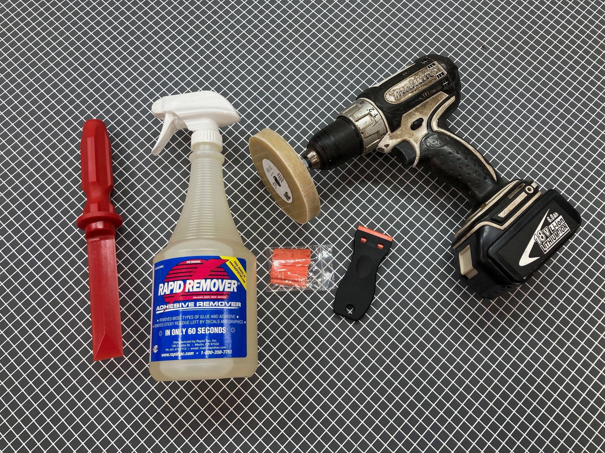

Rubber eraser wheel got mine off, and had some luck with heat & Gorilla tape, and some with Rapid Remover.
Plastic razors, Rapid-Remover & 3M wheel

how did te 3m wheel do around the defroster grid?

The 3M wheel did the best on the dot-matrix areas, slower than heat & tape but no damage at all. I did scratch the actual glass though when I tried scotchbrite, doh!
