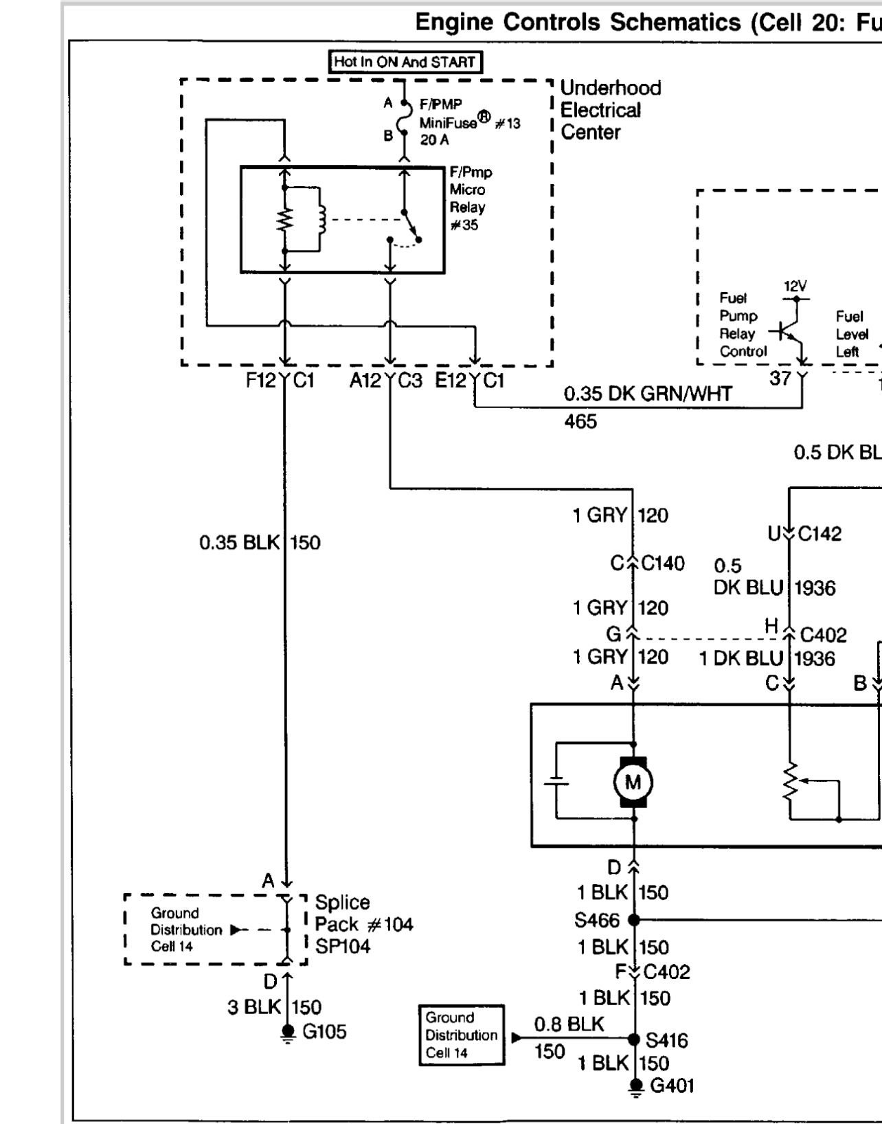

Here is the wiring diagram so if you have a 12 volt test light and know how to test both the load and control sides of that particular relay you can diagnose it easily…the load side of the horn relay is “hot at all times”…the other 2 are “hot in “run or start”…if the control side of the relay is “ground side switched” you hook the test light to B+ to check terminal 85…if it is “power side switched” you test terminal 86 by hooking the test light to ground…fuel pump is power side switched and horn and AC are “ground side switched”…if this confuses you diagnosing this testing will be impossible for you.
