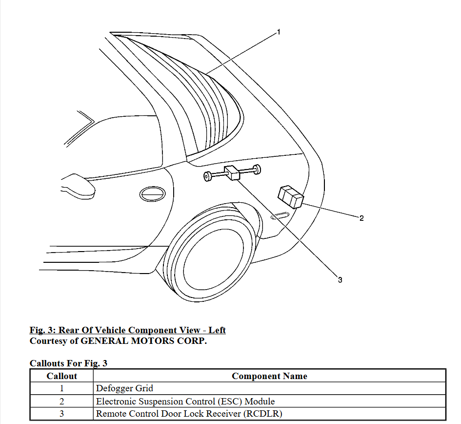

I want to replace the TPMS on my 2002 Z06 but i can not find it in the trunk behind the driver seat and befor i turn the car inside out i hope i find the awnser here.
Let me refrease my question looking for the TPMS VOB reciever and it is not in the trujnk behind the driver seat.
It was further then expected i found it.
Next to the gas intake.
Thank you for youre help.
Last edited by henk in veld; Oct 10, 2025 at 09:07 AM. Reason: It was helpful and the problem is fixed

GM thinks it is in the trunk behind the driver's seat.
Do you maybe have an export spec car? Maybe those were in a different spot?

Originally Posted by henk in veld
Thank you but this is a later model aperantly the 2002 Z06 model its placed some where else because nothing is there.
Take a picture of the area you are looking. The location did not change for 2002. Do you have working factory key FOBs?

The RFA module for the keyless entry and tire pressure monitors is located on the driver side in the trunk area just aft of the rear speaker. It is under a bump out in the close out trim.
For an 01 to 04 Z06 the TPMS feature can be enabled with a Tech2 since all 01+ cars used the same RFA module. For the Z06 this was turned off.
Now are you looking to add the TPMS sensors to the wheels? If so you just need to enable the feature in the RFA module and add the correct sensors to the car.
