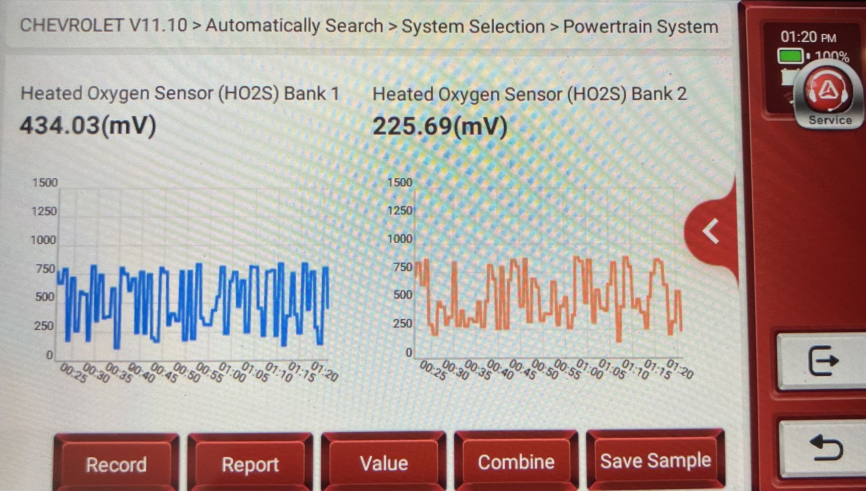

So I finally got a chance to fix my right bank exhaust leak, all looks tight now. Drove the car and got the same P1153 code, so I swapped sensors. Took the car on about a 20 mile drive and NO codes were showing. Then the next day, I drove it to work, about a 100 mile round trip. All the way in, no codes present. However, about 10 miles into the return trip, the P1153 code returned. Made a stop near my house and shut it off. After restarting, the code was present at first, but then cleared itself!? Just went out and looked at the DIC, and the PCM is currently showing no codes, not even a P1153H. I must admit I am a bit confused. Here is a screenshot of B1S1 and B2S1 while the car is running at idle..

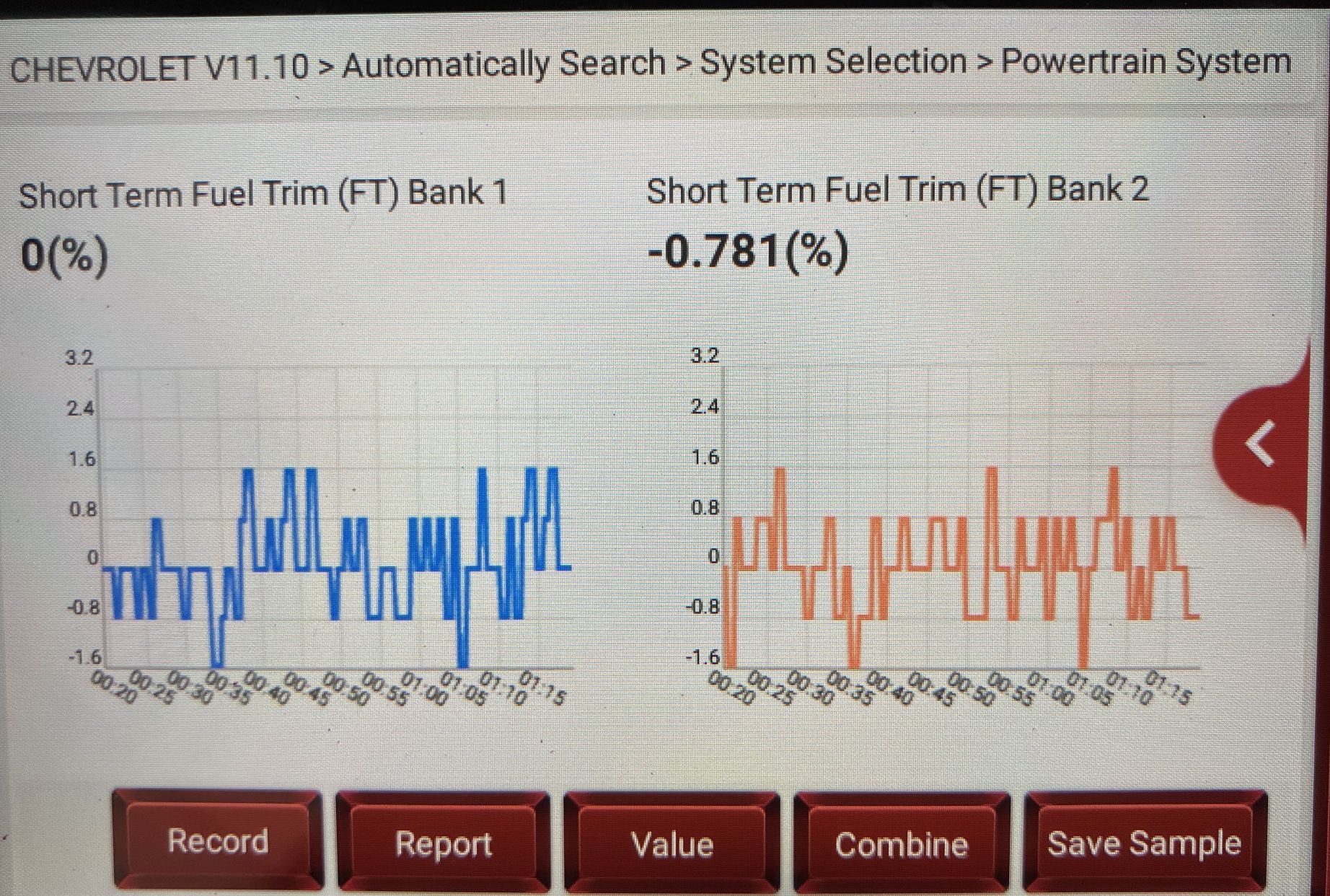

and here are the short term fuel trims,
Everything looks to be cycling properly to me. Am I missing something?

Upstreams cycle from 200-800mv’s…downstreams should be remain fairly steady between 600-800 mv’s.
