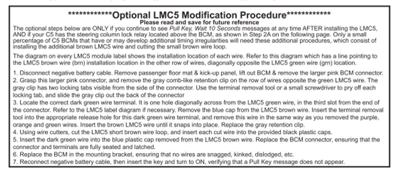

I had the same issue after my LMC 5 install. Brown wire mod did the trick.

Did you already perform this procedure per the instructions with the LMC5?
could you help.me out with steps to check/perform this? Had the install done by someone else.
Did you read post #15? That is from the instructions for your LMC5. Just use the instructions you have. I has pictures, so you just follow the steps.
Yep! I see it now, will give it a go. Image wasnt loading on mobile for some reason.
got the battery tested and they said it's good health and not borderline bad or anything. I was thinking of swapping out with optima red top regardless. Thoughts?
Just no need. This is not the battery causing your issue. Do the brown wire mod. You’ll thank me.
