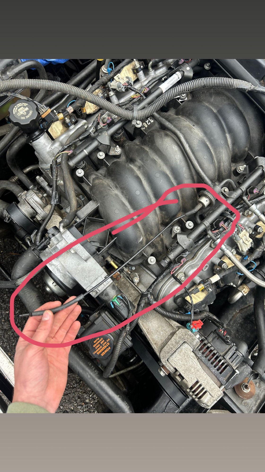

Im rebuilding a 98 corvette and cant figure out where this line goes to. Does anyone know? It seems to be something to do with fuel because its connected to the fuel rail

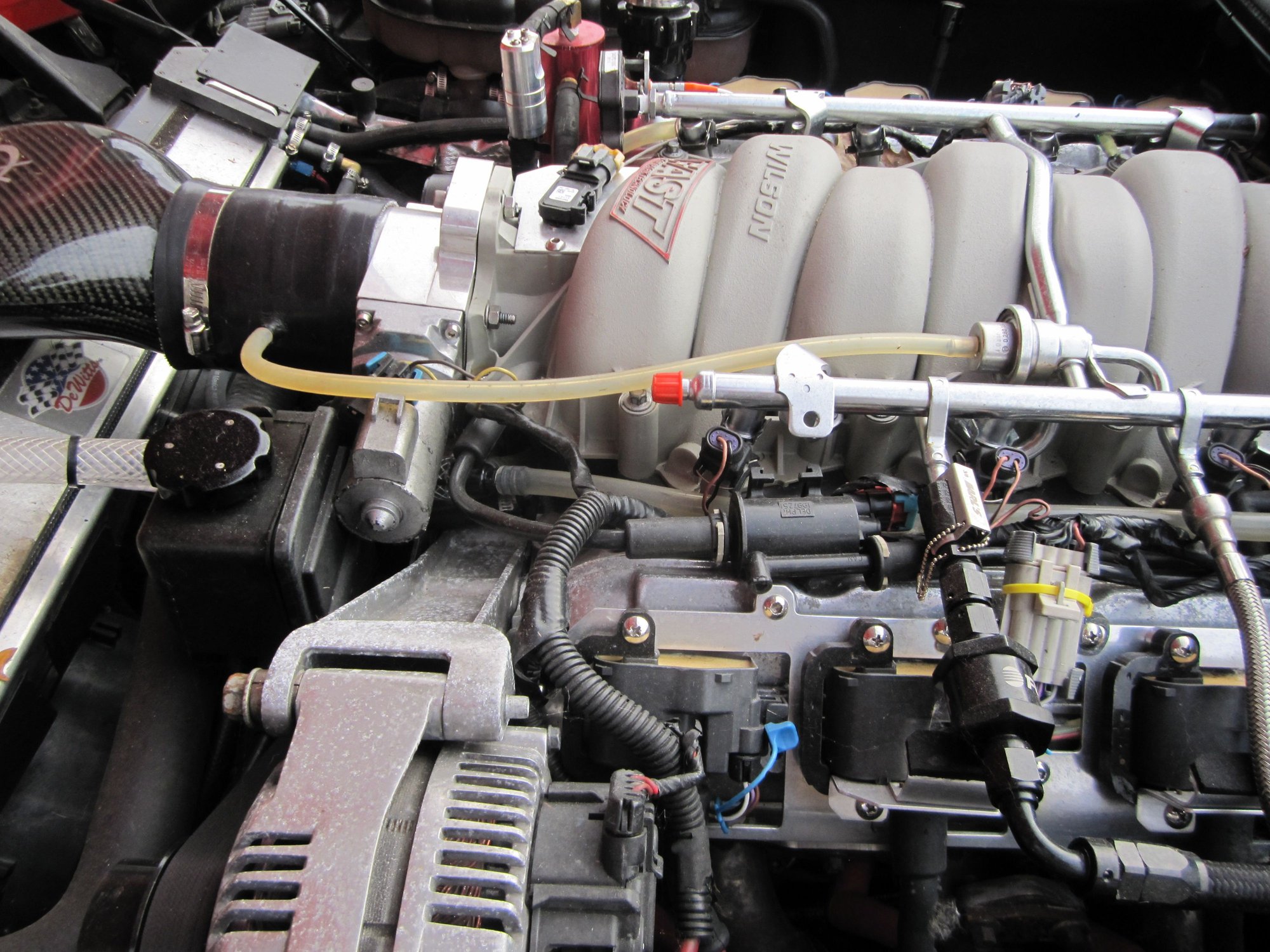

It goes to the air intake tube in front of the throttle body as seen here:
