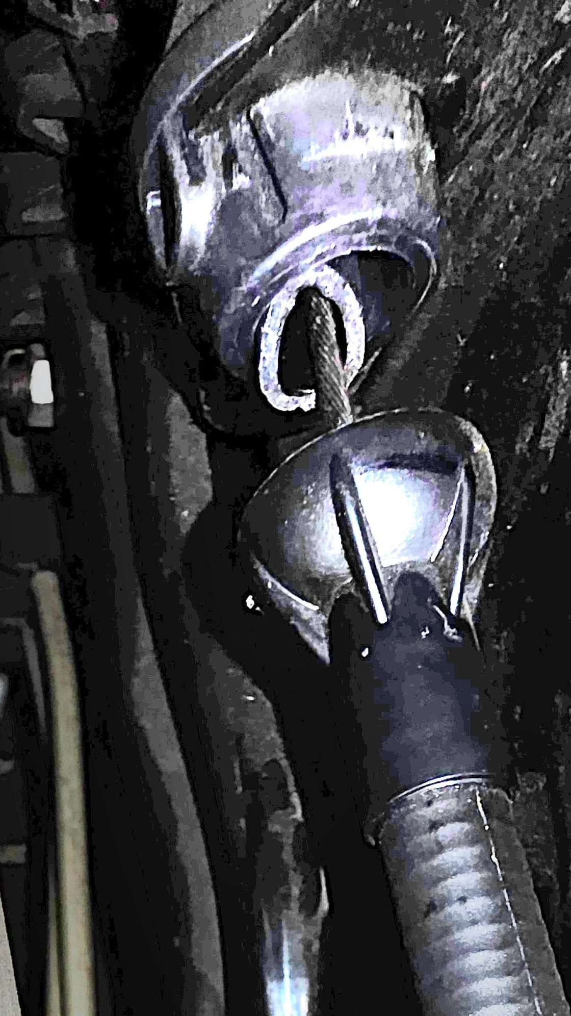

Hello all!
I had this issue just now. Battery checked, okay.
The shifter is moving easily. Looks like it's stuck in Drive gear, not allowing to start.
https://youtube.com/shorts/YLVAxZyD6cU?si=j0GgV9o0Ec3vlWKL
Could someone help me, please?

So, the little plastic clip on one end of the shifter cable or the other is broken, so the trans is not shifting to park or neutral, so it won't start.
And, if it did, you couldn't drive it anyway, since it will not shift into the proper gear.
Do a search on here for broken shifter cable.

yes, it's.
And I found only a way to replace the cable, lifting the vette and removing the muffler.. s&#t! Thank you anyway!

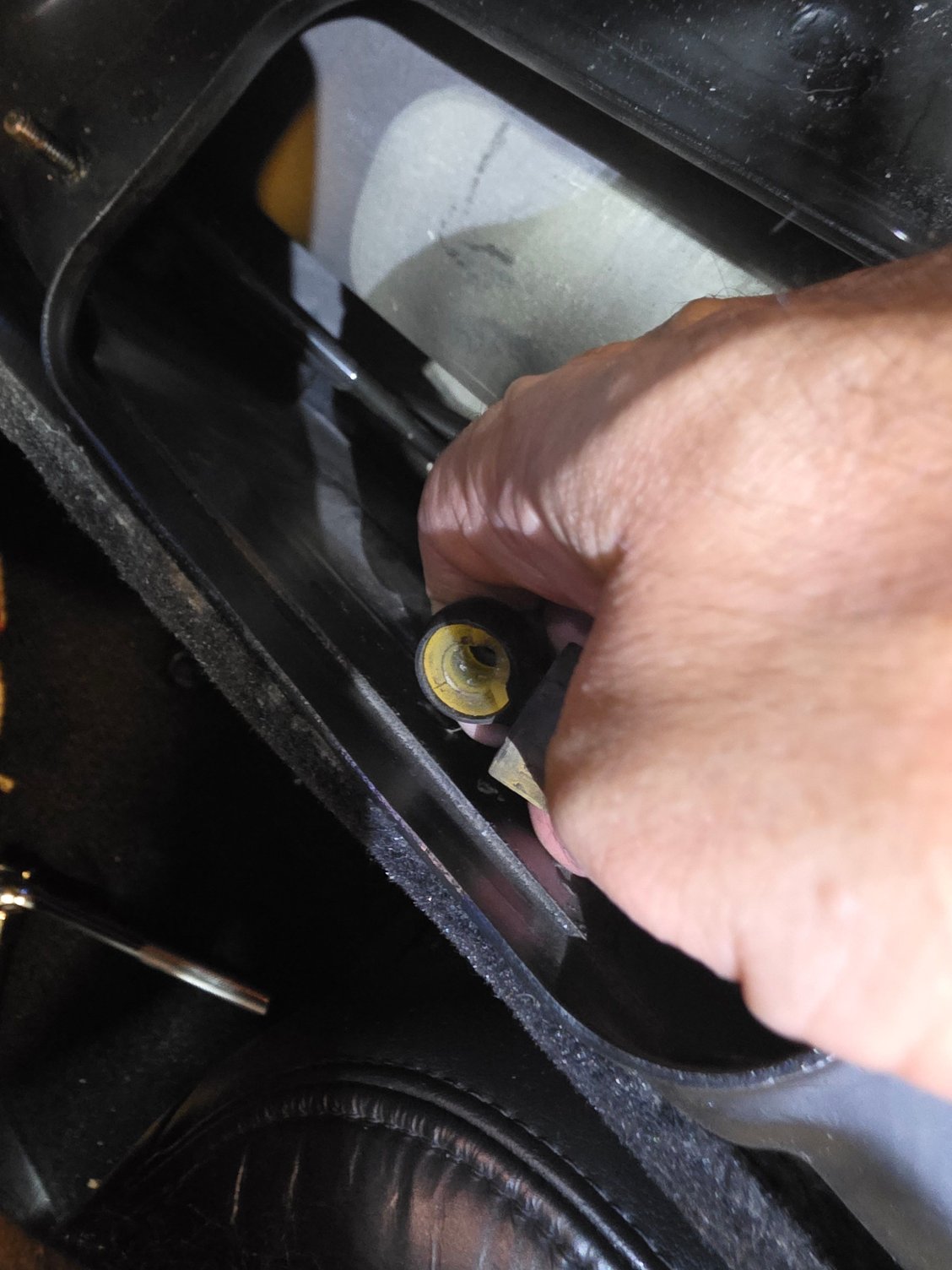

Great! I purchased the bushing on Amazon.
However, before seeing these articles, I didn't realise the cable was fragile. When I pulled it up to inspect the bushing conditions, I heard a "crack", indicating that some plastic had broken...
I had secured the end of the cable with a zip tie for now, but I don't know the extent of the damage caused when I broke the cable while pulling it up. I'll check when I open it to replace the bushing.
Thank you!
