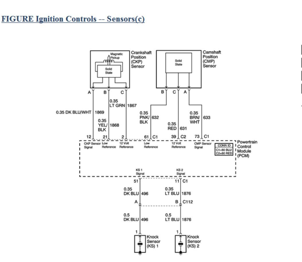

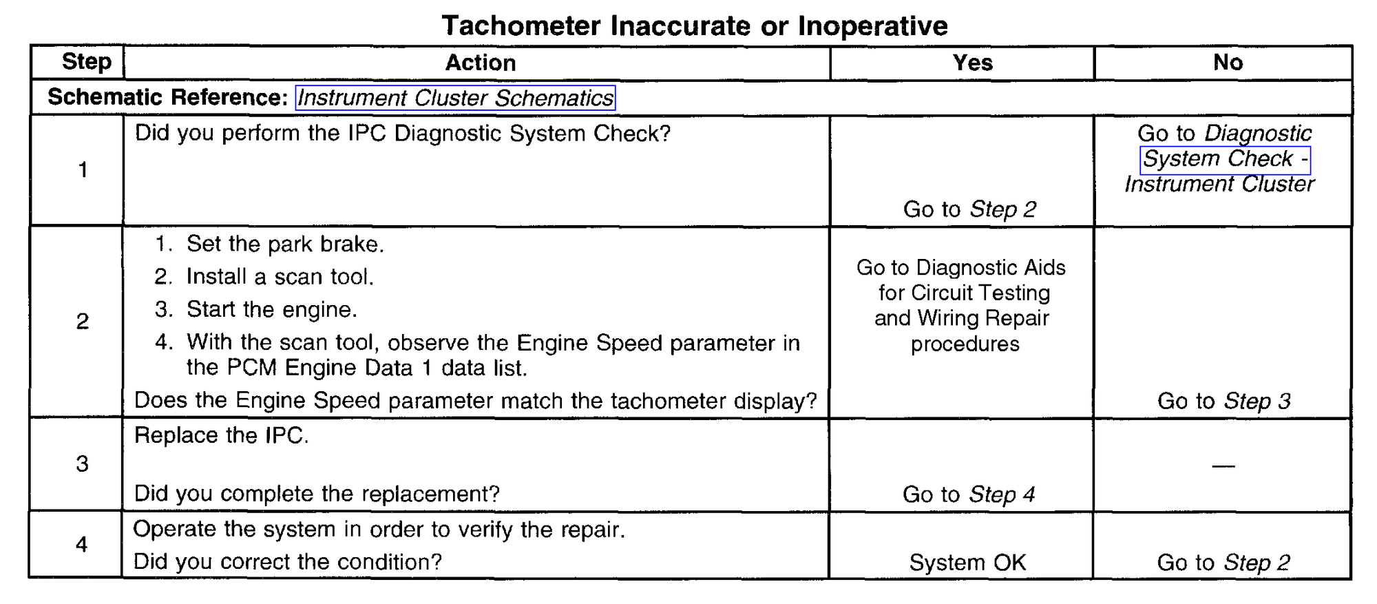

The PCM is connected directly to the Crank sensor , no fuses involved .
The sensor signals should be viewed with a diagnostic tool first and secondly the12v reference and ground connection and signal value should be measured on the PCM input
