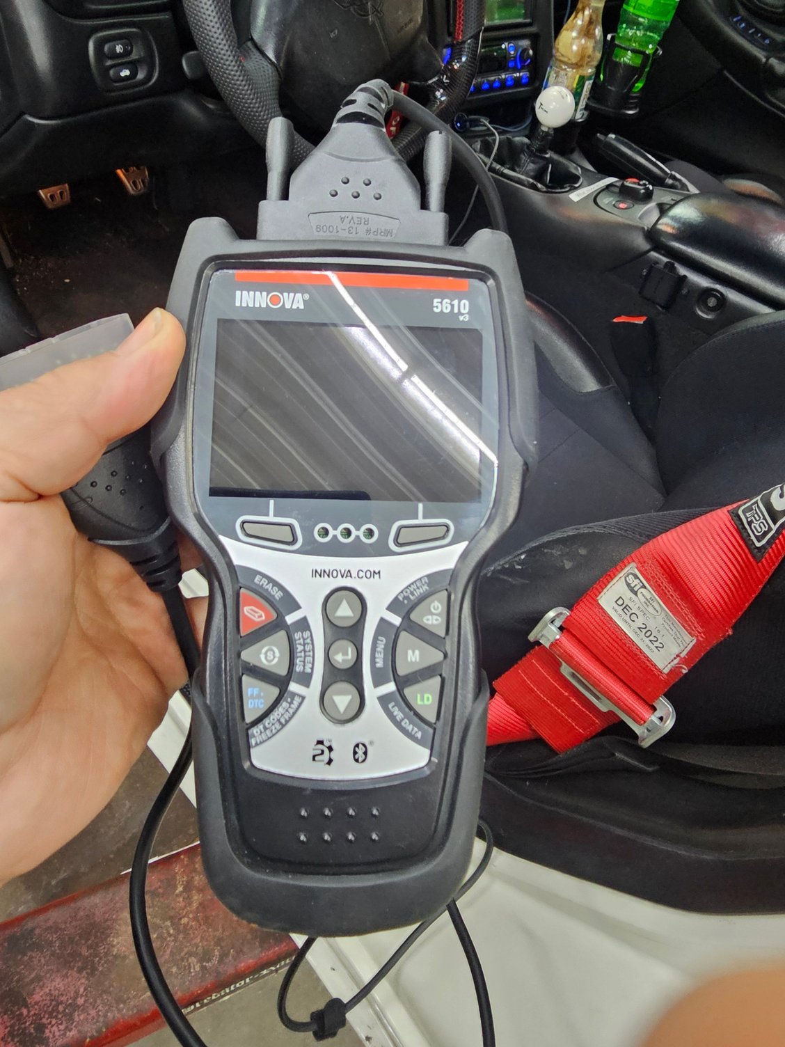

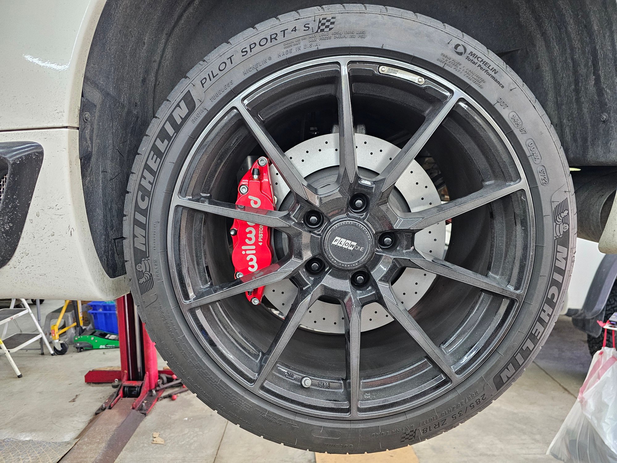

I have a Innova 5610v3 and tried all the ways mentioned above, still no luck. I even completed the updates on the Innova site. Did anyone find a solution? I've had this car since 2018 and never had this issue. I have Wilwood brakes all around, but that should not be the issue. My next try will be to power bleed.

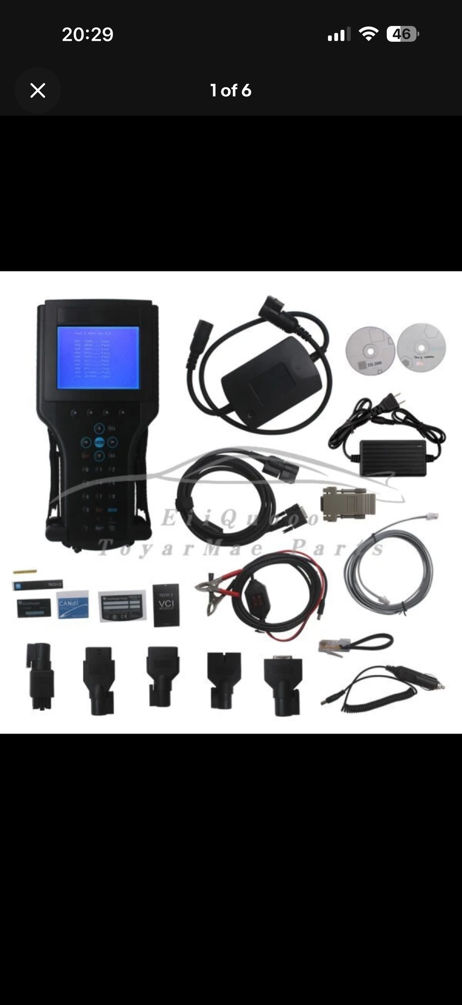

I have several scanners including TopDon, Autel, SnapOn but when doing troubleshooting with bidirectionale needs my favoritt tool is my Tech2 clone or my Tech2win (laptop)with VCX Nano .

Did you need to buy any other software, plugs, cables or anything else for your tech2 clone? I've seen them on Amazon and ebay.

The Tech2 is powered by the obd plug in the car.
I ordered a Tech2 with pmcia card contain gm software.
Put pcmcia card into the Tech2, connect the cable to Tech2 and the obd connector to other end of the cable.
Enter the Tech2 obd connector into car obd plug.
Igntion on and you can turn the Tech2 on and you are ready to play 😊

I live in Norway and bought the Tech2 "kit" with GM PCMCIA card from an ebay seller with good feedback score several years ago. Try to locate a seller with good feedback score is my best advice.

You can try Alibaba.com, last I checked the Tech 2 GM kit was about $250

I had a real Tech2 lined up to buy. Fortunately, I found an AUTEL that ended up working. Less than half the price of a TECH2 and does so much more.
This is the one that I know that works on my 2002. I hope this will help someone else in the future.
