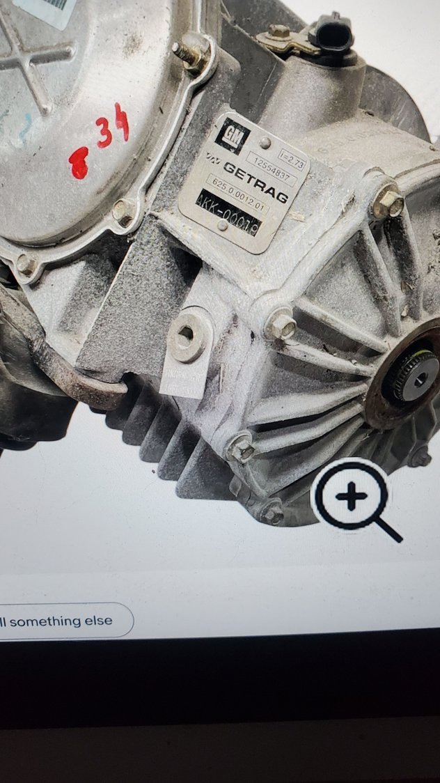

Are we talking about the square plug on the bottom of diff?? i've never had a seal washer. 25yrs its the same as the trans plug. Just wonder why there isn't a washer on the trans plug and that doenst leak. I though its the same kind of plug.
Is that tag the seal??? Mine don't have that tag. Just tape. Never had a leak. Strange.
That picture shows the fill plug, the tag is under the head of the plug, the seal behind that.
But, the drain plug on the bottom of the diff housing is identical to that fill plug on the back side of the diff housing, it is a straight threaded allen head plug and it uses the same seal.
It is not a pipe thread square head plug like might be found on some older car.
You can see both plugs in the diff fluid change video I did on my car.
