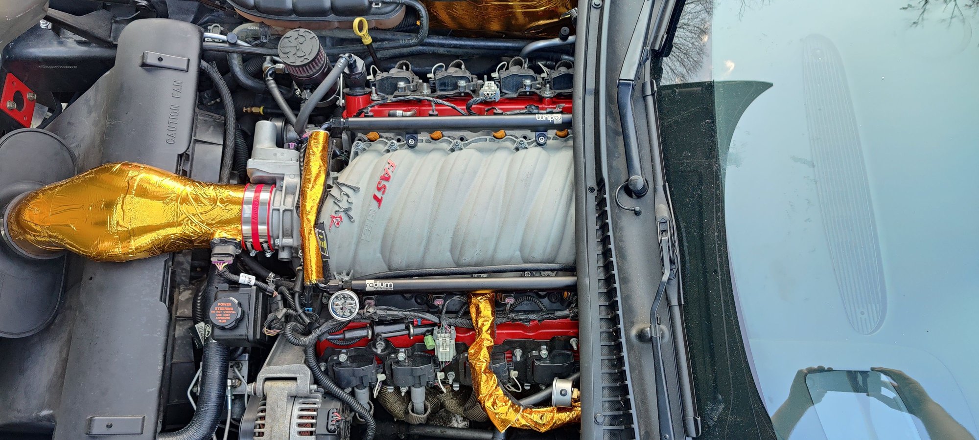

I have had zero issues with my gold blade for 3 seasons of track use. My tuner had to limit throttle opening but thats it. The REP comes from the over travel.

Nope. I ran my 90mm on a FAST 102. Bolt pattern is the same and there is enough meat to seal the gasket.

Second one here. I ran a gold on my last 99 coupe for many years on a Fast92 with a P1-Sc setup. Zero issues once tuned correctly. Several REPs before then. The tune fix came from Doug @ ECS who set the throttle signal limit to 97% or similar if memory serves. The blade itself still reaches 100% opening, but the signals sent/returned now function in the C5 ecu. The same info has been commented on the forum in the past. When I went back to NA on that car I recall copying the setting in EFI Live and it continued to work on otherwise factory original tune with a few tweaks like no torque limit between shifts, earlier fans to keep coolant temps down, etc.
