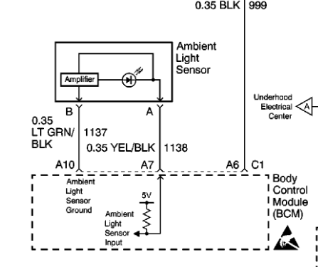

Originally Posted by Tac2011
....but now I'm pretty sure it's a for one of the gauges on my instrument cluster.
Nope. That is the ambient light sensor. It fits into the defroster grille.
I don't think so. That is over towards the passenger side and I know where that is and where that goes.... but thanks
Todd
Ok. I guess its just a coincidence that the wire colors are the same.

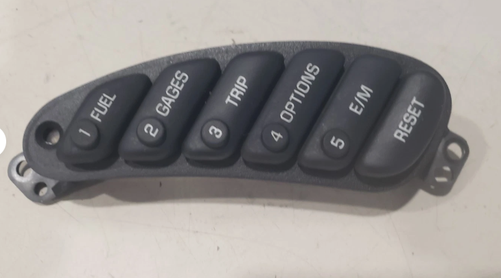

Isn't there also a light sensor that's located in the DIC buttons? Not saying this is it, but???

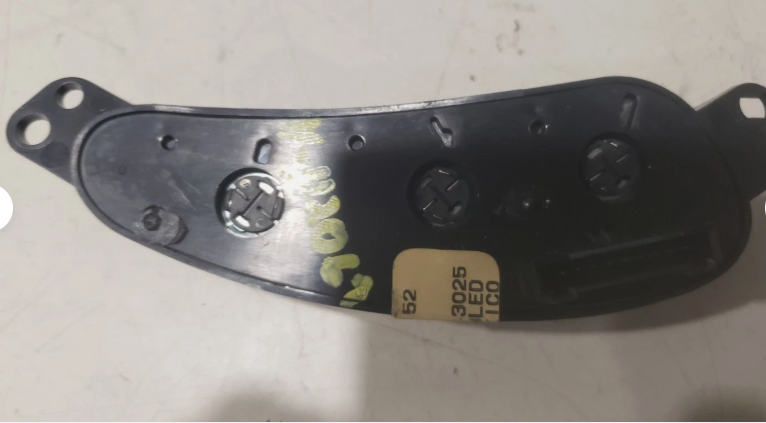

You're right, there is a light sensor at the top of the DIC buttons. So where does the sensor that he is holding plug into the DIC button assembly grinder11?
I don't know, which is why I posted question marks. Just trying to help, is all...
So are you able to conclude based on the pictures that the sensor for the DIC buttons is self contained, and DIC buttons assembly has no physical geometry to accept the sensor the OP is holding ?
I would think that would be correct. What I didn't think is that this would develop into a confessionary situation, when all I was doing was making a suggestion. Do I need an attorney here? Sorry, more question marks....

You ever have one of those days?? Months?? I've been hesitant to put the dash back on the C5 for fear of pieces that I just couldn't seem to find a home for. I took a closer look at the "grille" in the dash and then stumbled upon someone replacing a Sunload / Solar Sensor (Passenger side). As he was taking the grille off, he noticed a SECOND sensor.......What ??? I don't remember that sensor when I was taking apart my dash. Low and behold, there is a NOT SO OBVIOUS opening that looks almost EXACTLY like the Sunload / Solar Sensor (Passenger side) - but is a more simple connector on the driver side. I now understand this to be the Twilight Sentinel / Ambient Light Sensor.
